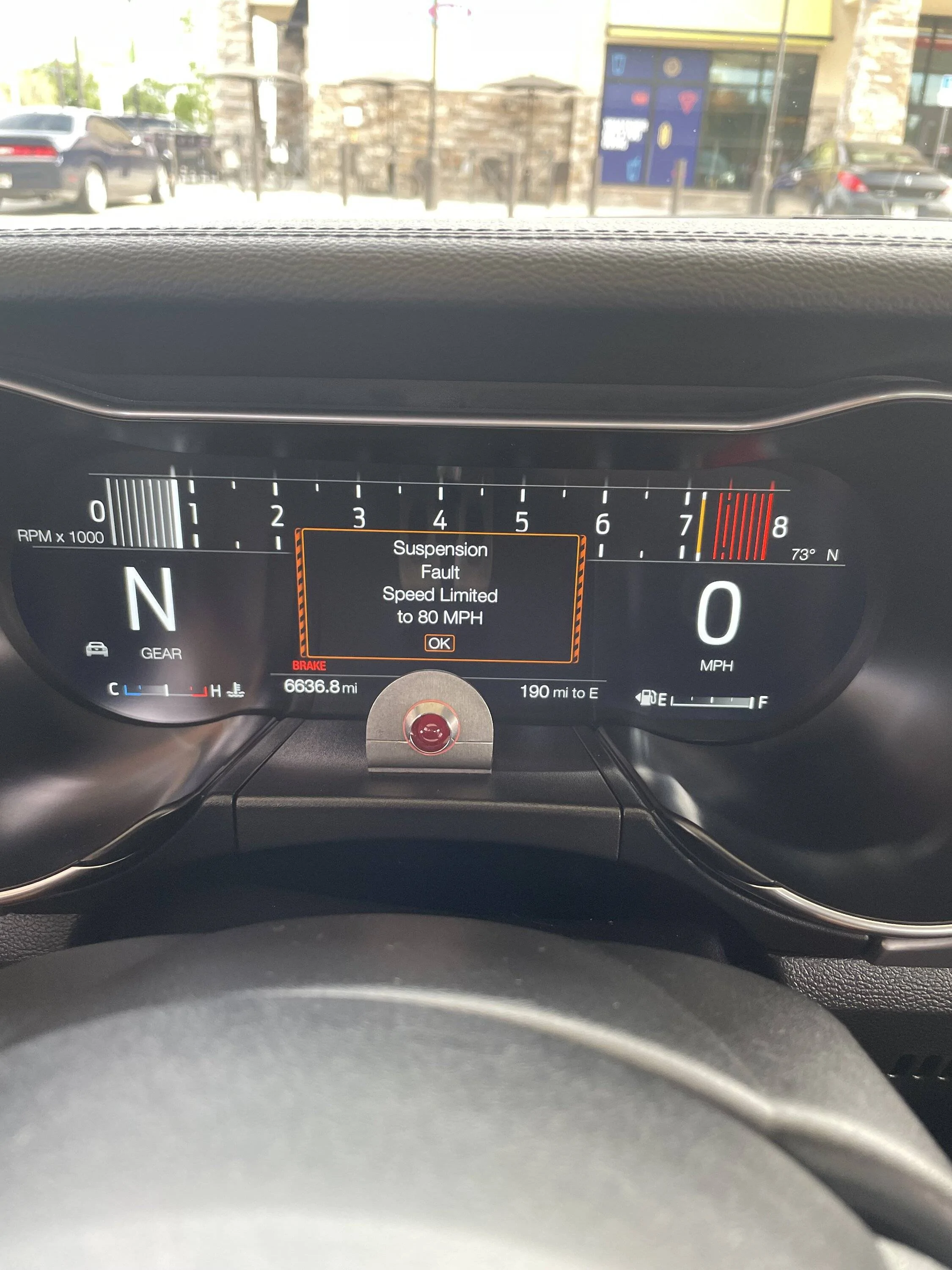

here’s what pops up on the dash if TC is not disabled.
K that's hilarious. Try turning off the magride with FORE ?
I don’t have Forscan, but if anyone here viewing this thread has one and it’s not too much trouble, could you please check and see if MR can be turned off?

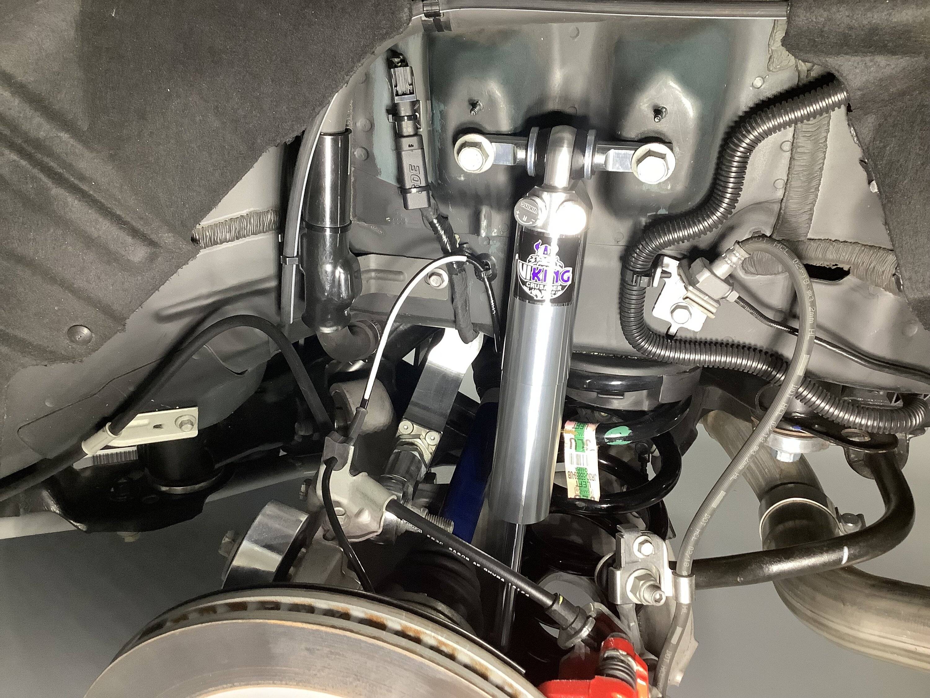

Something else to consider with MR is, if you ever upgrade half shafts to GForce, DSS or Ford Performance, the half shaft dust boots can make contact with the MR shock body and potentially rub through them.
In addition to the wide range of adjustability, clearance from aftermarket half shafts was also a huge selling point for me to go with inverted Vikings. There’s plenty of clearance now. Just wanted to make sure folks were aware of this, if you guys plan to upgrade half shafts.
Tried checking but now I apparently need an 'extended' licence :rolleyes:
