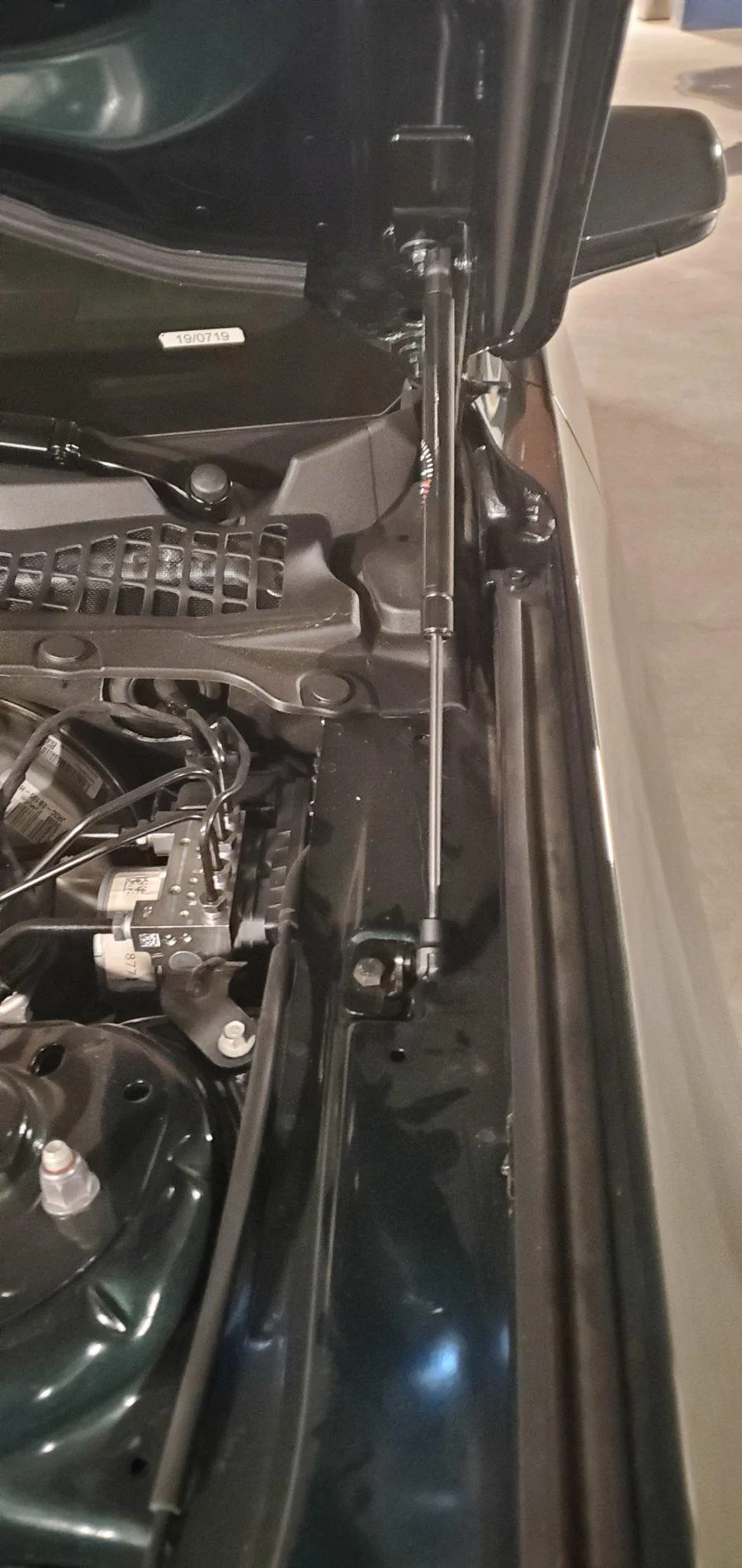

Installed Redline racing quick lift hood struts

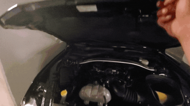

Are these better than the Ford ones? I can barely see your lifts in the GIF. They look stealth.

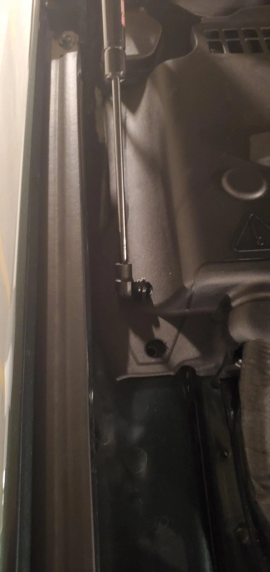

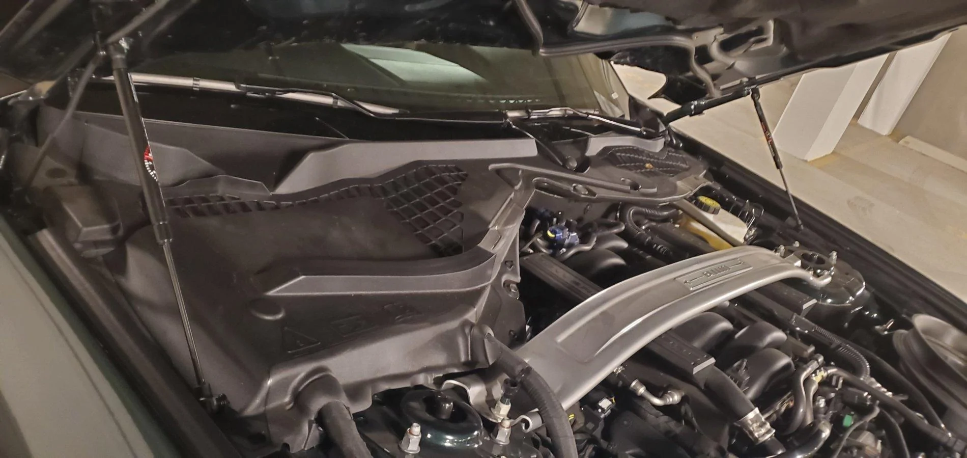

I have never used the Ford ones. But I'm gonna leave the stock hood support for a backup in case the strut ever gets shot. They're pretty stealth I was thinking about wrapping the body in some green. The hood feels so much lighter now. I'll post some better photos sometime over the weekend the car has been in the garage with not so good lighting.

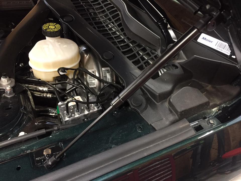

I installed the Steeda ones, and yes, I left my prop rod on. It rattles quite a bit, so going to look at something the stop that. I can get some 1/4 inch heavy density black foam with adhesive on one side. Just have to figure out where to attach it.

Do all of the hood struts (redline, steeda, ford, etc) operate the same as op's? In that it doesn't assist until the hood is half way up?

There is basically a "balance" point where the pressure and weight balance. Below that the hood weight is greater and above that the pressure is greater than the weight.

Installed Redline racing hood strut quick lift kit from https://www.americanmuscle.com/redline-tuning-hood-quicklift-plus-system-2018-gt-ecoboost.html
I thought it would aid in lifting the hood easier but you have to be at top 1/3rd before it slowly starts lifting. Still satisfied with the results and I'll be posting some daytime photos. For now, here's a gif
