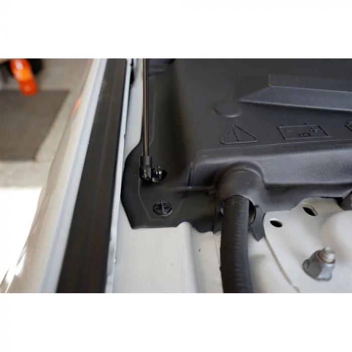

The “modification” consists of drilling one little hole. Hardly a big deal. :)

Yes. But is such a small, easy cutout of the battery COVER. Can’t even tell is there! The cover is easy and cheap to replace too if you want to go back to stock. But if you set on NO modifications then this might not be for you.

Huh? The gas struts are not an original option. They are aftermarket. The small hole in the battery cover is a simple fix for not having to need the old rod. If I remember correctly, Redline even supplies the drill bit.

If you want the hood struts, drilling a small hole in an ugly piece of plastic is a no brainer. I went even farther and just cut out a slit, so I can remove the battery cover whenever I want and not have to remove the hood strut. I had a lot of hood flutter before installing in my struts and now I have none; that is most likely because I tightened the bolts down nice and tight but it is what it is. I have the Redlines.
