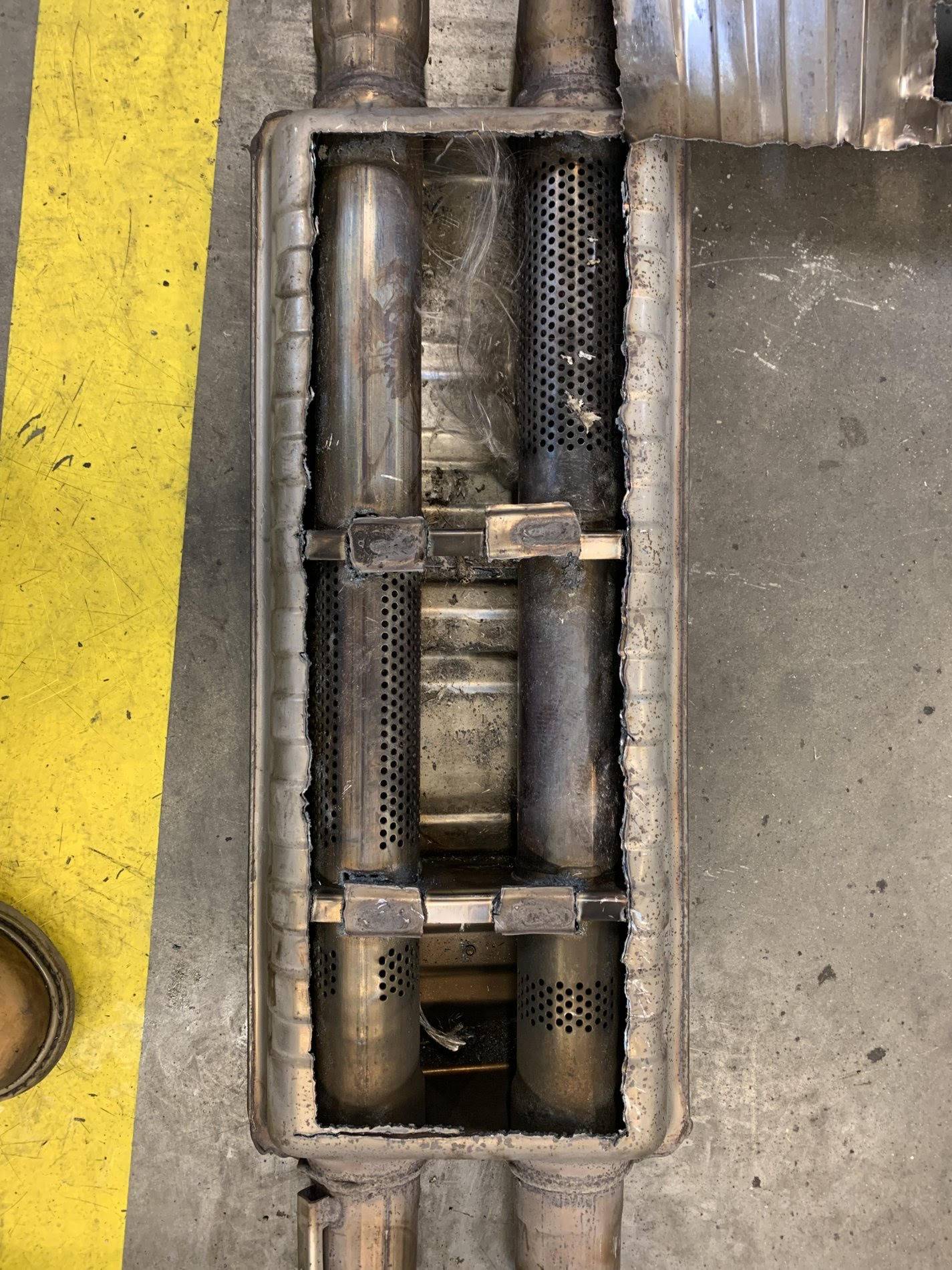

Just reading the comments and passing on my observations from reading the forum :
A) The resonator does have a crossover, but it’s somewhat restrictive when compared to a pipe - there is a passage for gas in the bottom compartment (referencing the photo further up this thread) i.e
B) Just because the standard resonator is straight through, it doesn’t mean that benefits can’t be found from swapping it out.
WD :like:
There are absolutely benefits from swapping it out due to the scavenging effects of a true point for gasses to merge and alternate exhaust pulses. However, are you suggesting that the initial chamber with perforated sections on both tubes is a crossover?

The structural mounting brackets in the picture are just that. Not crossovers. We cut open the one off my Mach 1.
I’m not suggesting they are a crossover for flow, but I think Ford engineered it do with the sound - maybe the perforations in the small compartment help sound crossover and council out some frequencies or harmonics etc.
I think everyone is well aware that Ford will cut cost wherever possible and adding the the extra partition rather than just equally spacing the two large compartments must be done for good reason - it just doesn’t make sense otherwise.
Look at how the perforations are spaced. One small compartment that’s shared and then the perforations divorce with one bank in each compartment.
WD :like:
The two large passages communicate through the structure brace, they aren't sealed.
