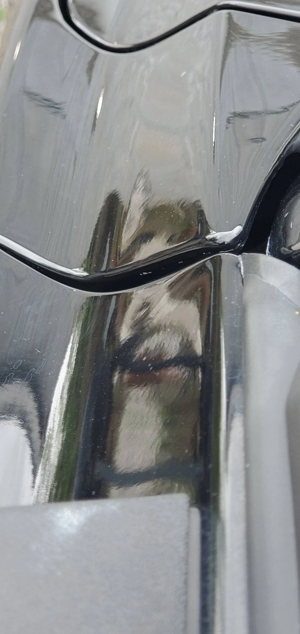

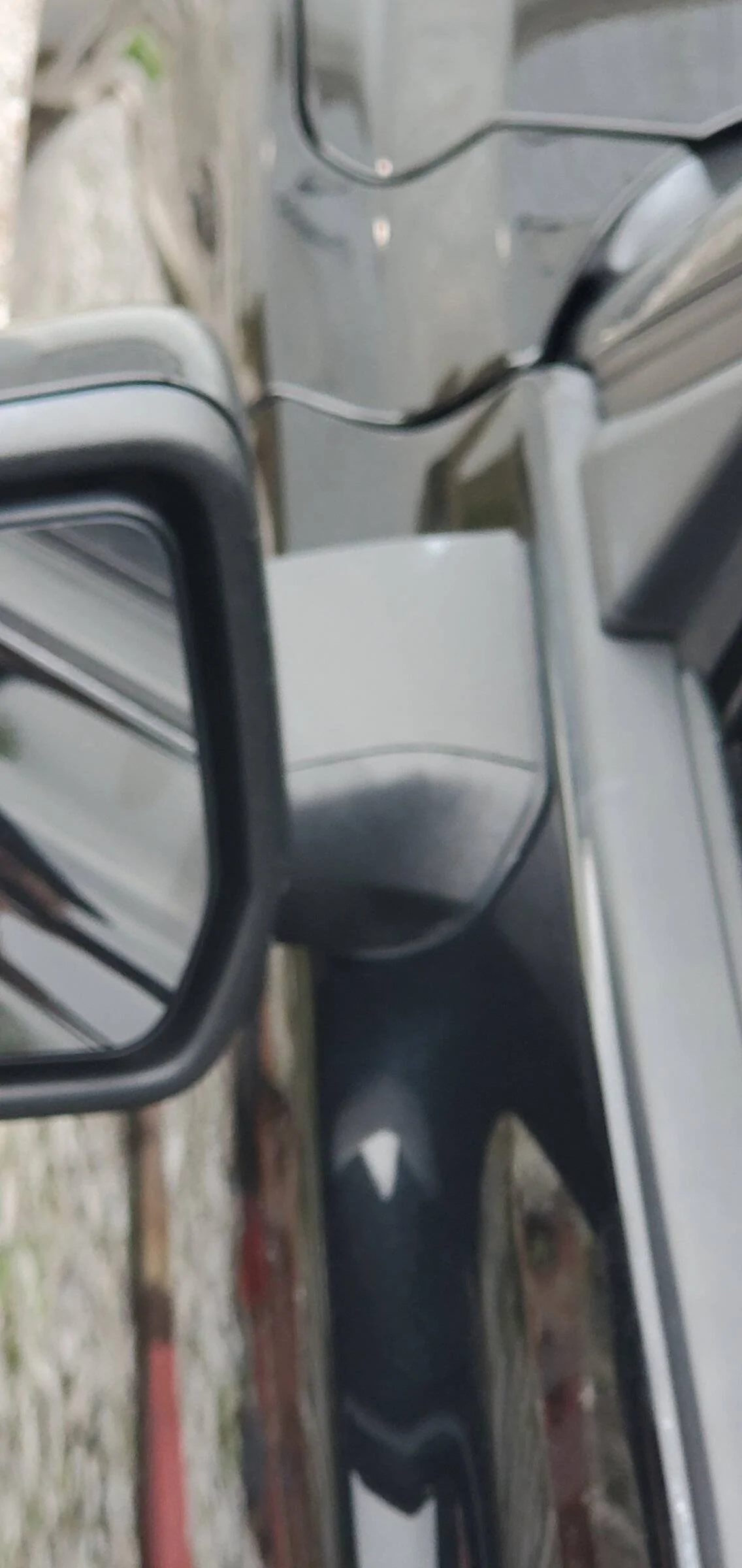

I looked over the car carefully today. I'm finding miss aligned panels on the drivers side that were not miss aligned before the hit. The trunk looks pushed over toward the drivers side. Same with the hood. The alignment of the line that holds the mirror is not even with the hood. The hood seam for where it aligns with the door is tweaked.
I never noticed this before and I did do paint correction myself. Had these lines been this far off I would have noticed.
I might put up some pics. Not sure they will show what I'm talking about.

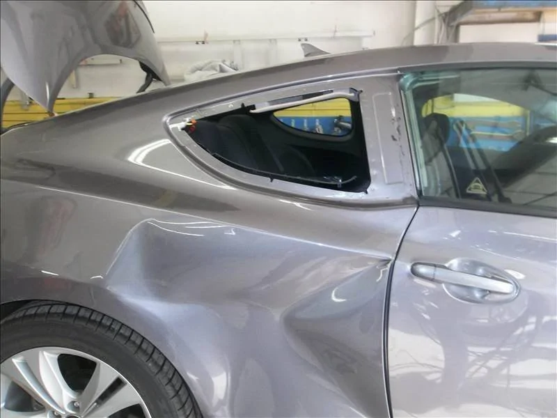

When I had my prior 2011 Genesis coupe, I also had a deer strike... Coming down a rural road around midnight cruising at 55-60, all woods, all of the sudden, a huge "crash" into the passenger side of the car... Startled me to say the least. I pull over, there's no street lights, it's pitch black in the area, can't see anything. I light up my iPhone's flashlight mode and the entire passenger side 1/4 panel right behind the passenger door was caved in, door sheet metal was all rippled and front fender was dented.
Damn deer came straight out of the side of woods full force, hit and rolled down the side of the car - and disappeared.
If I remember correctly, the damage (in 2015) was in excess of $7k. Entire 1/4 panel and the door skin had to be replaced. Rear interior panel on that same side had to be replaced because the force of the hit cracked the panel. Front fender dent was popped out. Entire side of the car was resprayed and the body shop that did the work was excellent - couldn't even tell anything happened afterwards..
This is a pic of it when shop was preparing it for tear down (they removed the rear side glass and main rear window). The central impact of the 1/4 panel caved in a good 4". Hard to see, but door skin is also buckled outward and was dented/rippled in numerous spots.

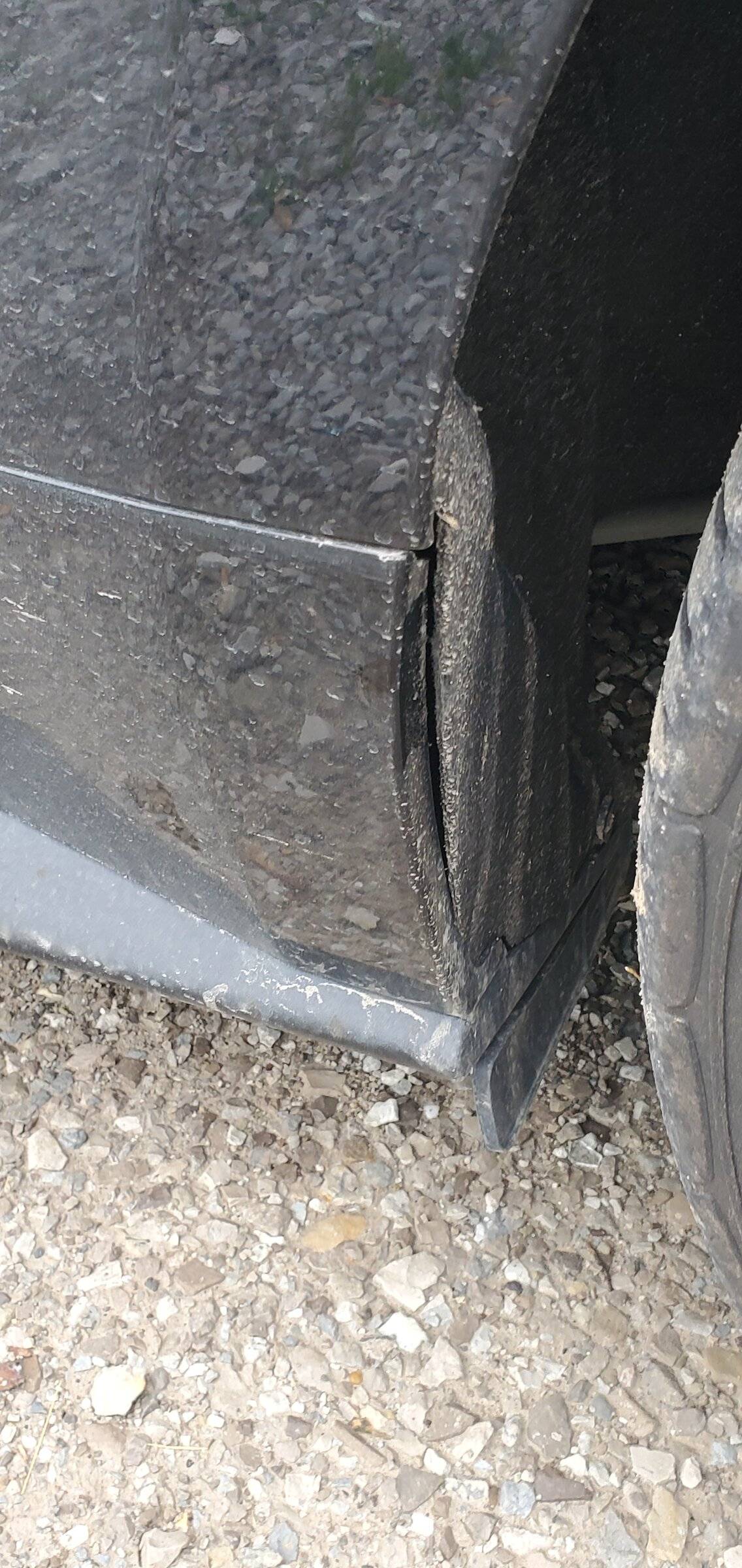

I'm noticing things, the driver side rear tire is about 2 inches outside or tracks wider than the front. Noticed it when I drove through a puddle of water. The passenger side tracks in the same tire track as the front tire. I'm thinking the IRS got shoved over. It dos have alignment pins so if it moved the unit body moved also.
I hope to put it on an alignment rack tomorrow
