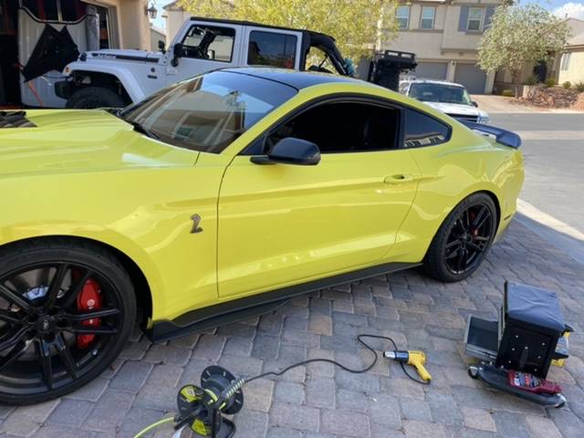

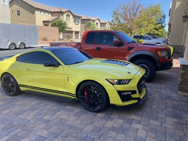

I used a heat gun "low" setting and a plastic putty knife to remove my side stripes. Just have some patience and go slow, there was no adhesive left on the paint and any reminisce of the side stripes was easily removed with a cleaner wax.
The stripes were on the car is Nevada heat for over a year and today you could not tell the car ever had stripes.
Before
During
After
