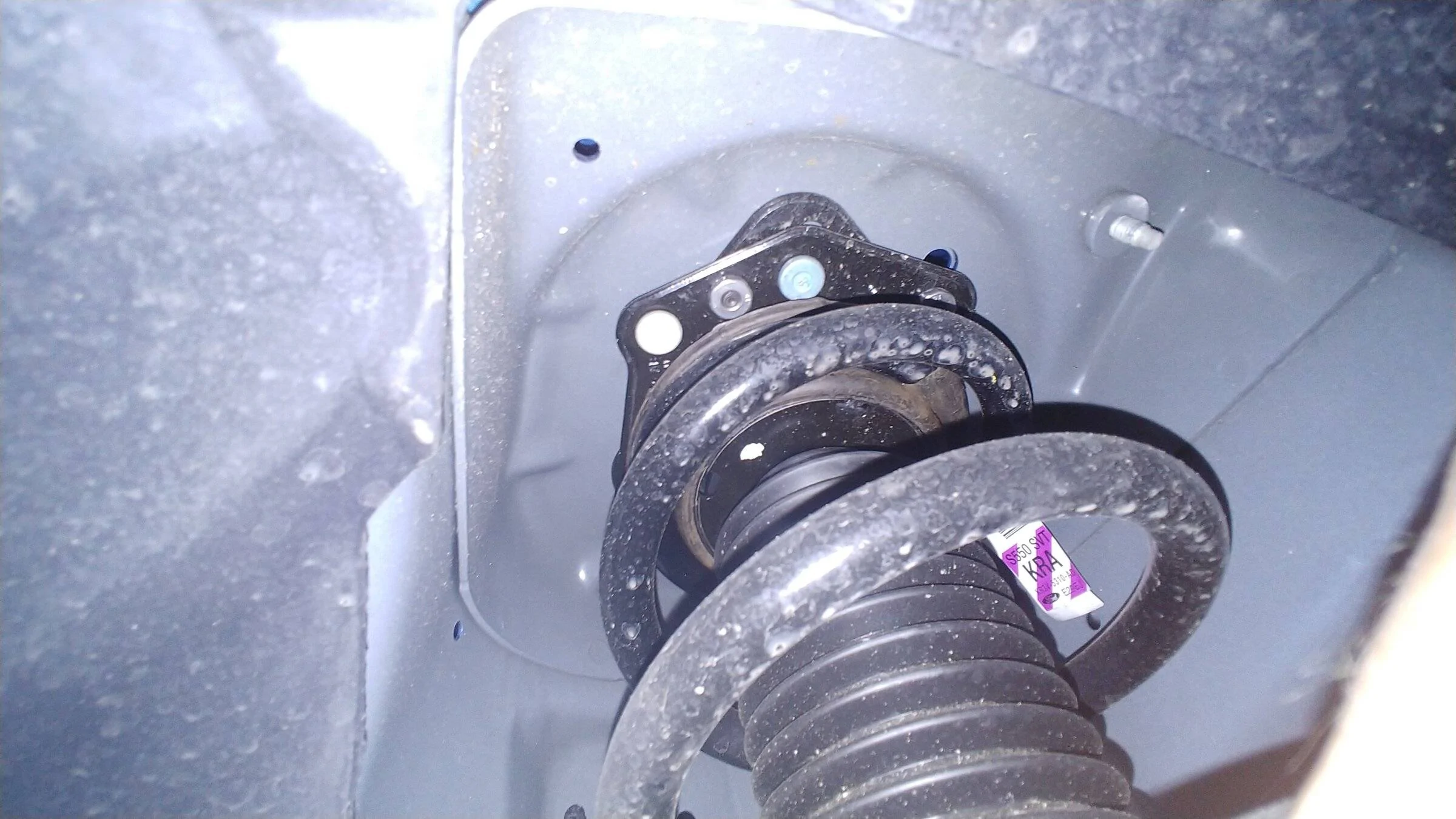

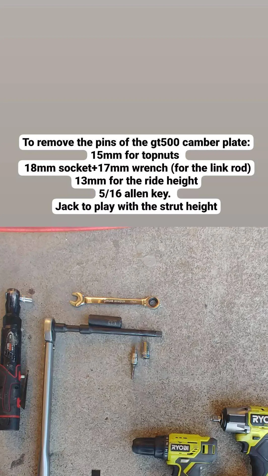

Do we guys have any new guidance about those?
Are they just regular slide camber plates or do you need to remove a pin to move them?
