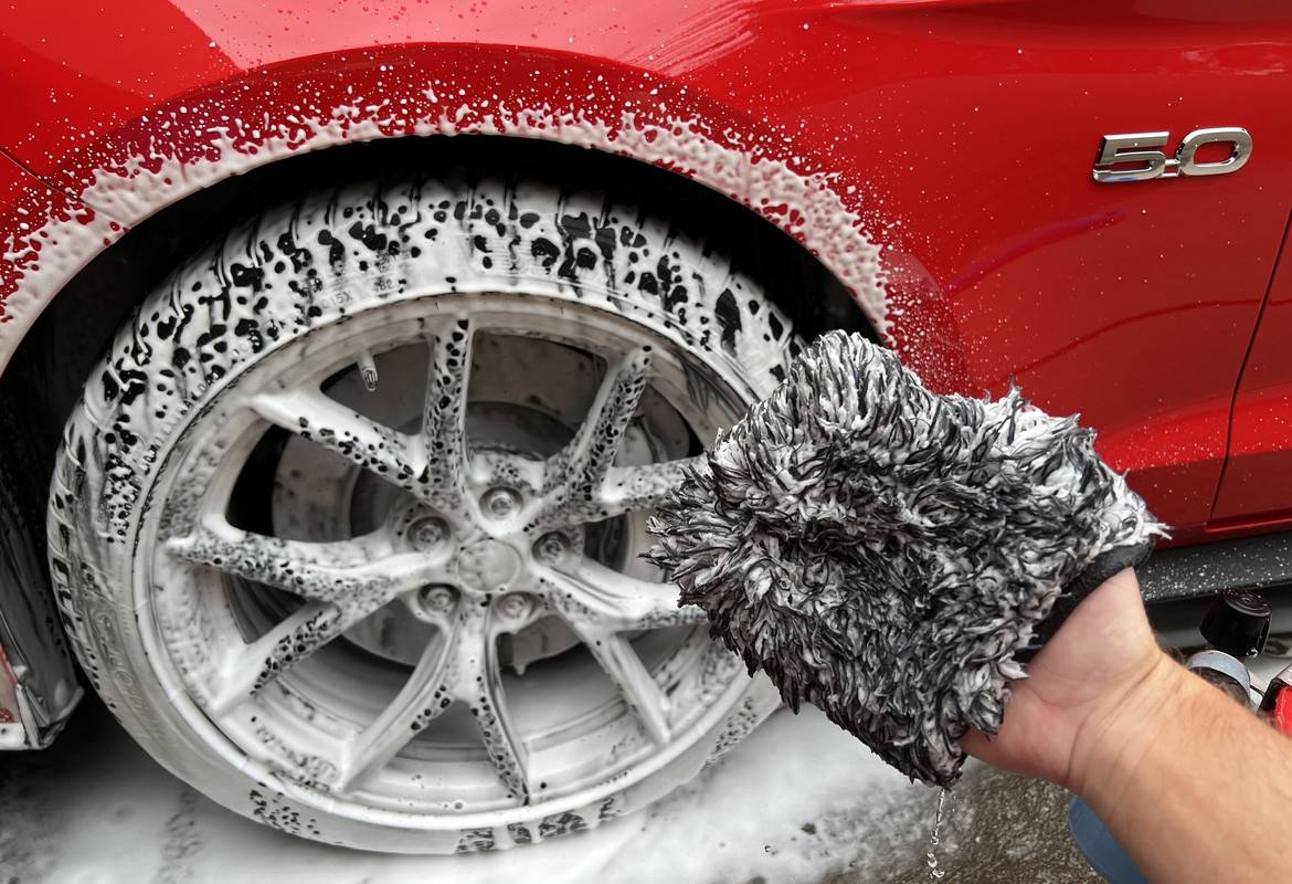

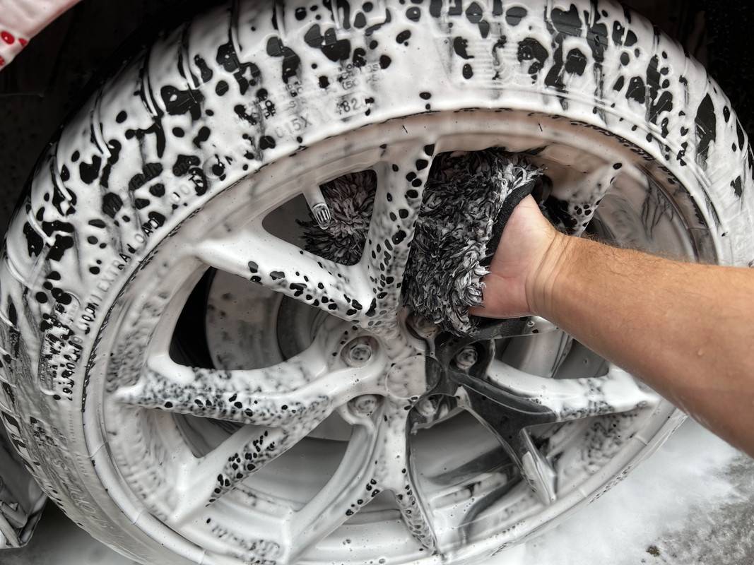

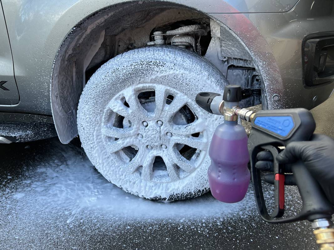

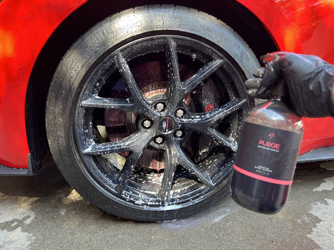

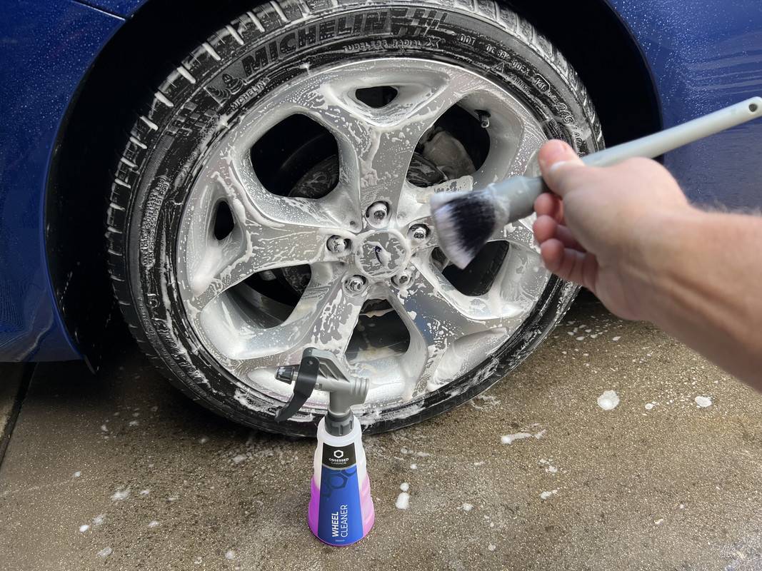

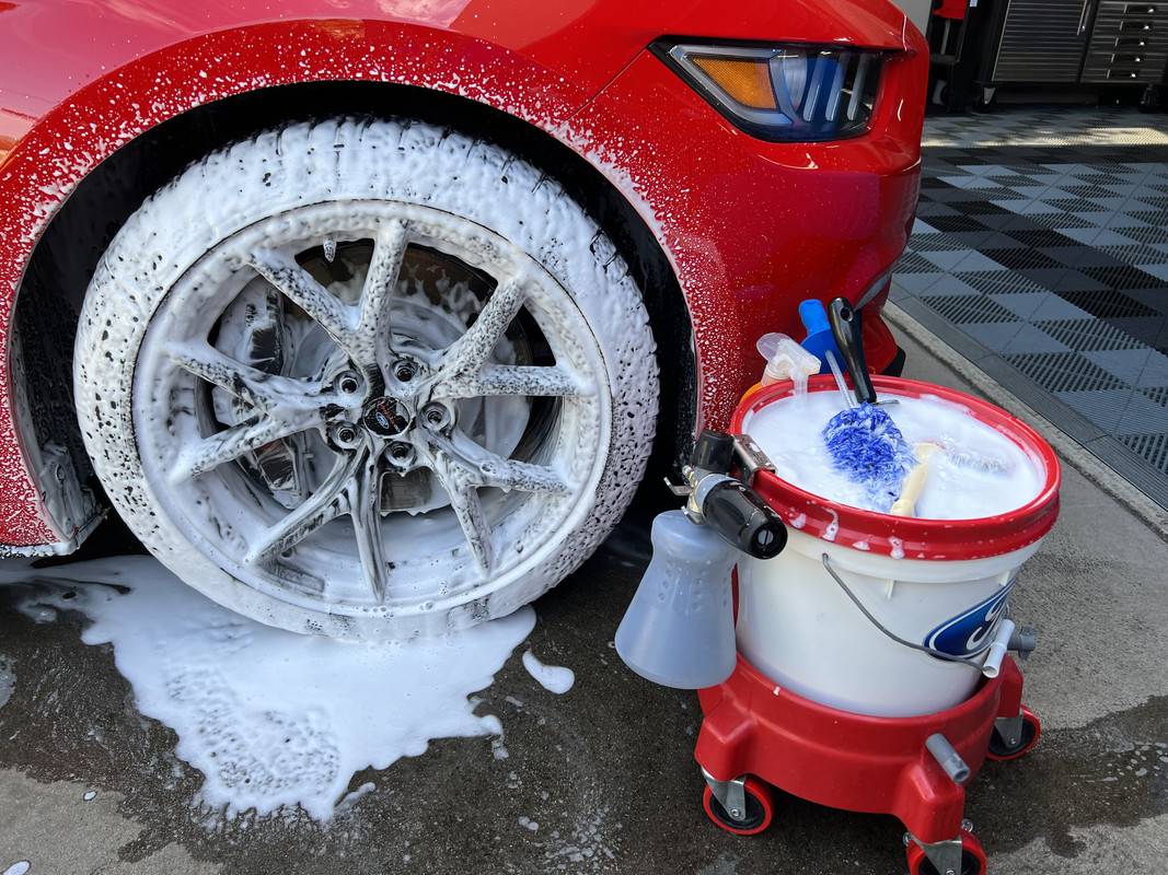

I wrote this a couple of years ago regarding PP1 wheels, but the same would apply to the fiddly Mach 1 wheels too................
PP1 Wheel Cleaning Guide | 2015+ S550 Mustang Forum (GT, EcoBoost, GT350, GT500, Bullitt, Mach 1) - Mustang6G.com
Some things have changed since I wrote that, mainly the use of a softer brush for cleaning the lugs, and a small finger mitt for cleaning in, around and the back of the spokes.
Cyclone Ultra Wheel Mitt | The Rag Company
Detail Factory - Ultra-Soft Detailing Brushes | The Rag Company
As for chemicals, you don't always need a wheel cleaner, but it can be useful for when dealing with dirtier wheels.
Wheel Cleaners vs Soap | 2015+ S550 Mustang Forum (GT, EcoBoost, GT350, GT500, Bullitt, Mach 1) - Mustang6G.com
Personally, I typically use soap from my foam cannon on most occasions, but will switch to a dedicated wheel cleaner periodically (say every 4th wash) to provide a deeper clean. For that, I'm using NV Purge as it helps remove iron contamination, or Brake Buster delivered via a foam cannon (don't bother diluting Brake Buster, you remove so much ability by doing so that you may as well just use soap).
P&S Detail Products - Brake Buster Wheel Cleaner | The Rag Company
Purge | Reactive Wheel Cleaner – Nv Car Care USA
Purge -
Brake Buster -
Soap -

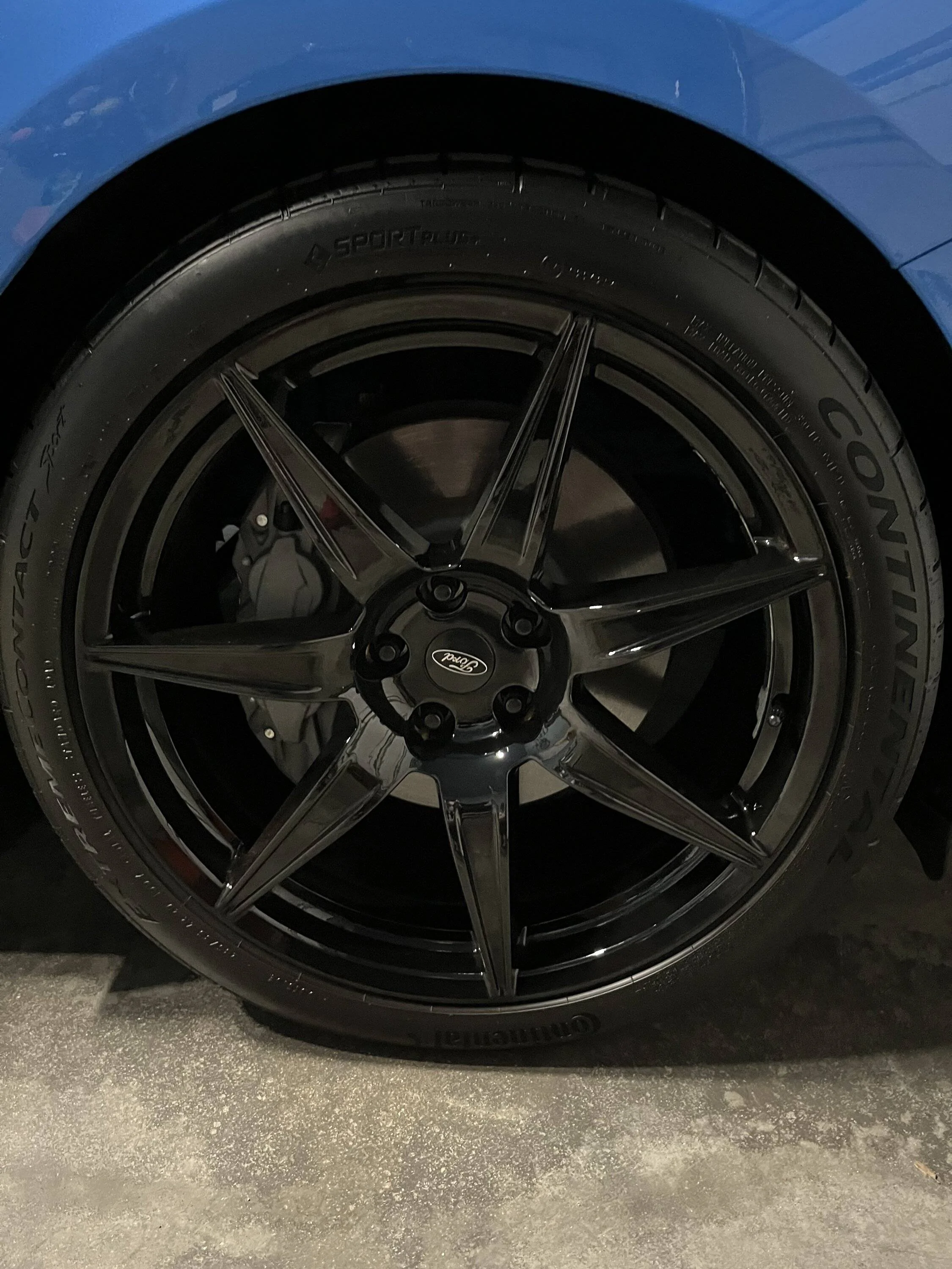

I'm using aftermarket rims that are ceramic coated. Getting them coated will help.
I've read several comments of the factory pads shedding a lot of material. Some have replaced their pads sooner. Something to think about. I continue to use the stock pads.
I do not use a dedicated wheel soap. Gyeon Bath is for my maintenance wash. Two to three times a year, I use Gyeon PPF Wash, which is a mild decon soap. I use both products on the rims.

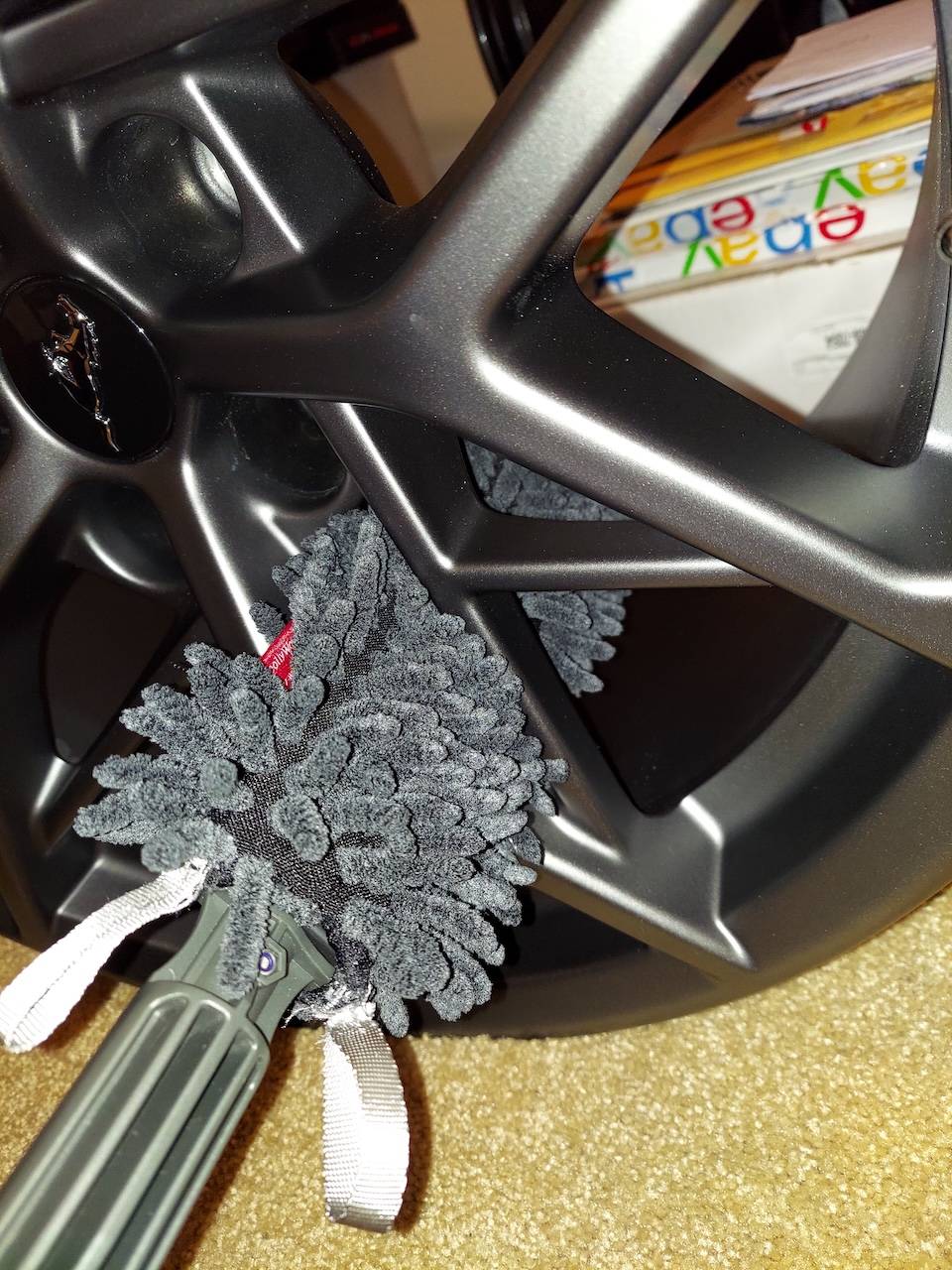

Physical tools, I have three: 1) Microfiber Mitt, 2) Wolly Wormit and 3) Q-tips.
The microfiber mitt gets the obvious. I use this tool initially.
The Wolly Wormit is a good barrel cleaner. I did some test runs with it on my rims. I can confirm it works well. https://woollywormit.com/
Finally, Q-tips get the really fine areas, the cracks or crevices the other tools cannot reach. I wet a few, and dance them past the fine lines on the rims. One quick pass is often all it takes.
Long-term, you can consider aftermarket rims. A new set of wheels can not only enhance the car's appearance, the weight savings are a quick and easy performance kick. I removed close to 40 lb / 18 kg of unsprung weight, while preserving the factory rims.
