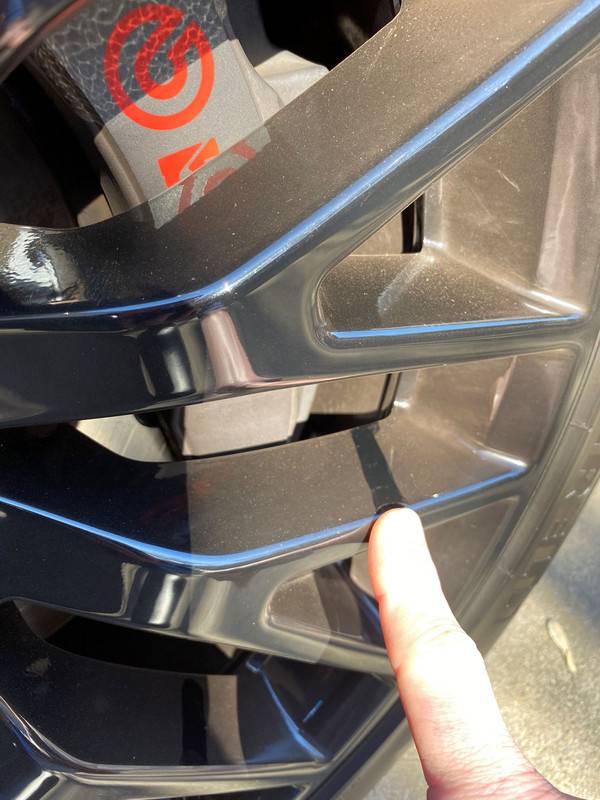

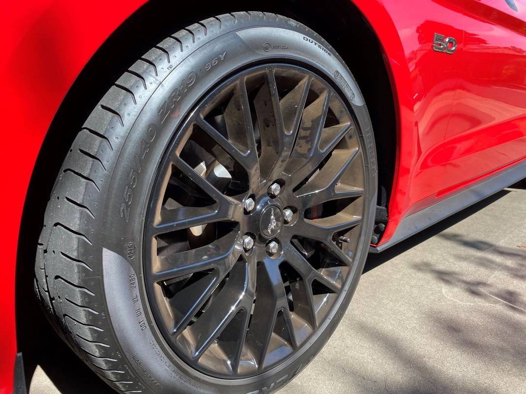

I'm a big advocate of having the right tool, or product, for every job. When I "clean" the wheels on my cars, I'm generally just washing off some light brake dust.

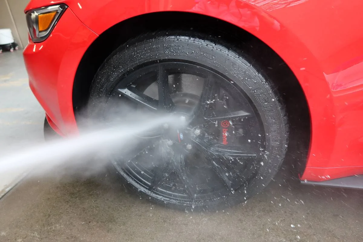

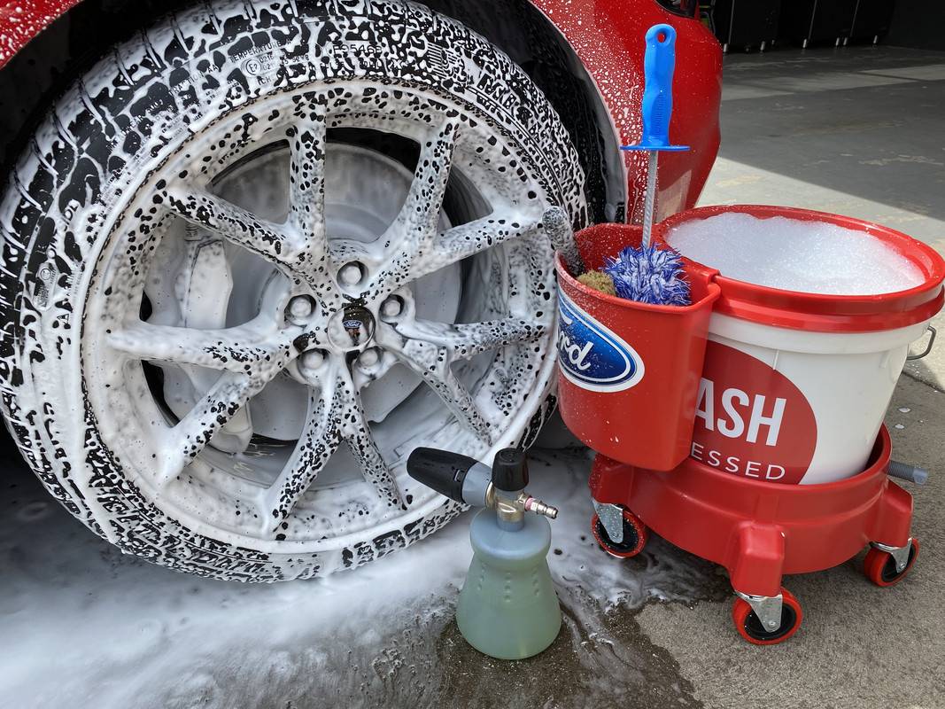

When protected and regularly cleaned, brake dust and road grime does not have the chance to build up and bake onto the surface. In this case, I always recommend just using regular car soap for cleaning. The majority of the dirt shown above generally washes off with a pressure rinse, the remaining grime is then taken care of with soap.
There are a few benefits to sticking with soap over a wheel cleaner. Firstly, its easier on the hands and negates the need for wearing gloves. The smell of most wheel cleaners are at best unpleasant, at worst putrid. Breathing in chemical vapor is also a real risk too.
I generally use what ever soap is in my foam cannon at the time, adding a good slug to my wheel bucket also.

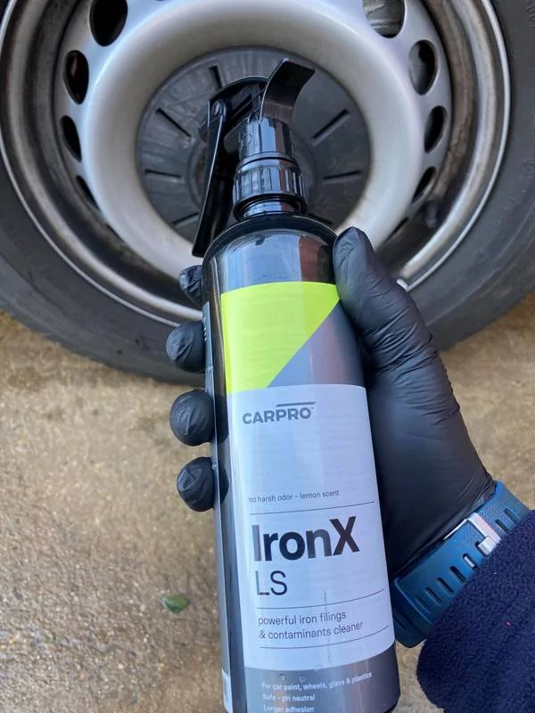

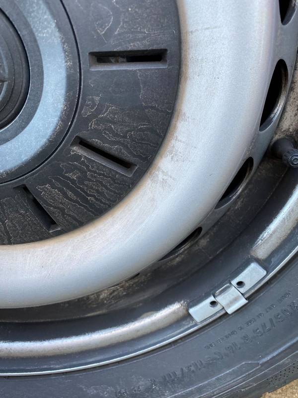

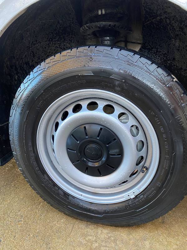

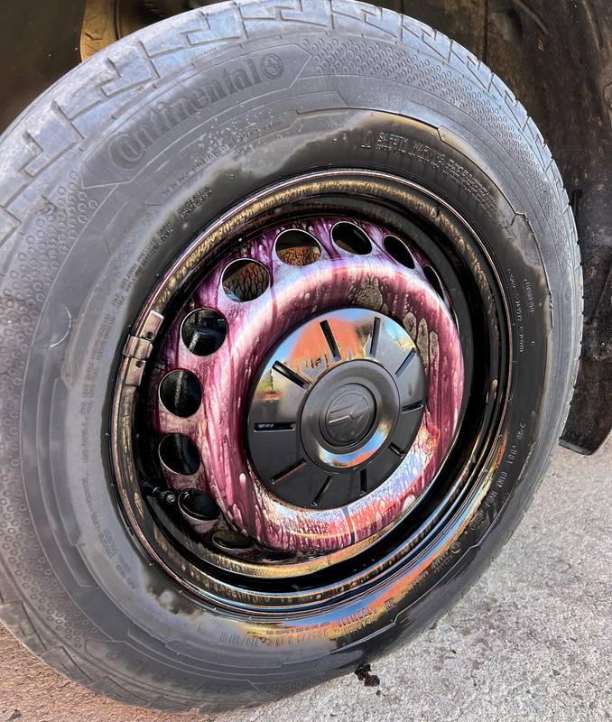

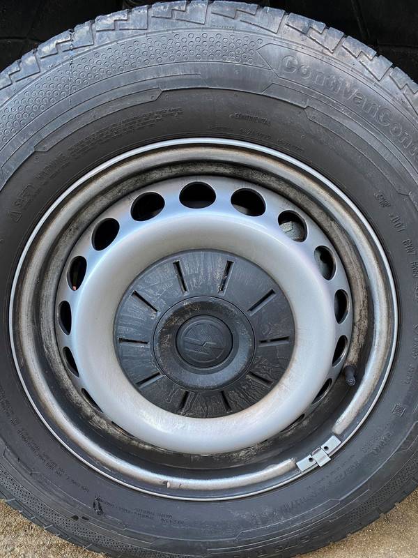

This VW Crafter van had baked on brake dust from many hard working miles. This is a situation where the power of a wheel cleaner is most certainly required. Today I used CarPro IronX, which is a iron removing wheel and surface cleaner. The wheels had the product sprayed on dry so as to not dilute, which immediately turned purple. I then hosed the product off, re-applied and scrubbed with a brush before a final rinse.
I still have the smell of that stuff up my nose but at least the wheels are rid of that horrible black mess.

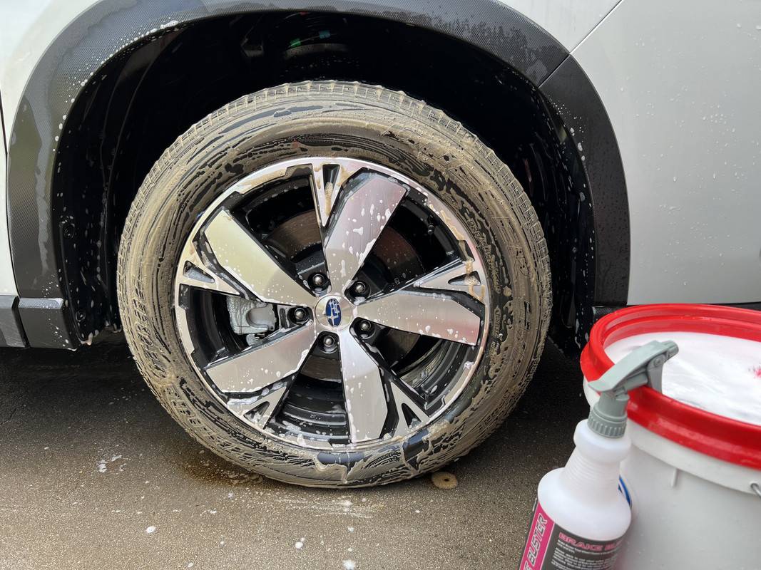

In terms of products, my go to is undiluted P&S Brake Buster. I like how this product can do both wheels and tires, I also use it to clean extremely dirty wheel wells.

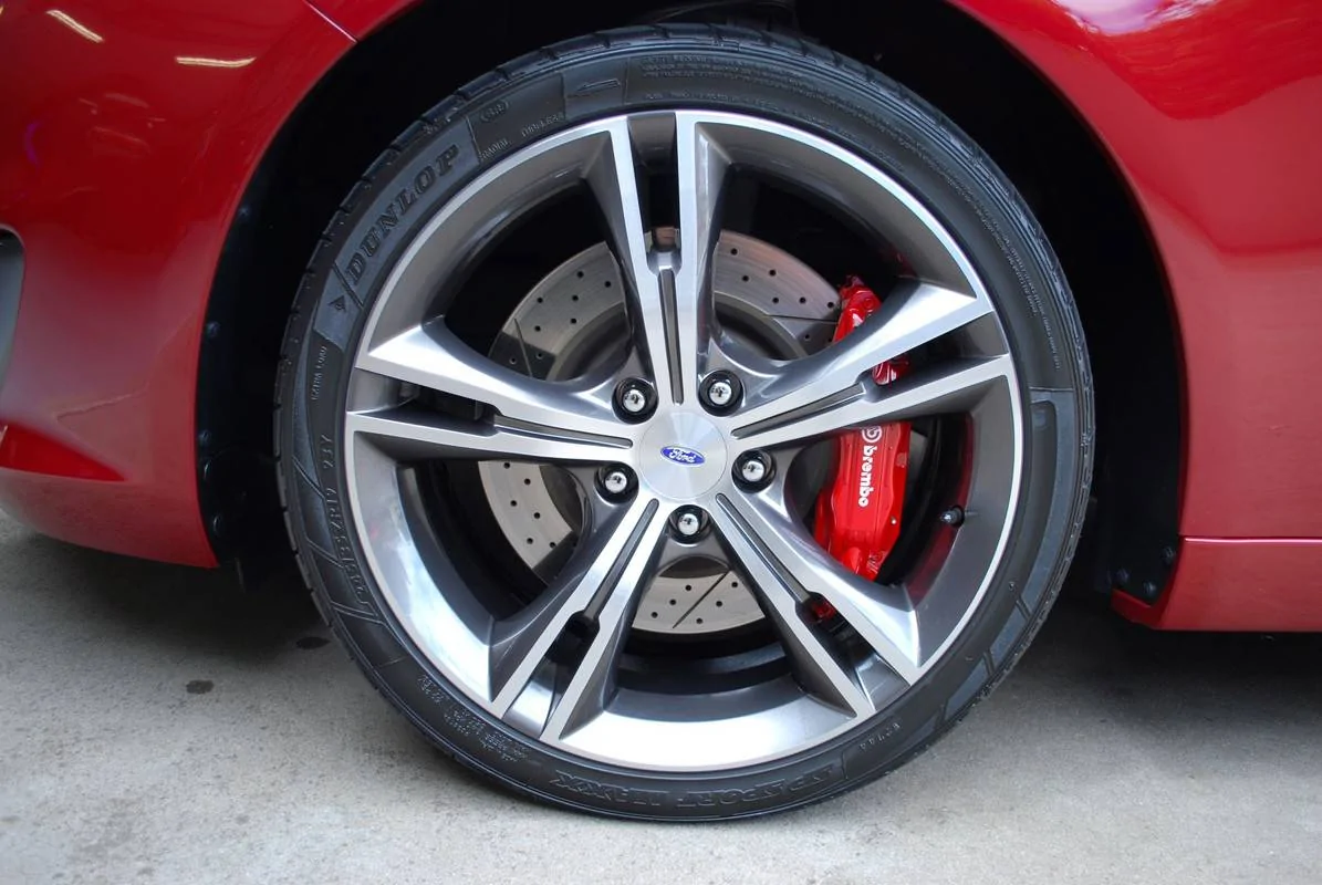

In these two pics, you will notice very minimal "browning" owing to my regular washing.

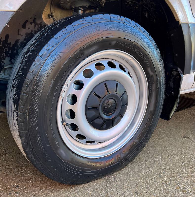

These tires on the other hand had never been cleaned..........
With Brake Buster just sprayed on -
After agitation -

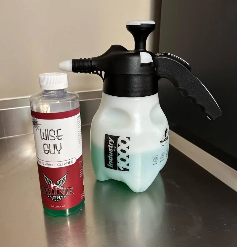

I would also recommend Shine Supply Wise Guy, this is a very strong alkaline wheel and tire product for heavy duty cleaning. I actually don't use this on wheels for that reason.
Tire cleaning is one of those "why bother" type of detailing tasks, but trust me, a completely clean tire then accepts your chosen dressing much better, both in application and look.

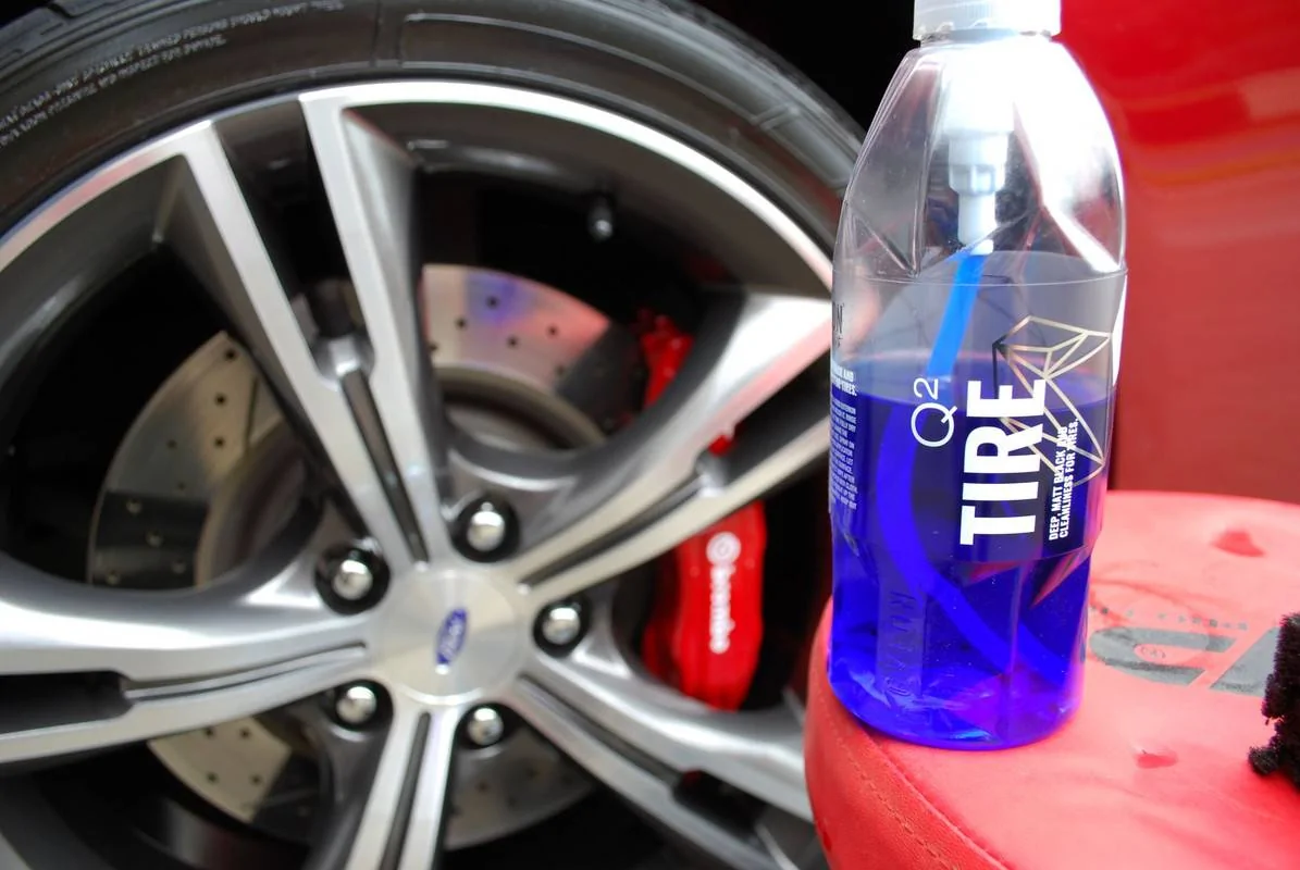

I assume you mean these two..........
The Q2 Tire really does seem to seal up the tire and prevent browning, it's solvent base means it lasts longer than water based dressings. I found I really only had to re-apply Q2 Tire every few months.
I really liked the semi-gloss appearance Q2 delivered. I would recommend being less generous with this product and remember to do a final wipe after it has cured to remove any excess. I had a lot of problems with slinging until I learnt this.

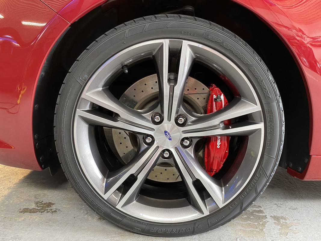

This pic from earlier is actually sporting Q2..........
