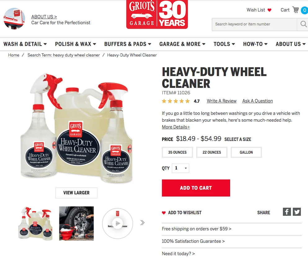

Does anyone have a recommended detail product for black wheels to get dust, etc that has been dried on there for a while? Thanks

Thanks, on sale at pepboys. Love their order online and pickup discounts

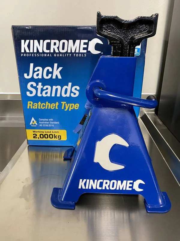

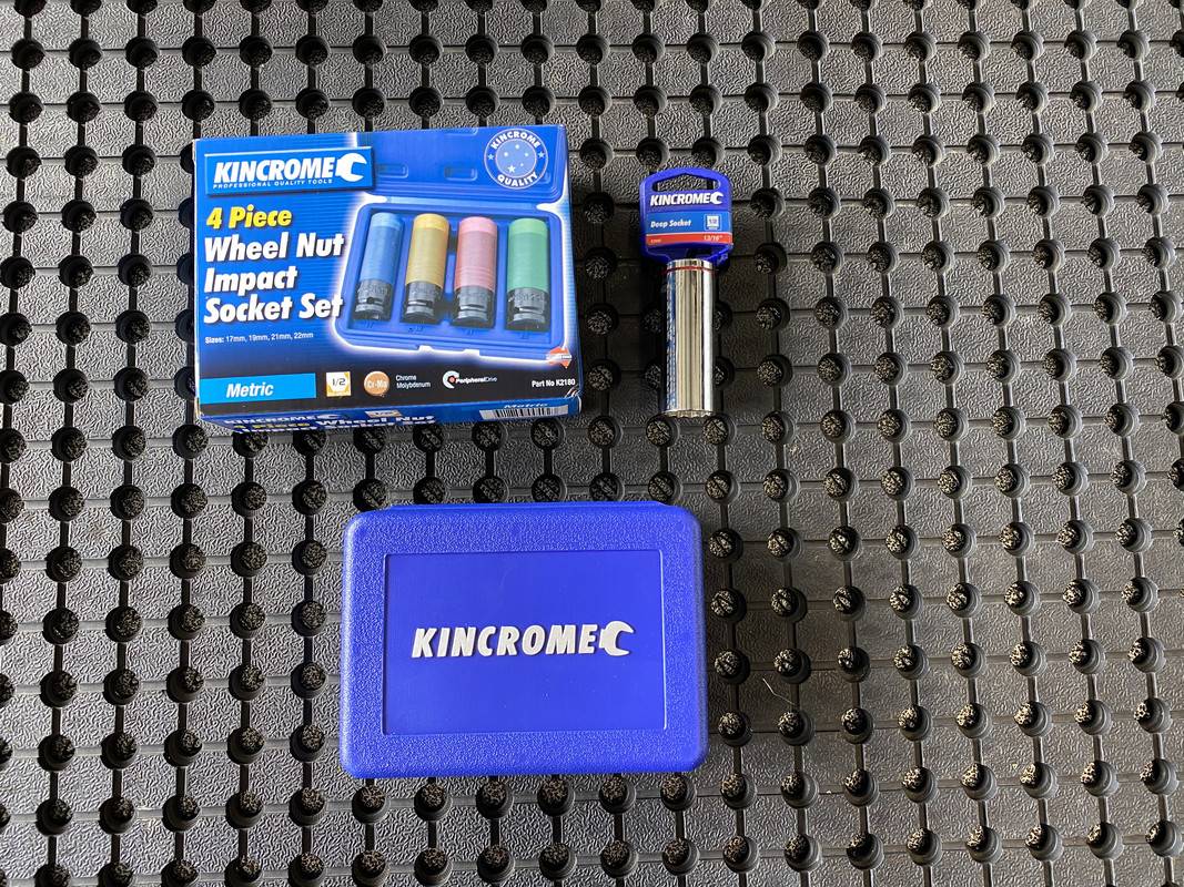

We must think along the same lines, I am planning on a wheels off process at some stage this year too.
I'm in the process of getting a few things to make removing wheels efficient, just need to get a trolley jack and I will ready to go.
In terms of process, I'm looking washing with a strip soap, using IronX for chemical decon and then a clay bar on the outer face and inner barrels. In terms of polish, not sure how I will proceed yet. Protection will be CarPro DLUX.
