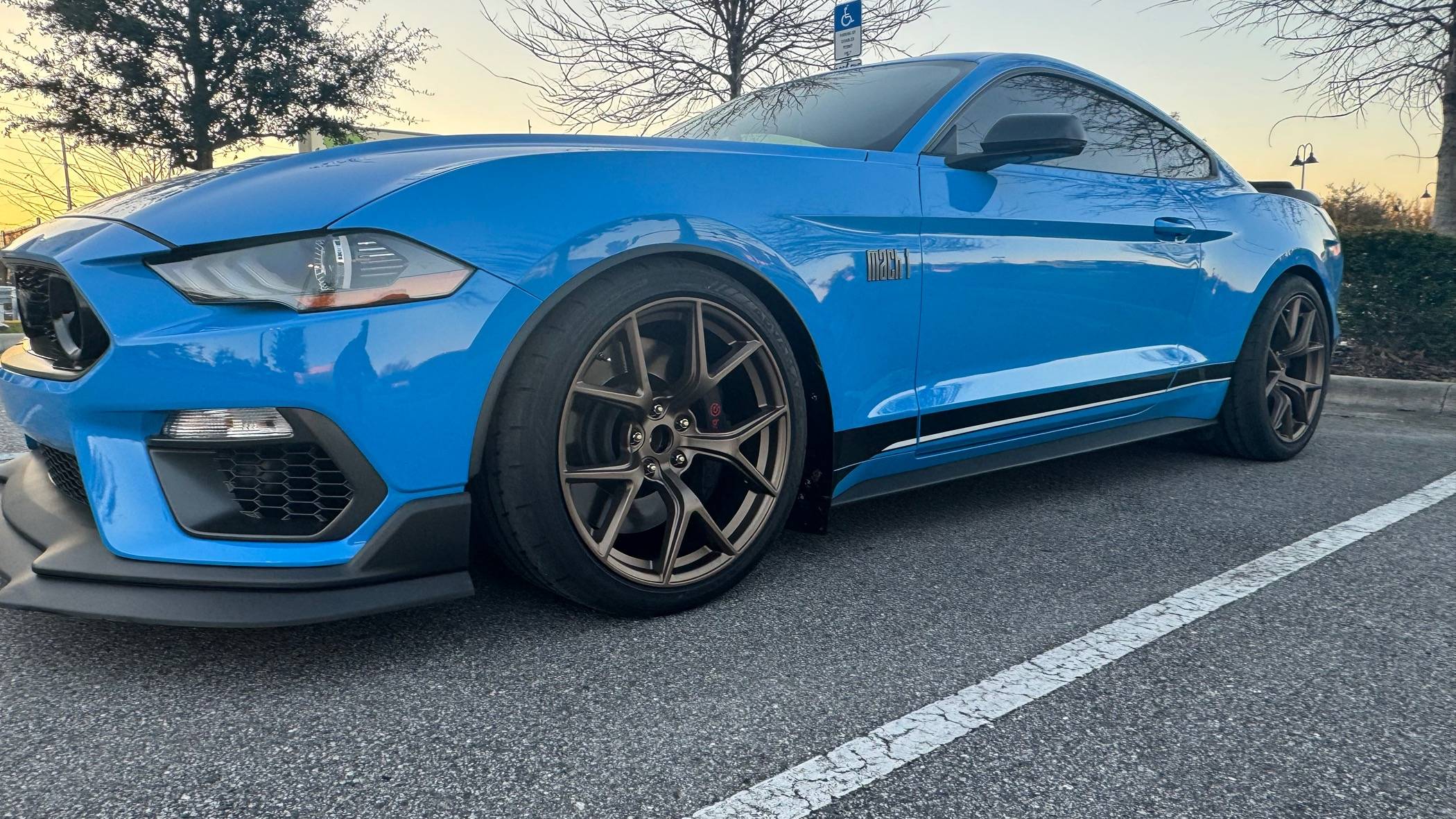

I am the same went from standard springs, to HP springs, to Steeda Sports.
Standard to HP I had a very small change in ride height, maybe 1/8”. From HP to steeda sport springs about 1/4” lower. I want to come up about 1/8” in the front.
Have dual rates in the garage should install those sometime this month.
LMR DHP1 forged wheels 19x10.5 with 305 front 19x11 with 315 rear Michelin PS4S
I am considering the dual rates and the steeda magneride controller. Please share your experience with the dual rates once installed.
