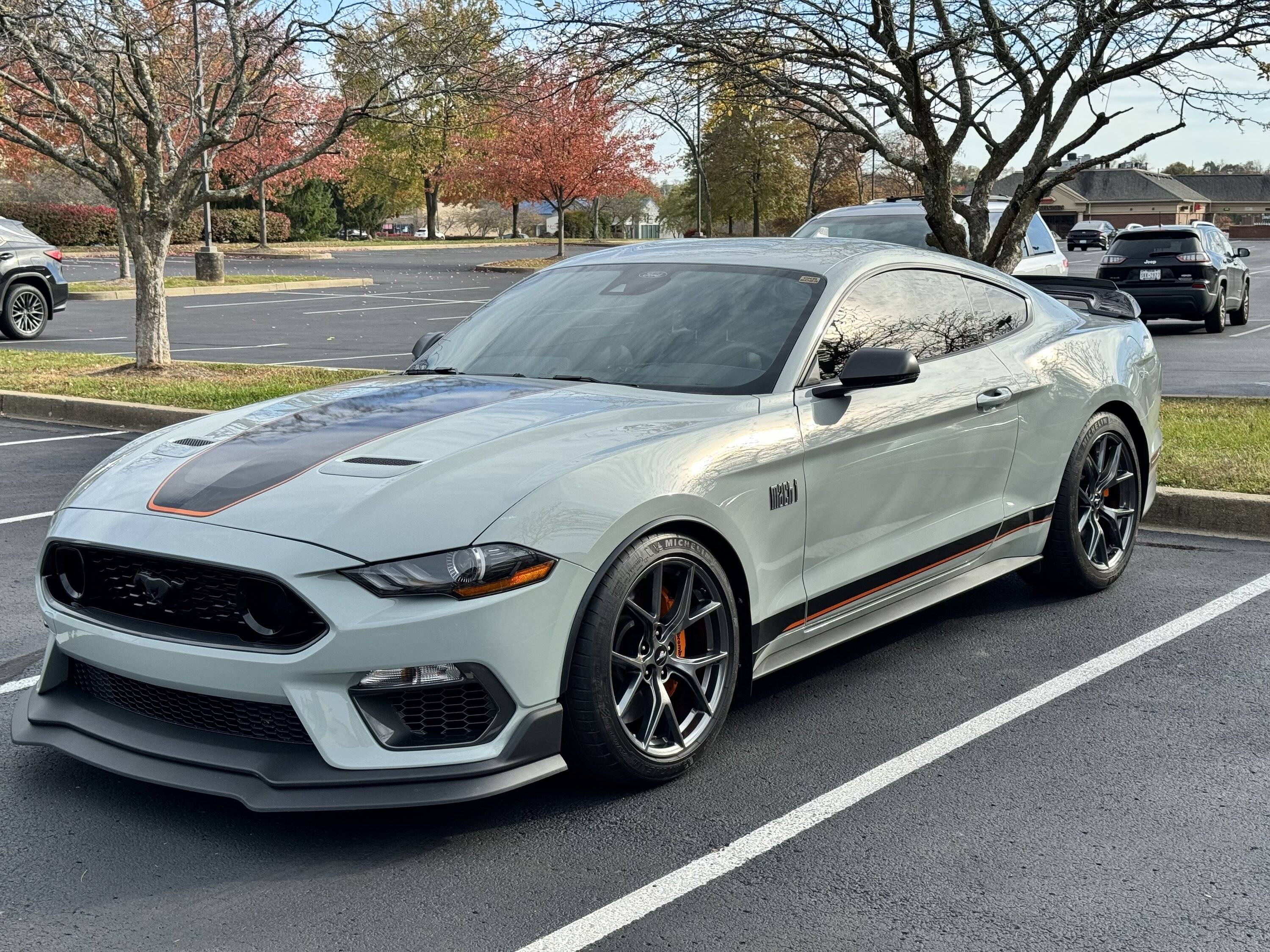

Howdy, I'm also looking to run a second set of tires/wheels for cold weather / all season.
I'm not clear on the differences between HP vs non HP from a wheel clearance perspective. It always seems threads focus on the inverse of this.
Does anyone have pictures of the standard Mach 1 wheels on an HP Mach 1? Does it look silly?

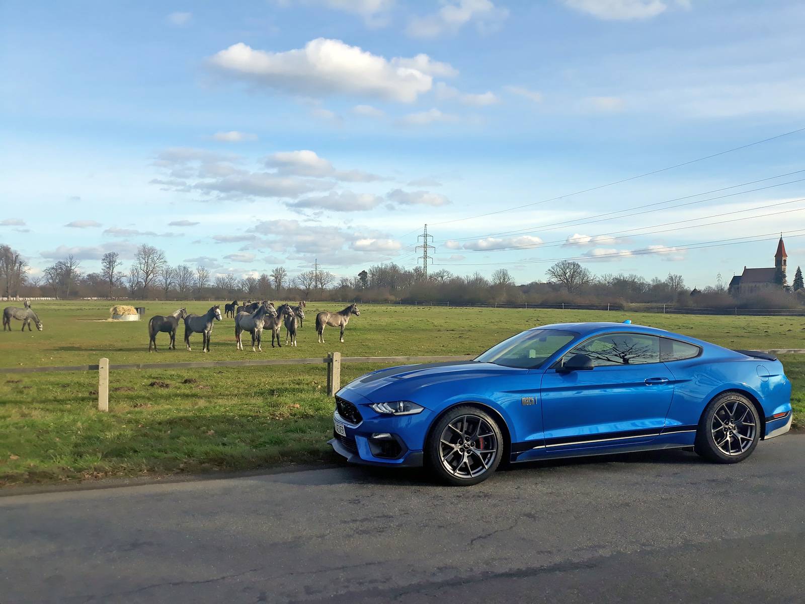

They look fine, they're just tucked in a bit (an inch). It's not an issue at all looks-wise with the lip mouldings. I have a few pics as I run a winter set too.
Make sure the diameter is kept similar for both sets. With HP 305/30 and 315/30 R19 it would mean 255/35 (or 265/35) front and 275/35 R19 rear for example (0.8% diameter difference). Like HP tyres it would sit lower a bit than with profile 40 regular tyres (this is a reason why I went for profile 35 for HP wheels in the first place, so I can keep standard profile 40 tyres on the winter set).

I'm glad you pointed out the OD difference. I would have missed that. Since I run stock HP wheels and tires, with the stock non HP tire od, that would have been taller than I was anticipating. Looks like 255/35 and 275/35 r19s will be good
Is your car a euro market HP Mach 1?

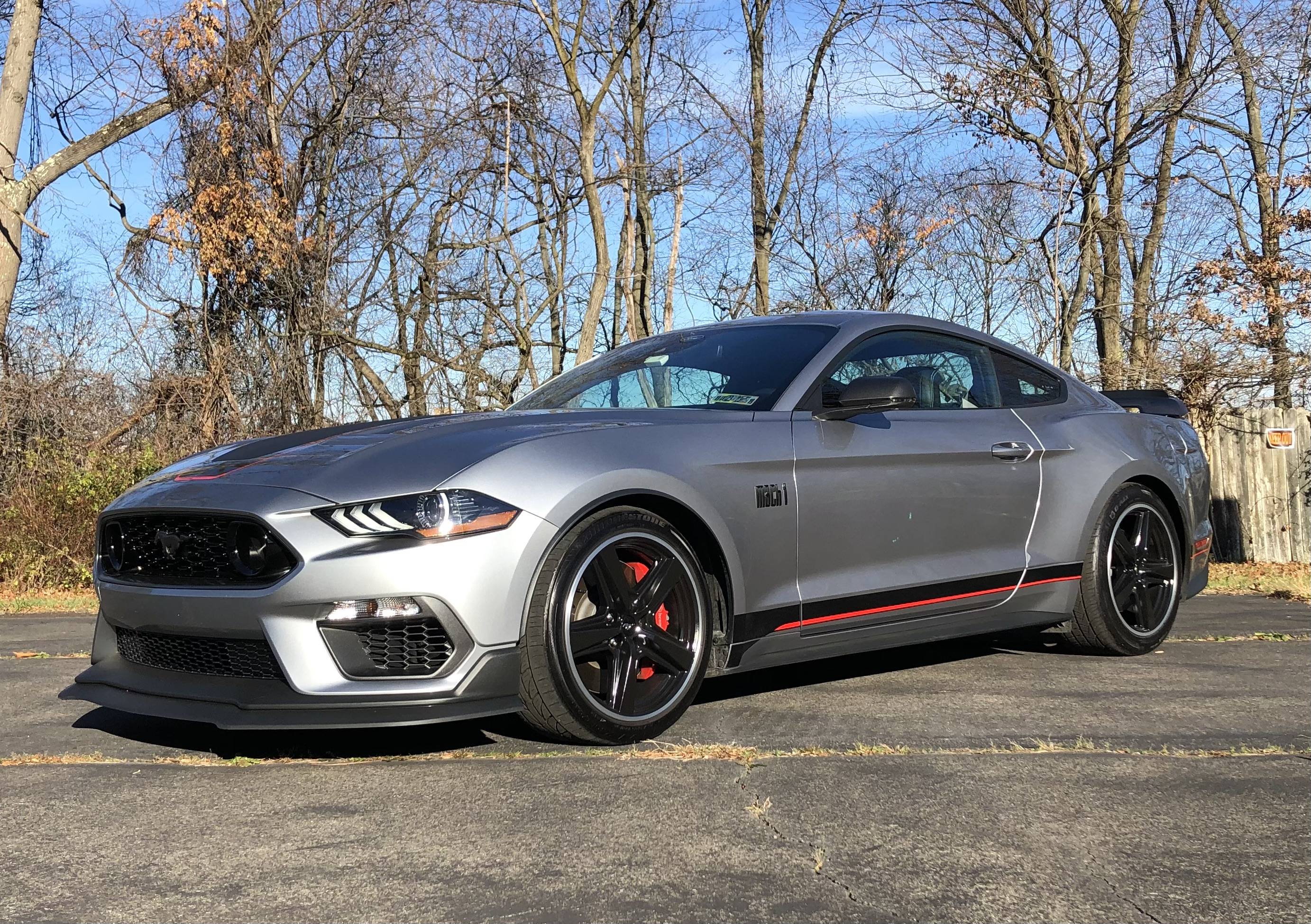

Here you go... I run a set of base wheels with base tire sizes on my HP from November-April:

I've been agonizing over stock Mach 1 wheels or the same size pp2 style wheels. I thought I made up my mind, but these look darned good. Did you paint them? Ford performance sells them in the tarnished aluminum. The pp2 style wheels in matte black.
Also is your Speedo correct with the 40 series tires?

Daily my HP in the Michigan winters. Running Michelin X-Ice Snow 255/45R19 and 245/45R19 on the Base wheels (I wanted a bit of a lift; no issues with rubbing).
