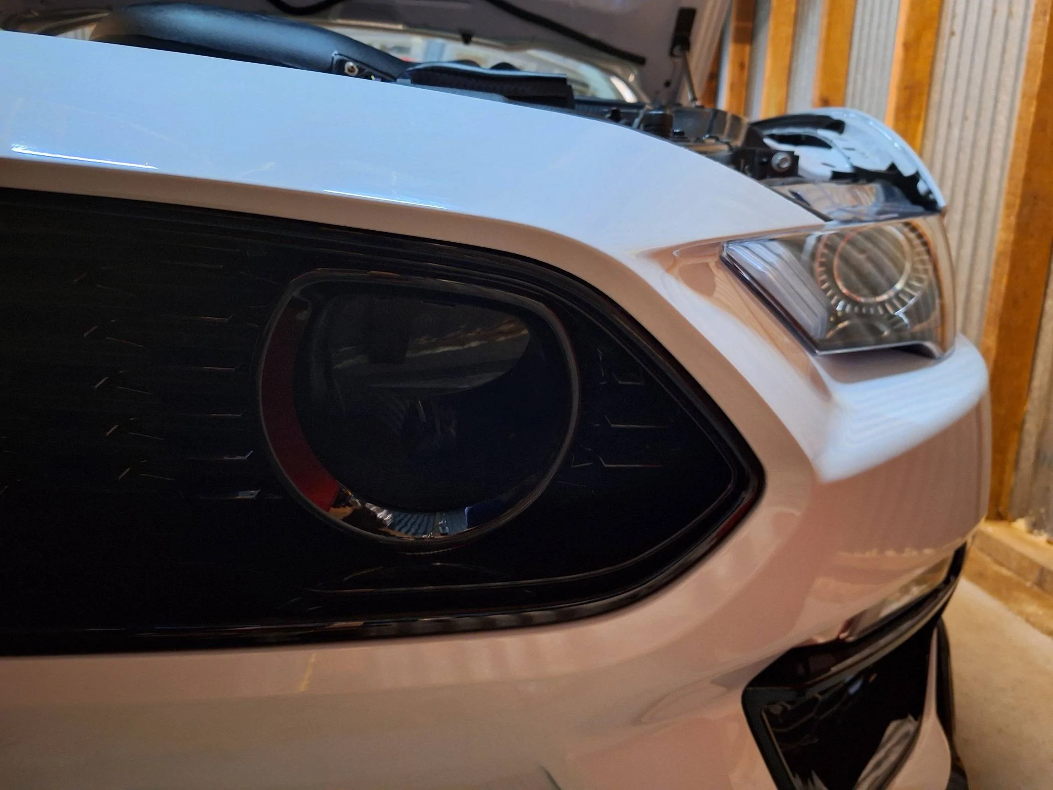

I was studying how air flows thru the grill into the cold air take on my new to me 2019 Mustang GT. The front grill was updated to a Mach 1 front grill by a previous owner. As best I can tell air is not flowing through the grill directly into the cold air intake because it's blocked off. I put a flashlight on the tube going into the cold air intake, facing towards the grill and no light comes through.
So how does cold air get in to the cold air intake?

It's there, just really small openings. Alot of us open up that area of the grill to allow for more air into the snorkel that directs air to the filter.
Specifically for Mach1 bumpers, I believe you can pop off that fake foglight cover and it will do the same.

I was wondering about that fake fog light, if I could easily pop that off or would I have to cut it out.

Been waiting to see someone hook their intake to the Mach 1 fog light hole for a true cold air intake
I looked at Dodge Challengers before I purchased this Mustang, they have this connection, so I thought the Mustang would as well. I never checked until yesterday.
Yep that’s where I got the idea as well. Really surprised someone hasn’t done this yet

OP do you have the full Mach 1 bumper conversion? Or just the grille?
