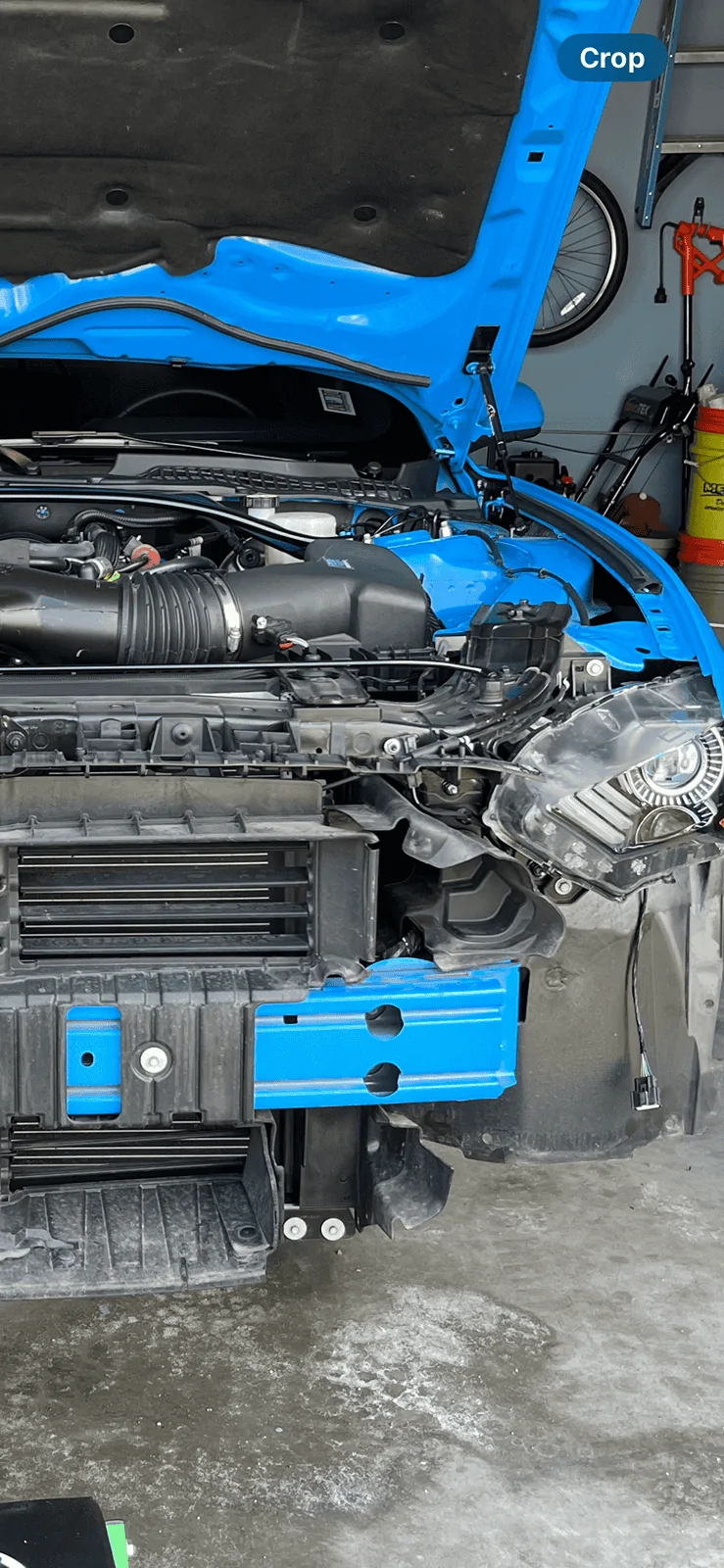

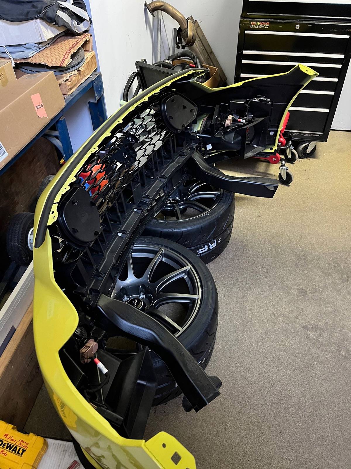

I don’t know on the bumper conversions, but my 22-Mach1 doesn’t have the active-louvers/shutters, behind the upper grill is totally open to the radiators and I can see into the duct that feeds the stock (gt350) lower airbox the M1 uses. You could pop out the back of the fake fog-lights (4 clips) but it would not direct air anywhere…it’s all open behind the whole thing. As other stated : when driving IAT are only a few degrees over ambient.
These images are the bumper removed on a M1, you can see the clips on the back of the grill for the fog light covers, and you can see the air feeds into the airbox in the space between the radiator and headlight on the drivers side. The 2 ducts at the bottom that extend out from the bumper are the brake cooling ducts.

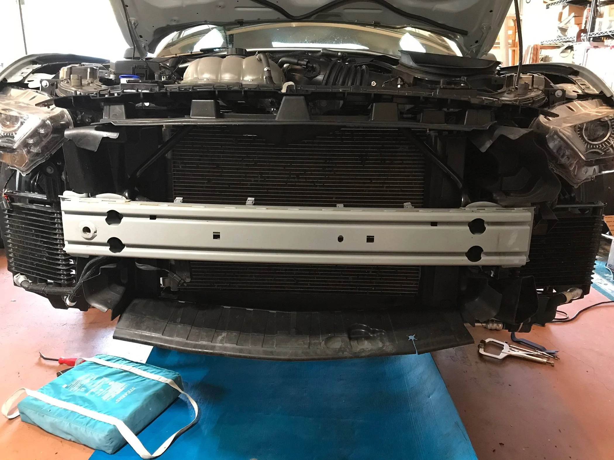

Another great pic. This should help out some folks who want to run separate coolers but don’t know where to put them.

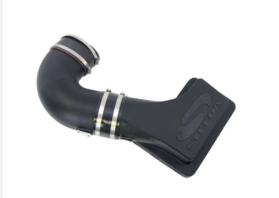

Absolutely CORRECT. If you want truly cold air you will need a sealed unit like what Steeda offers (this one is for a CJ or oval style TB). I‘m sure they make others for different TB’s. From what I understand you will need a stock lower box that is not supplied.
