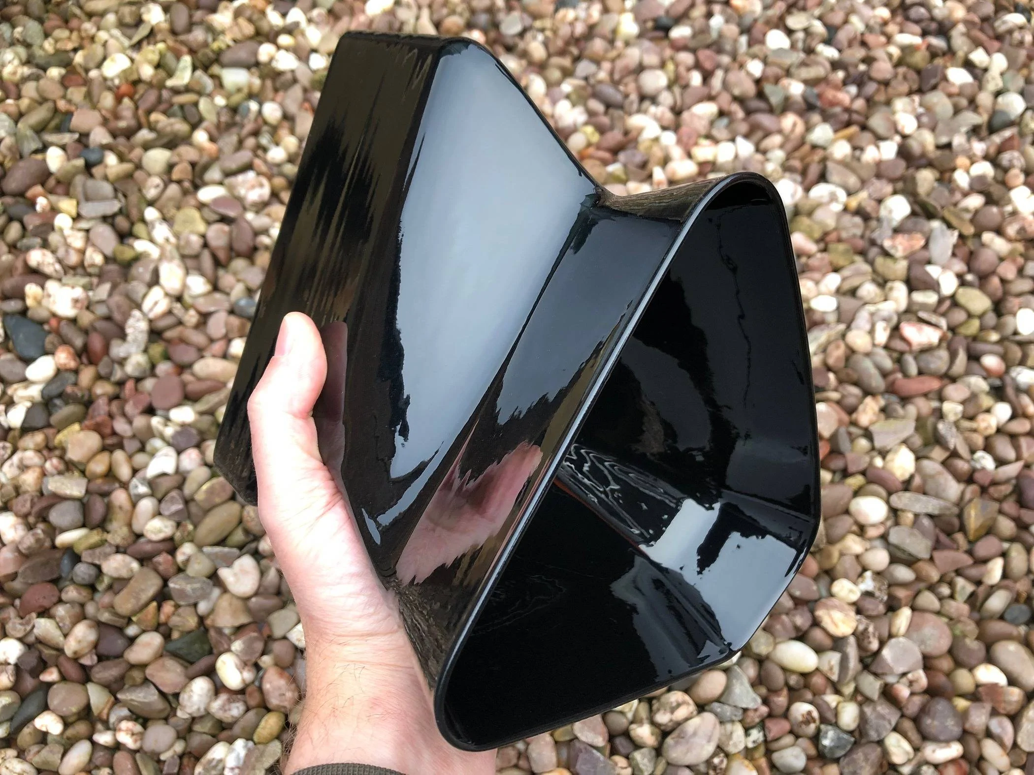

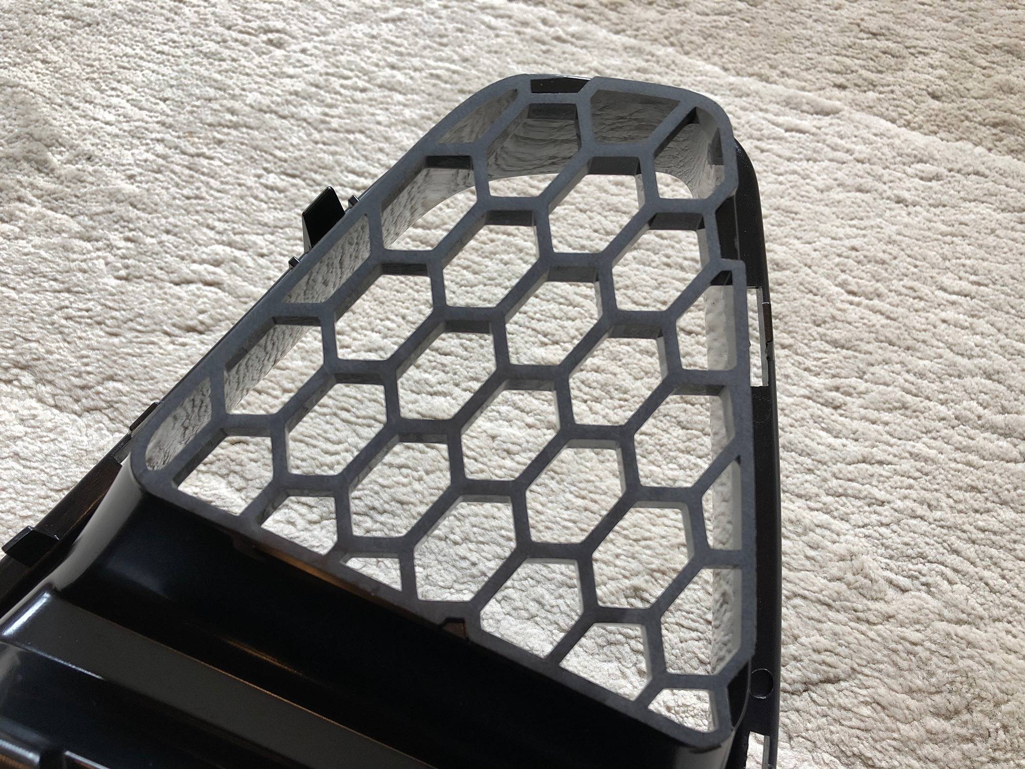

It's there, just really small openings. Alot of us open up that area of the grill to allow for more air into the snorkel that directs air to the filter.
Specifically for Mach1 bumpers, I believe you can pop off that fake foglight cover and it will do the same.
Its what I have on mine - currently in lime, but I'm going to black :

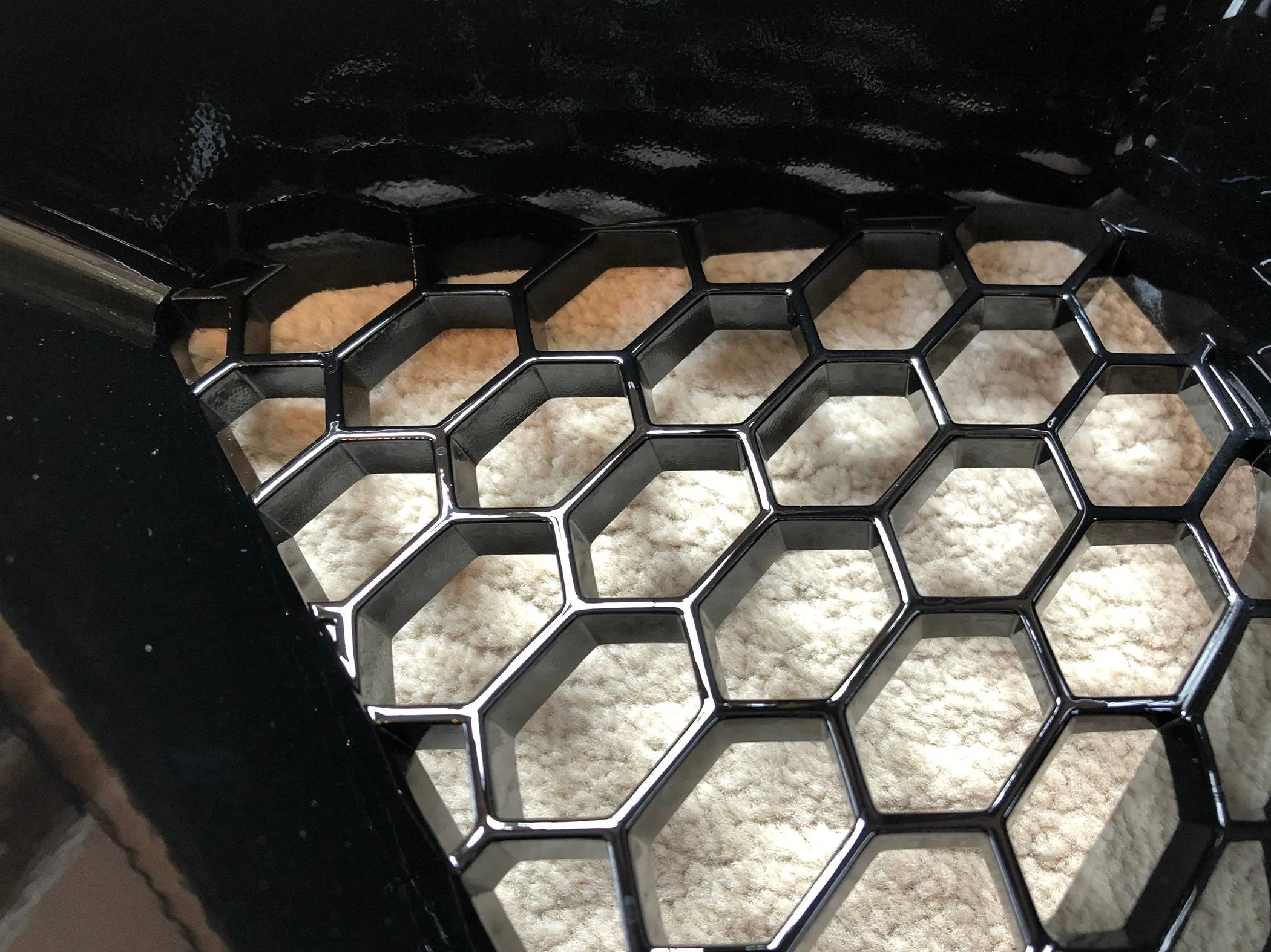

It sits behind a slightly opened up grill :

I can't argue either way for its effectiveness, but it doesn't replace the factory piece, it's in addition to it, and it extends the factory piece up to the front face of the grill :like:

It does not unclip, you have to dremel it out or fit the velossa tech behind your grill and drill out the blocked holes in the grill.
