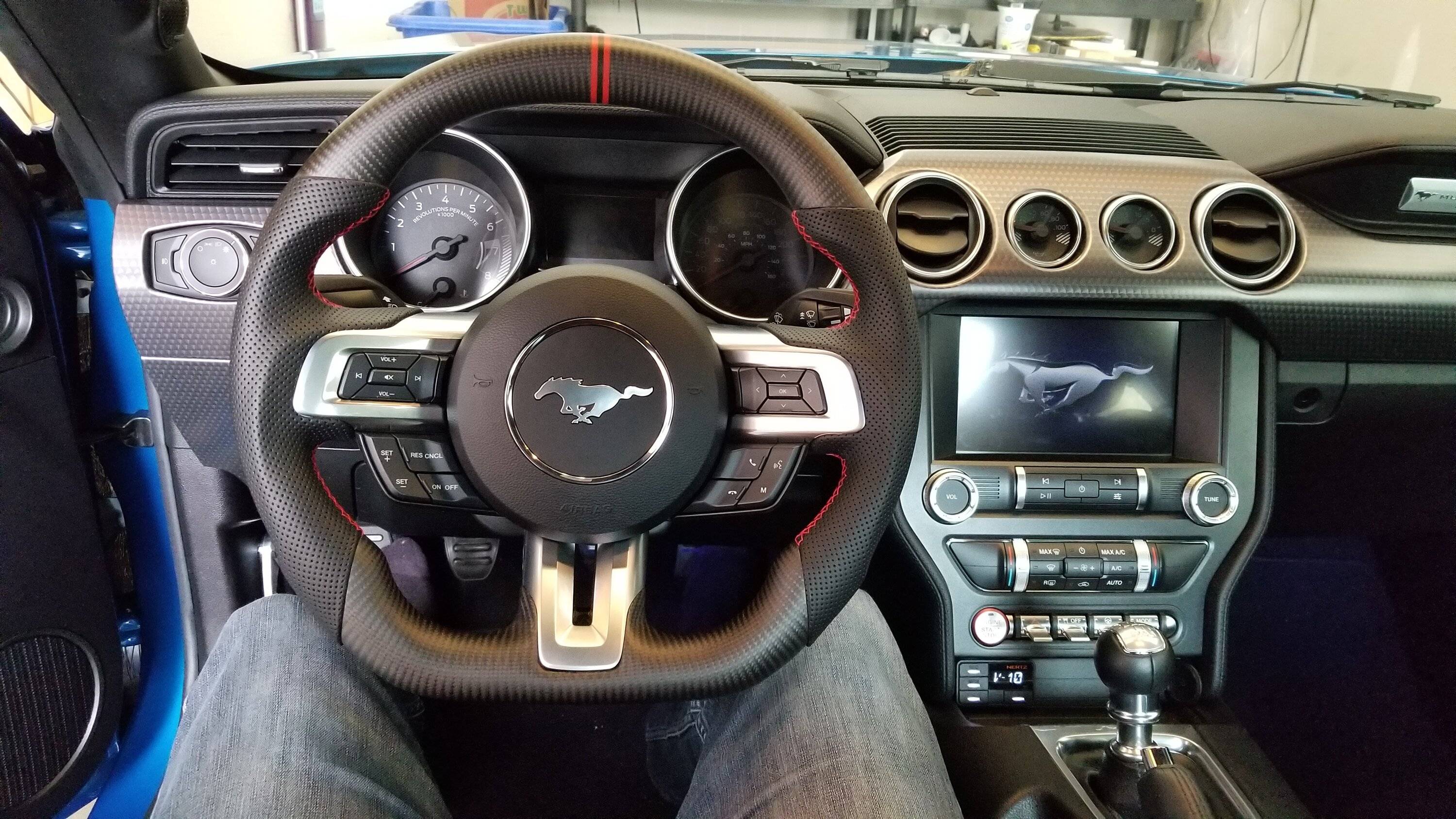

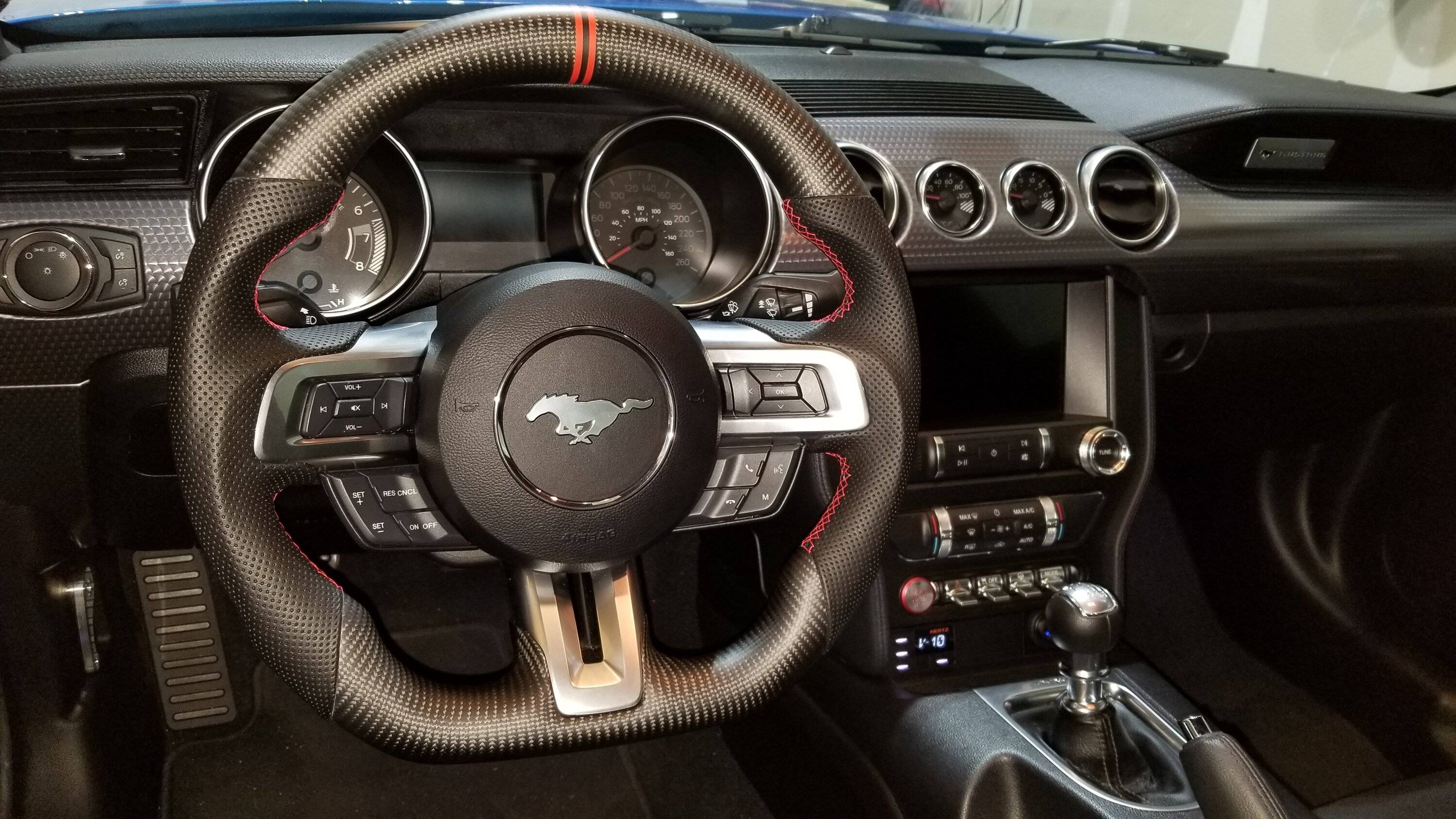

The hardest part is releasing the clips to get the horn/airbag released. Left side was easy, but right side I had to attempt multiple times. Ended up making a tool with a groove in the end so the spring would not slip off.
End result was worth it:
