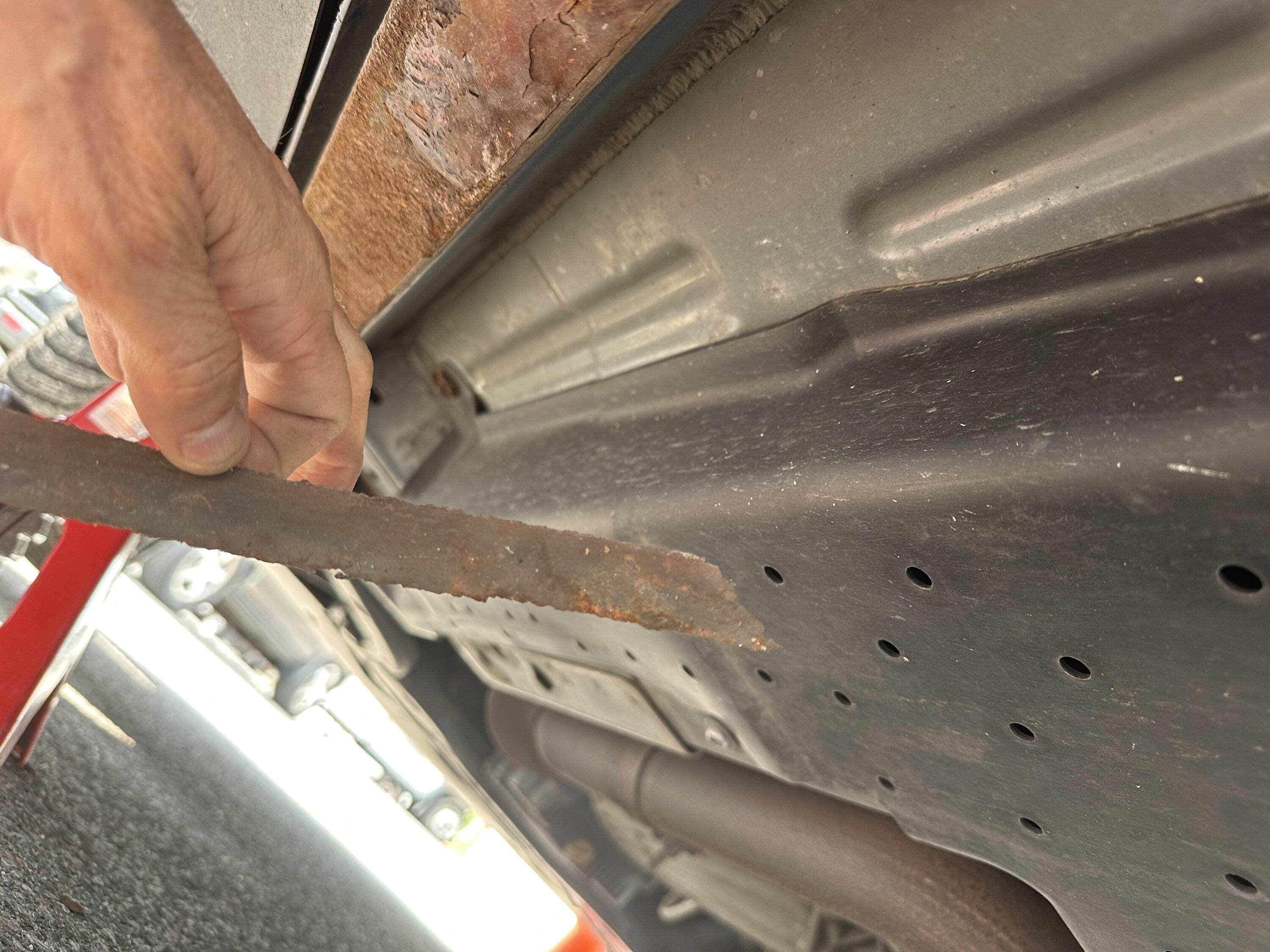

...the KB jacking rail.
Please keep the forum posted about how the KB rail holds up over time! I had Steeda ones rot out within 2 years. All the powdercoat had flaked off and by year 4 it was a dimpled mess. One ear of my jackstand even punched through the rusty rail when I lowered the car! I have pictures in another thread.
They refused to warranty it - blamed road salt and "atmospheric conditions." Lifetime warranty doesn't seem to mean much.
I don't care about a couple hundred dollars, I just want to do it once and forget about it but the Kenny Brown rails have very little feedback.
Going to be hard to find a rail that will hold up to NY winters unless someone makes it out of stainless steel.
I've had my Steeda rails on the car since early 2019 and they're still in perfect shape, but we don't have to deal with road salt and NY winters down here in GA.
With the weather improving I hope to get KB jacking rails and flat bottom kit on soon. Definitely will get some pics and feedback.
I am glad to be getting the Steeda rails off as well, mine are rusted also. Since I have seen how the Steeda rails hold up, the Lifetime Warranty is especially meaningless because I don’t want their jacking rails back on my car. The bottom of my car hasn’t gotten rusty, it is lame that their rails rusted at all, let alone how quickly and badly they rusted.
Well if we all lived in a perfectly dry state none of this would matter. Ford could save a lot of money and pass on the high quality coated steels. Of course, Ford can be sued and then there would be safety recalls and so on. But man, my exhaust and rear rotors are also five years old just like the Steeda rails and they weren't nearly as bad as Steeda's "powdercoated" piece. And brake rotors are just cast iron, not even steel. I mean look at the giant chunks flaking off! My underbody is beautiful, the exhaust is thin wall steel and of course it has rust but it's not rotten, same roads, same car.
And also, I Steeda is hyping their awesome powder coat process and resistance to salt spray in another thread. And also their lifetime warranty, which they refused to honor in my case because of "chemicals" (salt spray).
