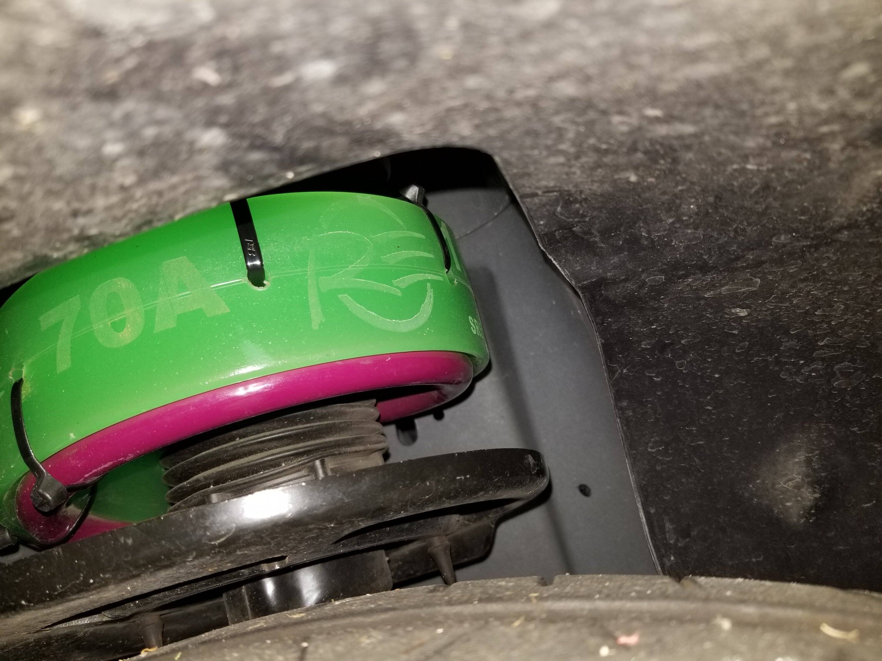

Cool. It's always fun to find out the next step in the story. The spring rubber will show up as a polyurethane donut of sorts. Take a hack-saw and cut the ring once. Put the car in the air and feed what is now a polyurethane strip of sort in between the middle coil. Use zip ties to secure it in the spring. I drove on a pair for 6 months and they still basically look new.
Here's a pic of what the spring rubbers look like installed.
Now, about the Sunbeam....There's just no way for a modern car to match it. The holy-grail of that type of sportscar is 2000# and 400 HP (Roughly numbers off a competition Cobra). The Sunbeam wasn't 400, but it was enough. The closest thing to that built today would be a Miata.
If that goes in between coils and not on the top end, does this increase your spring rate? How does the car feel after installing?
By blocking one of the coils from compressing. If we reduce deflection, we increase spring rate. It feels exactly like any other spring.
