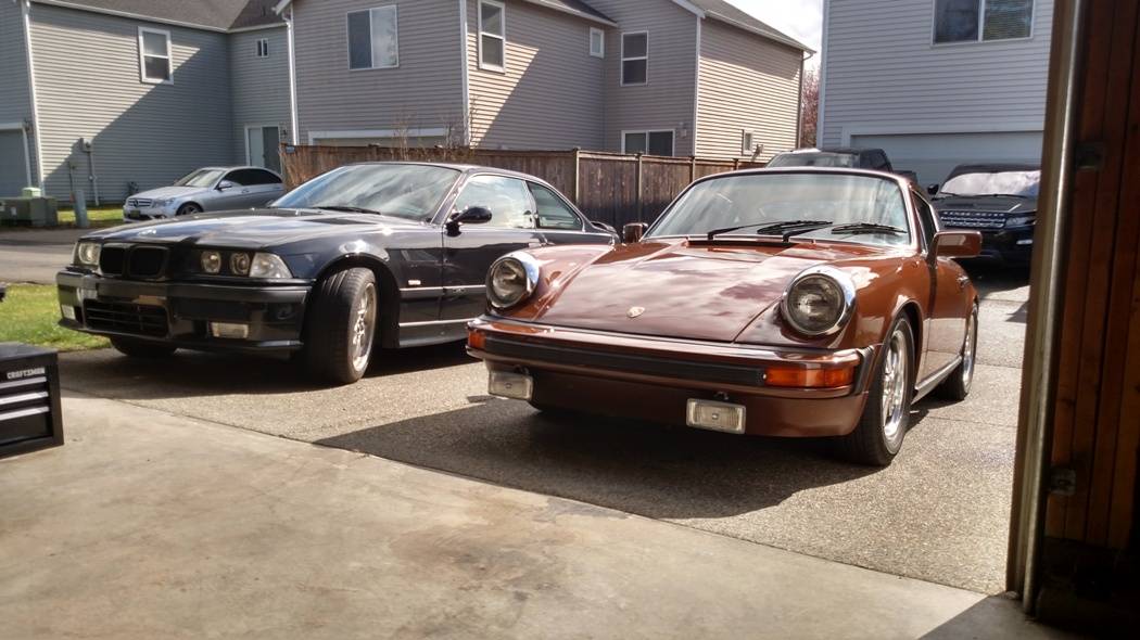

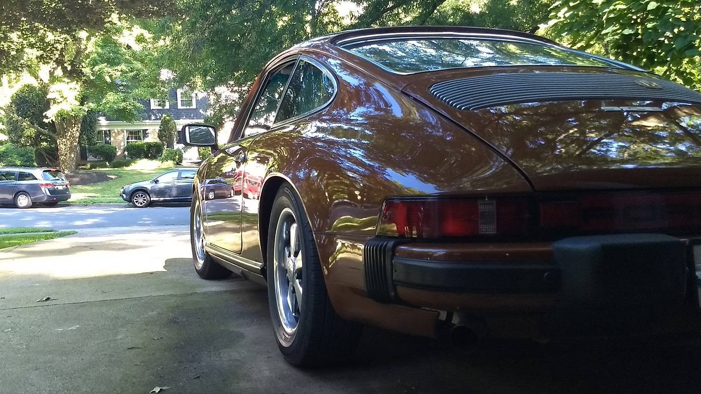

Because posts are worthless without pics, here are a couple.
GOOG LUCK!

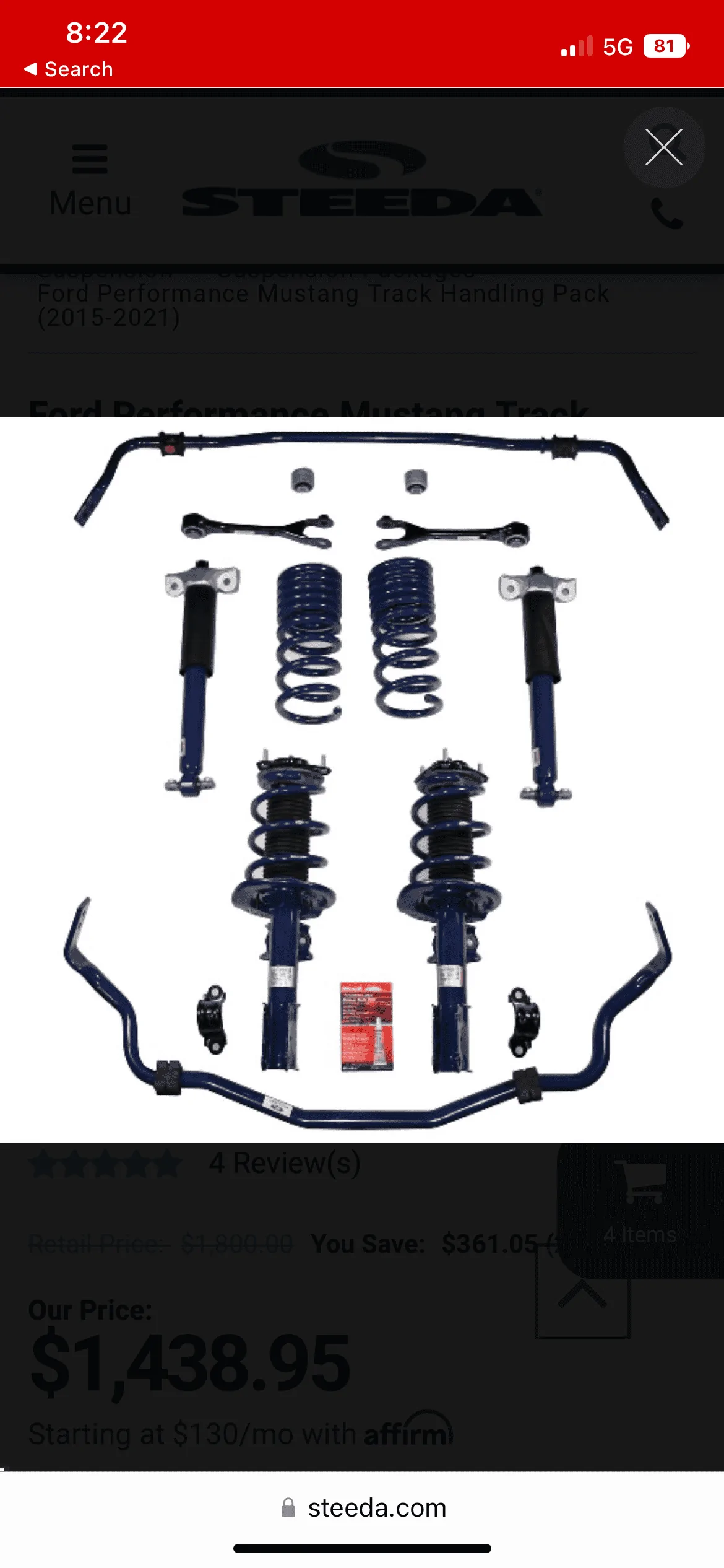

What are your thoughts on the ford performance track pack? I already have the Steeda front and rear sway bars so I don’t need the fp bars. I would assume ford would make the kit ready to install
shogun32
Feb 8, 2019
92
16,223
14,019
Northern VA
it gets the nod from most people from a spring rate, drop, and damper performance perspective. I don't know what they do about the bump stops. Regardless, cut them back.
