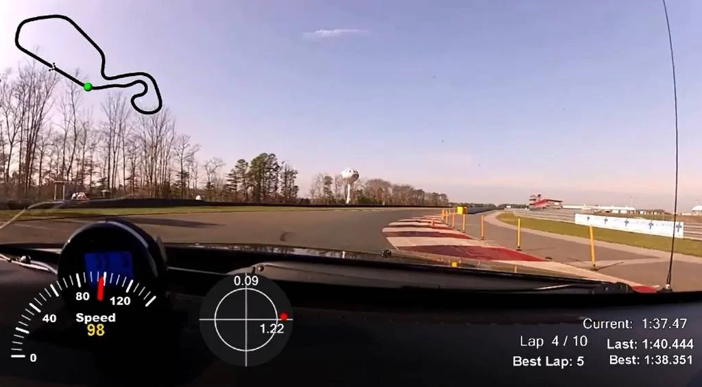

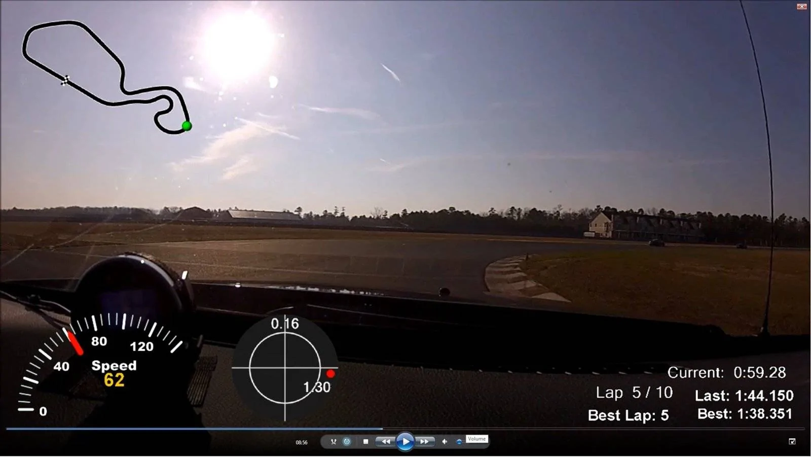

If I'm fighting the steering in a corner it means I screwed up.
I was just driving the corners in these shots, no fighting the wheel or the car, no seat-puckering, just turning the wheel over and back out again like I might during a brisk-paced drive out in the country but still a good bit shy of "race pace". Street driving should be at g's half these or less, but even at the 2/3 level you should not have to be working very hard to make it happen and keep it smooth.
