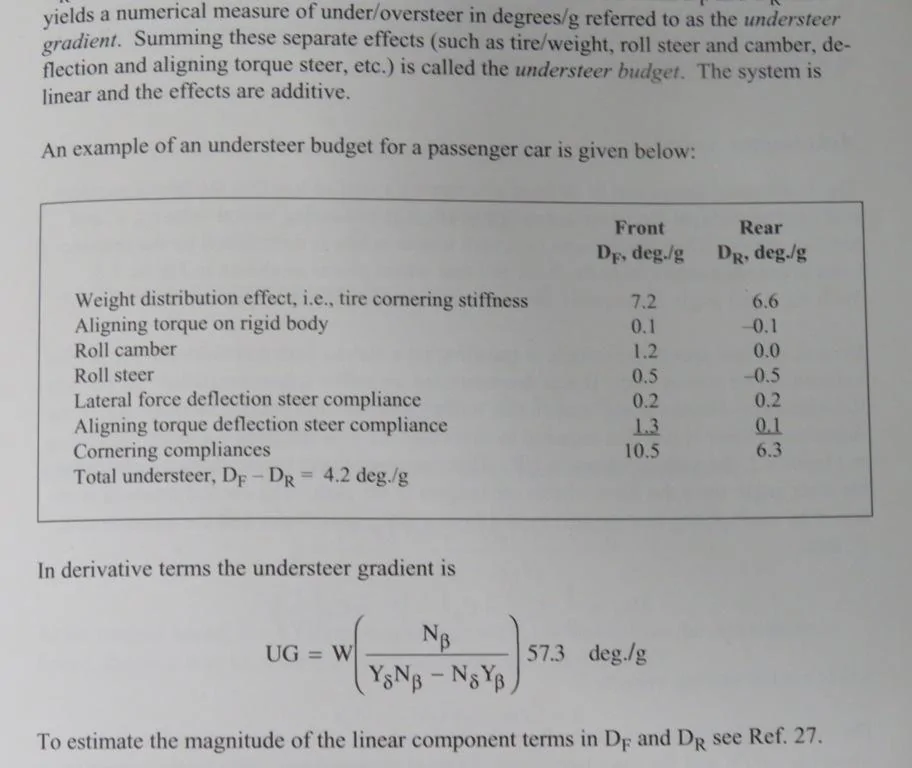

To the best of my knowledge, understeer is still best quantified in terms of an "understeer budget", which can either be a positive number (for "understeer") or a negative one ("oversteer"). This isn't a percentage thing; it's a comparison of the totals of a number of cornering compliances (front minus rear) and ends up being expressed in degrees per g.
Straight out of RCVD
It's probably best to assume that most or all of the individual terms are themselves somewhat variable over the range of cornering g's. IOW, not the same numbers or even numbers in the same proportions at 1.0g as at 0.25g.
