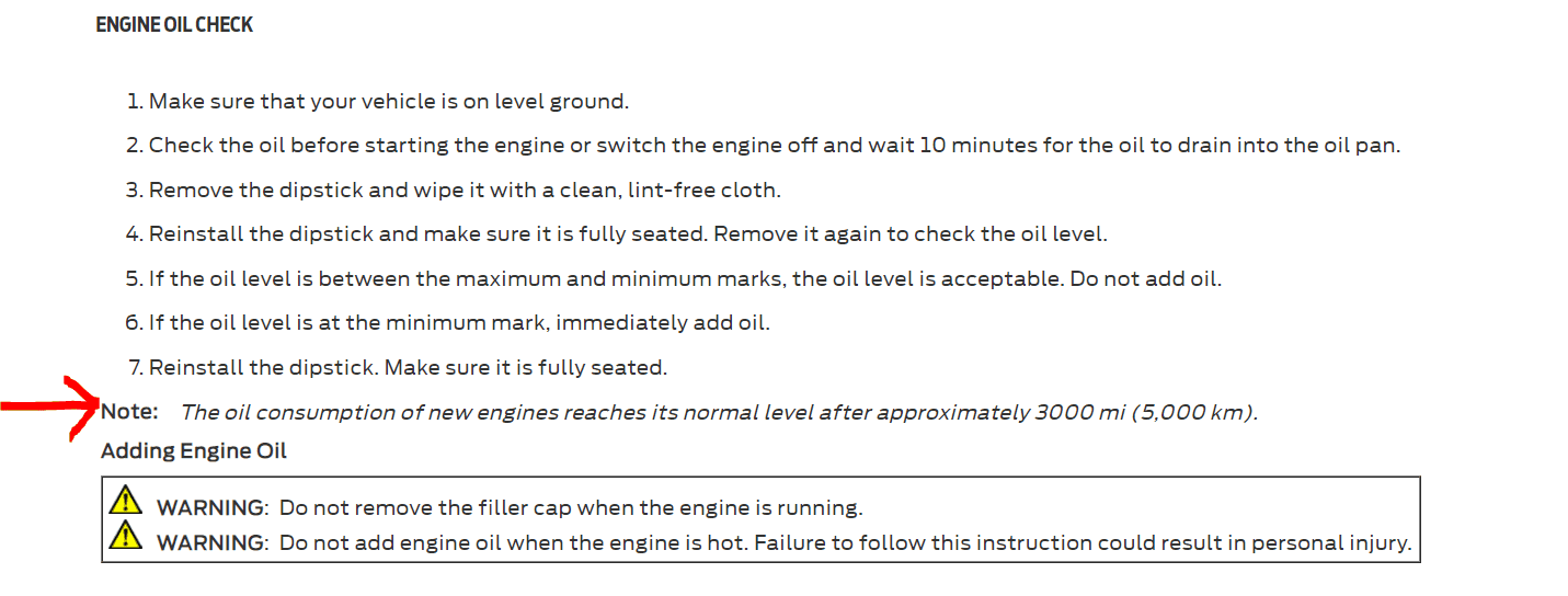

You have 600 miles on the car total? Per owners manual its normal to burn more oil than normal until you reach aprox 3K miles. I would not worry about it, keep driving it and monitor oil level.
How much oil is it burning? Are we talking multiple quarts within 1K miles?
Sorry but there is a big difference between using a bit of oil and burning oil to the point that you have blue smoke coming out of the pipes
Not normal at all, regardless of the mileage
And the break in period on which you could use more oil than normal involves the sealing of the rings on the cylinders walls, not the valves guide seals that seems to be the issue here
Obviously the engine having be highly modified, the issue could also be with install and having to much oil drawn in the intake manifold

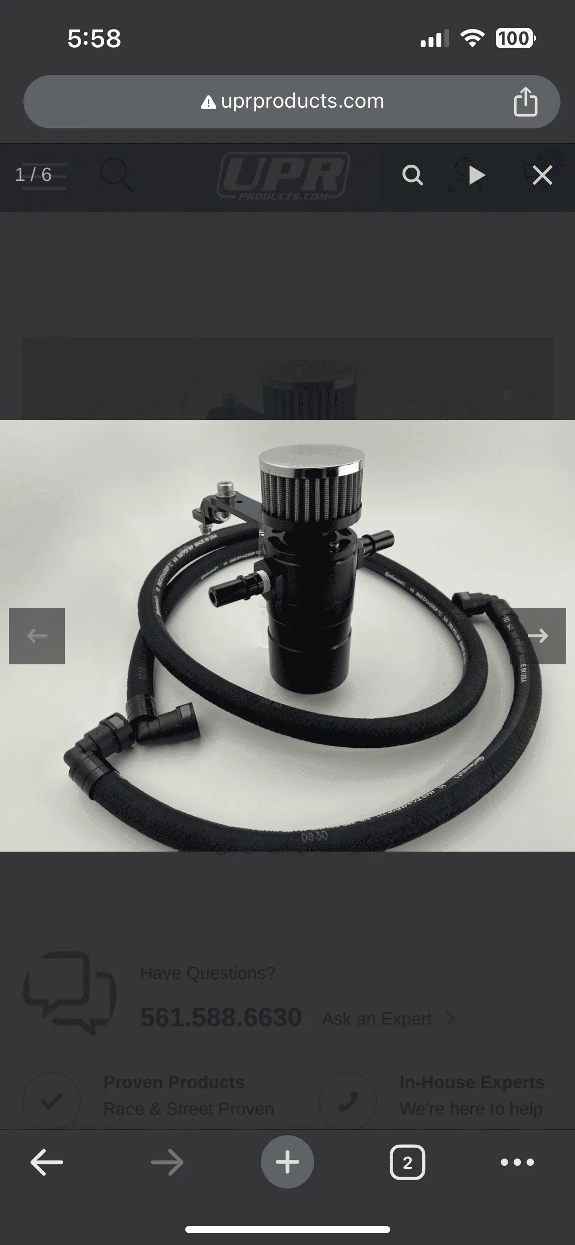

Yea I had thought about how oil would be getting into the intake manifold. Like if I didn’t put it back together right and missed something? It all started after I put all mods on witch I did all at once. My PCV goes from both valve covers to a catch can that vents to atmosphere. Then I have the filtered breather for the oil cap. Then the old pvc port by throttle body is capped.

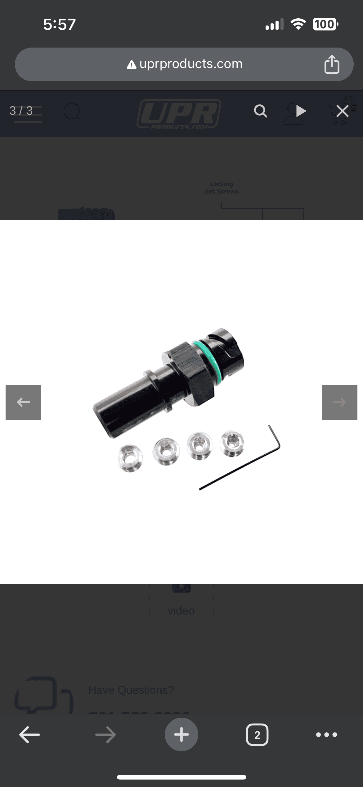

Whose catch can and exactly how is it vented to atmosphere ?
Is your OEM PCV valve gutted ?
