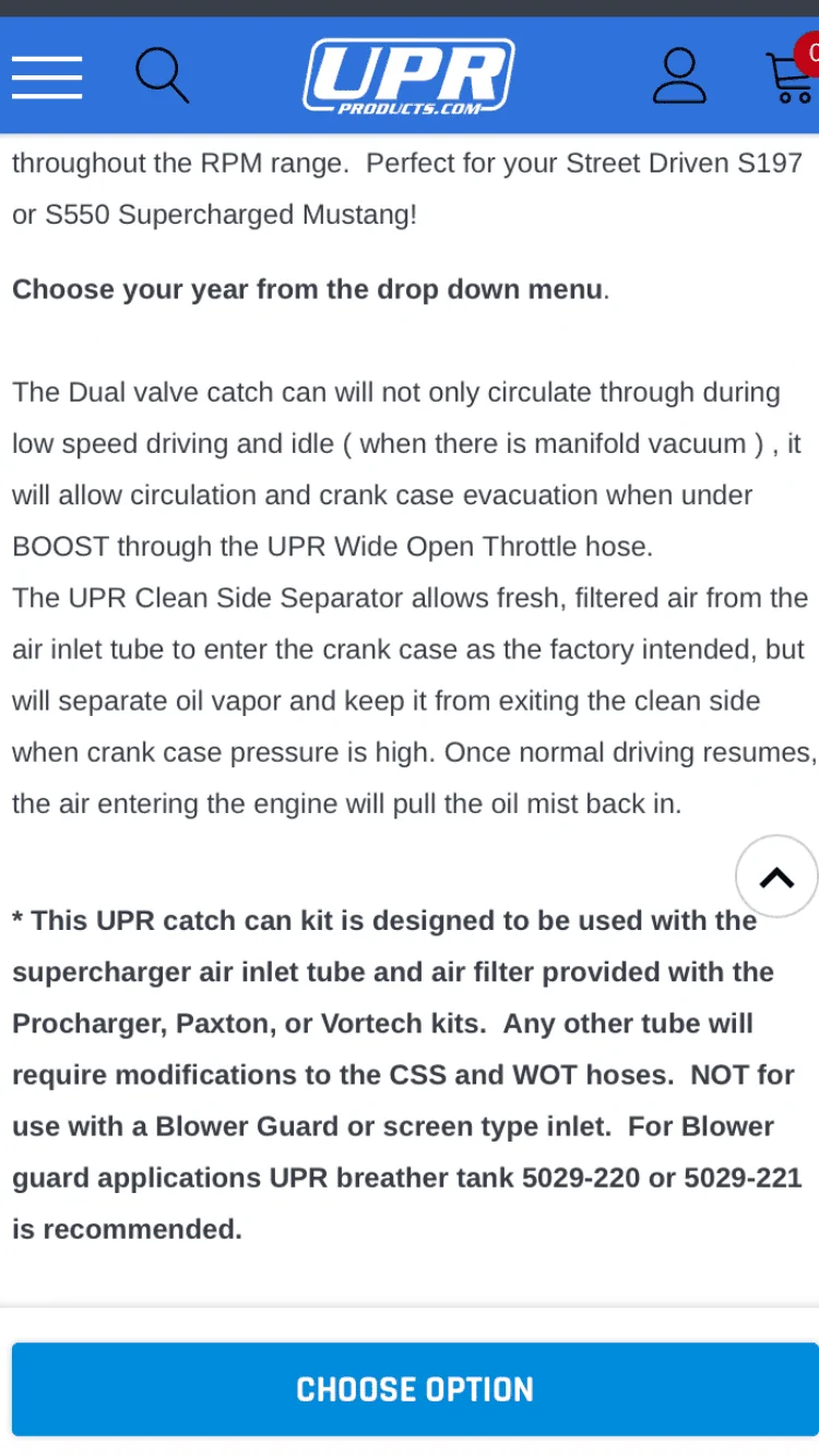

I contacted UPR and they said I have the correct system for my setup and it’s not an issue.
It’s interesting, UPR offers a kit specifically for the Procharger other than the one you’re currently using.
Is there no advantage to the dual valve catch can.
Mine is an option for those who have screens and no intake tube. I just know I didn’t want any vapor in the intake with e85. UPR said both have their benefits. The open system will smell like e85 and steam out the can sometimes. Witch mine does.

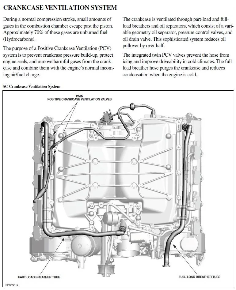

Explain to me everything that’s wrong in the link on post #52.
You have my attention, please back it up with references.
BTW, I own a Supercharger V8 5.0 Range Rover not a “Chrysler Pacifica”. The JLR SC 5.0 comes factory equipped with composite cam covers with built in dual diaphragm PCV valves, oil separator baffles with part load / full load circuits.
Explain to me how JLR Ef’ed up the 5.0 V8 PD Supercharged PCV Close Crankcase system.
For reference my 80k mile SC 5.0 RRS loses less than 1 Pint between 10k OCI.
Your comment about measurable oil loss due to the dynamics of forced induction is flawed.
