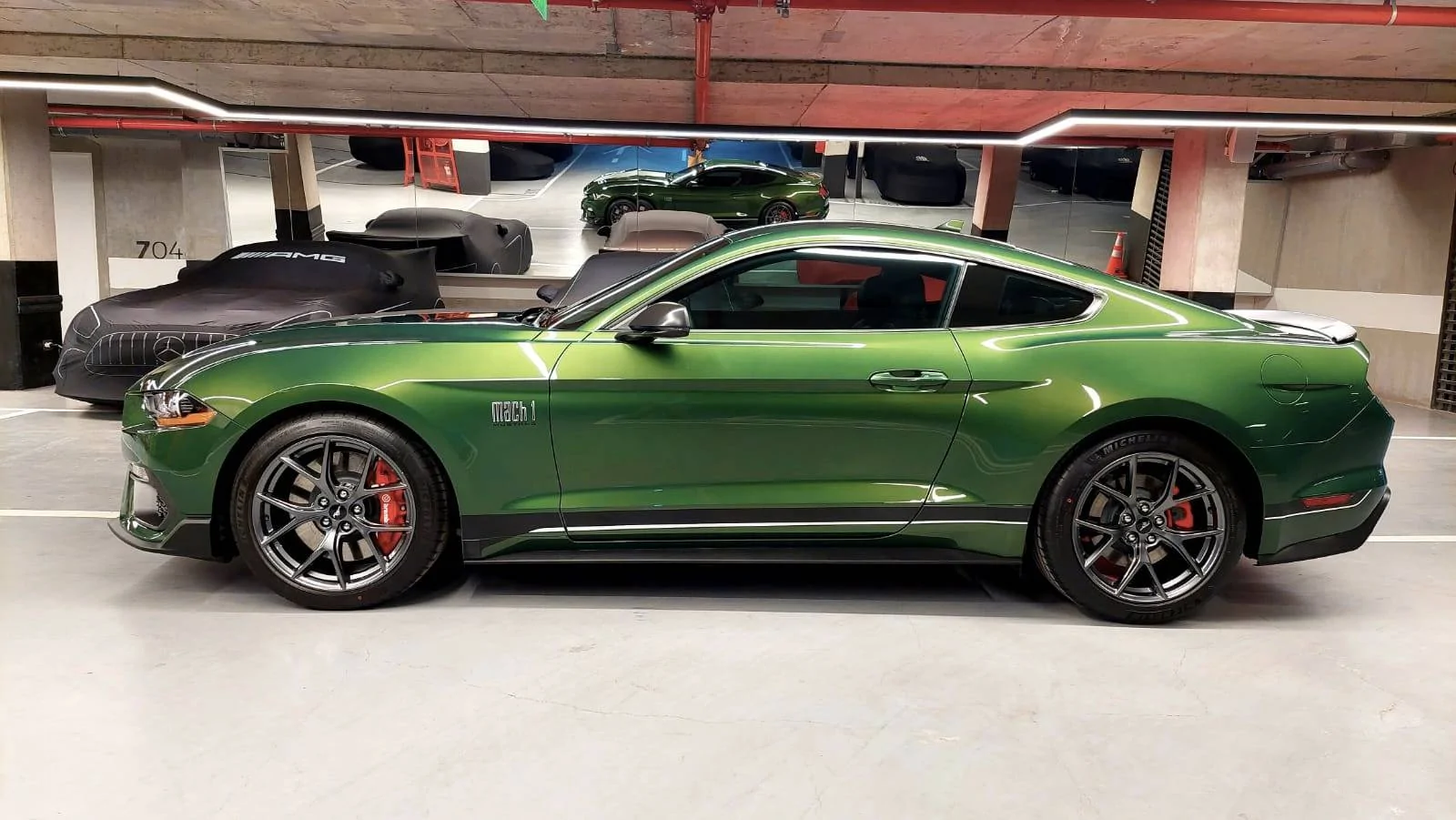

2 of my favorite colors. That Eruption would be hard to cover-up for me.

Glad you got it fixed. That green is awesome, not sure I would have covered that up either.

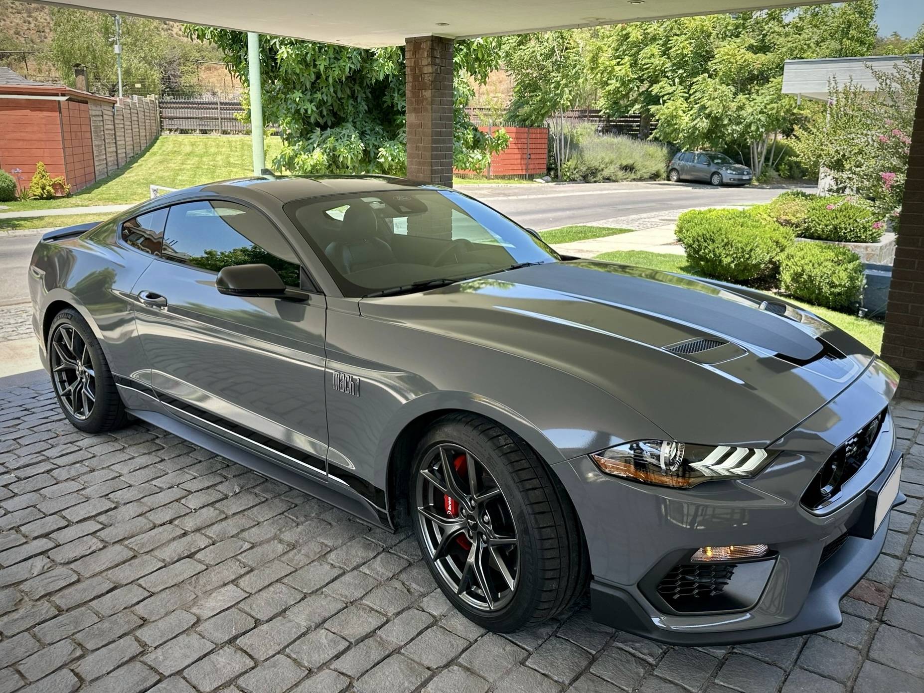

The grey wrap looks great, but the original green is pretty marvelous, too. Probably made your car very recognizable. I once had a bright yellow Eclipse, which I loved - color and everything. However, I did get tired of people telling me they saw me everywhere... I felt like I couldn't go anywhere without being spotted! Don't know if you had that issue, but if you did, I can totally understand the color change. Or, maybe you just like changing things up... either way, cool car!
