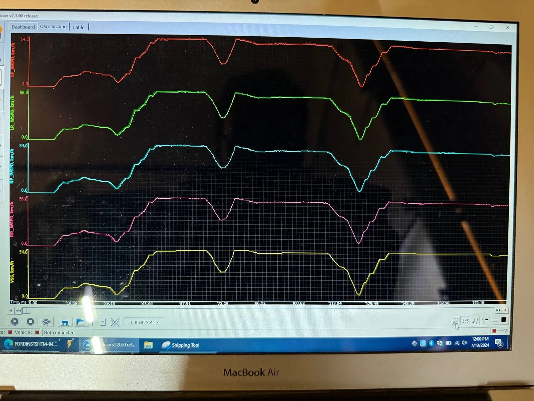

Anytime you get the Christmas tree but the car still runs normal, the first thing to check is the wheel speed sensors. Forscan can display each individually plus VSS. Anyone modding their car should have access to Forscan with how cheap it is to just get an adapter.
