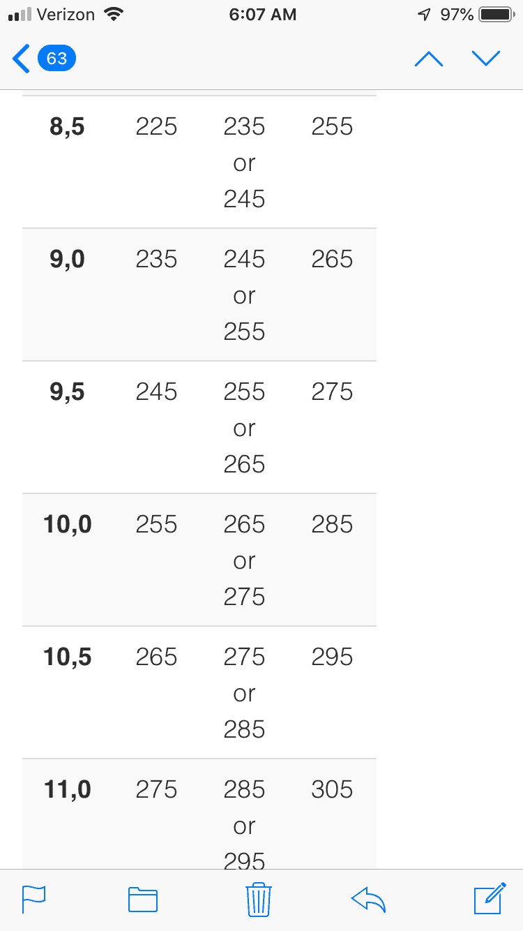

As for winter tires, no one responded when I asked about winter tires for the PP2. I looked to see what is the smallest tire listed that would fit the stock rims and checked with the retailer. Tire rack and discount tire said a 275/35R19 would fit so I grabbed a set of Blizzaks LM-32. Have them sitting in my garage waiting for colder weather. Personally, the Cup2 are rather lousy in rain too. Can’t wait for colder temps so I can switch. Wet, the Cup2 are sort of ok but any kind of standing water and you will hydroplane. Also, go slow until they warm up. Every morning I spin them when the temps are dropping a bit in the mornings and I do the Formula 1 weaving left and right warm them up( and have some fun too). When I see the tire pressure on the display go up a pound or two they get stickier and behave better.

My plan is to purchase the SVE PP2 wheelset when they are back in stock (December 2019, according to the website). But until then, I will need to have these installed on the stock (10.5 inches wide front, 11 inches wide rears) wheels. So I need tires NOW, that would fit both the stock and the SVE PP2 wheelset.
Question 1: Should I get 4 x 10 inch wheels or do staggered? 10 for the front and 11 for the back?
Question 2: Based on question 1, I need to buy winter tires immediately that will fit both the stock wheels the PP2 comes with (10.5 inches wide front, and 11 inches wide rear) and the SVE wheels above.

Any change from stock over 3% could be corrected via programming but I have no knowledge on where or how to do it. It was what I have read can be done.
The 275/35 that I got are the lower limit on the 19”x11” stock rear wheels. The front can go possibly to 265 but why go staggered when the car was made for square. That is up to you. I have not mounted mine since I will, for now, use the stock rims. From what I saw online, this is the possible size tires based on rim sizing
Thank you. It looks like you did your homework, so I will go with the 275/35's also for winter. When I buy the aftermarket wheels from SVE, should I go with 10 inch wheels for the front and 11 inch wheels for the rears, or do 10 inch wheels all around? So it looks like 275/35's will fit both the stock wheels and SVE aftermarkets? Thank you for your response.
