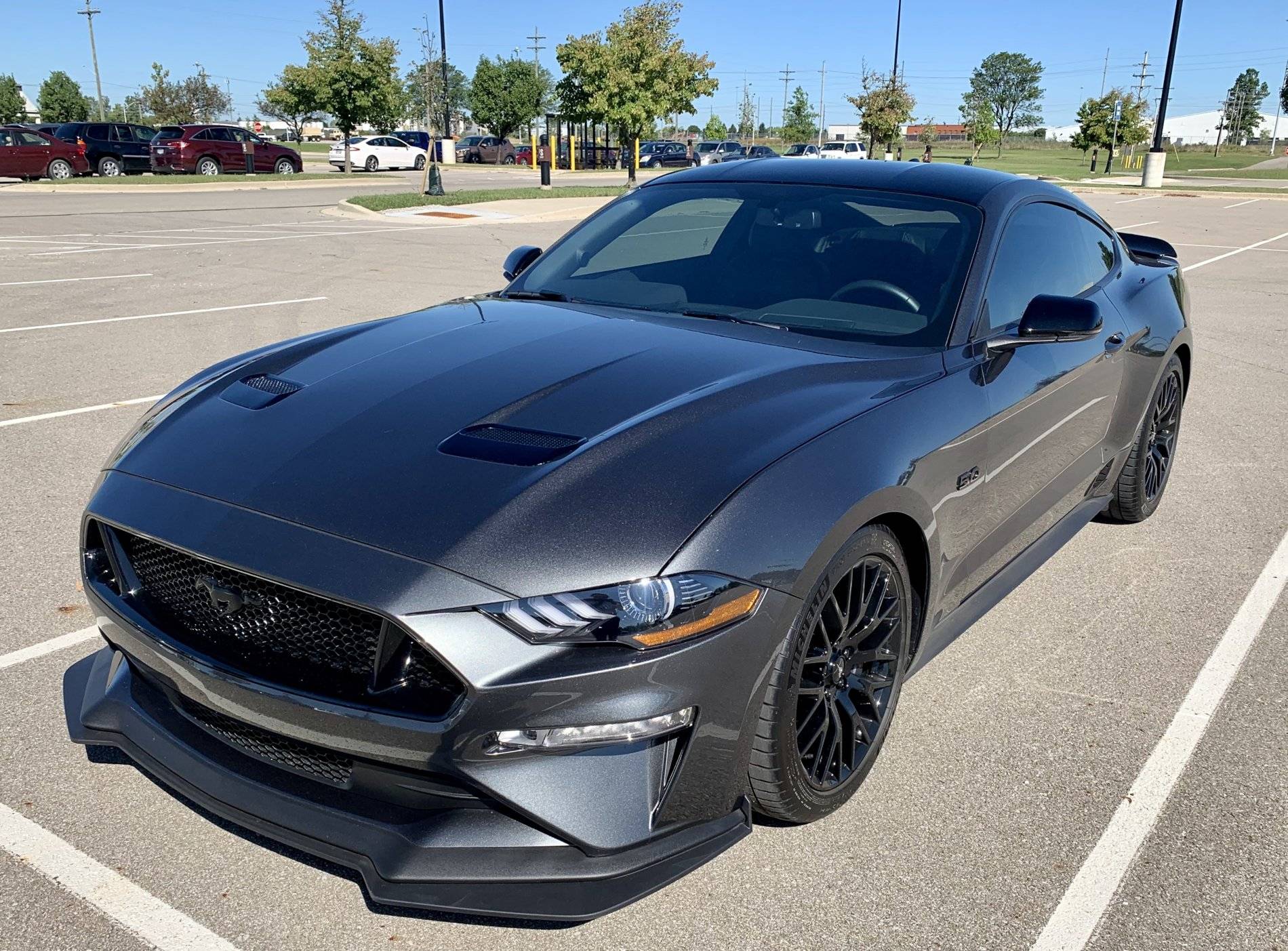

2019 Mustang GT Premium PP2 Magnet Grey
I thought hard about getting a PP1 with the A10, and MagneRide, and then adding the Ford racing MagneRide springs, sway bars and the tune for the MagneRide, along with the PP2 front splitter, and calling it done. In the end though, it made more sense to just get a PP2 and relearn how to shift gears. Automatics are so much more efficient though.
