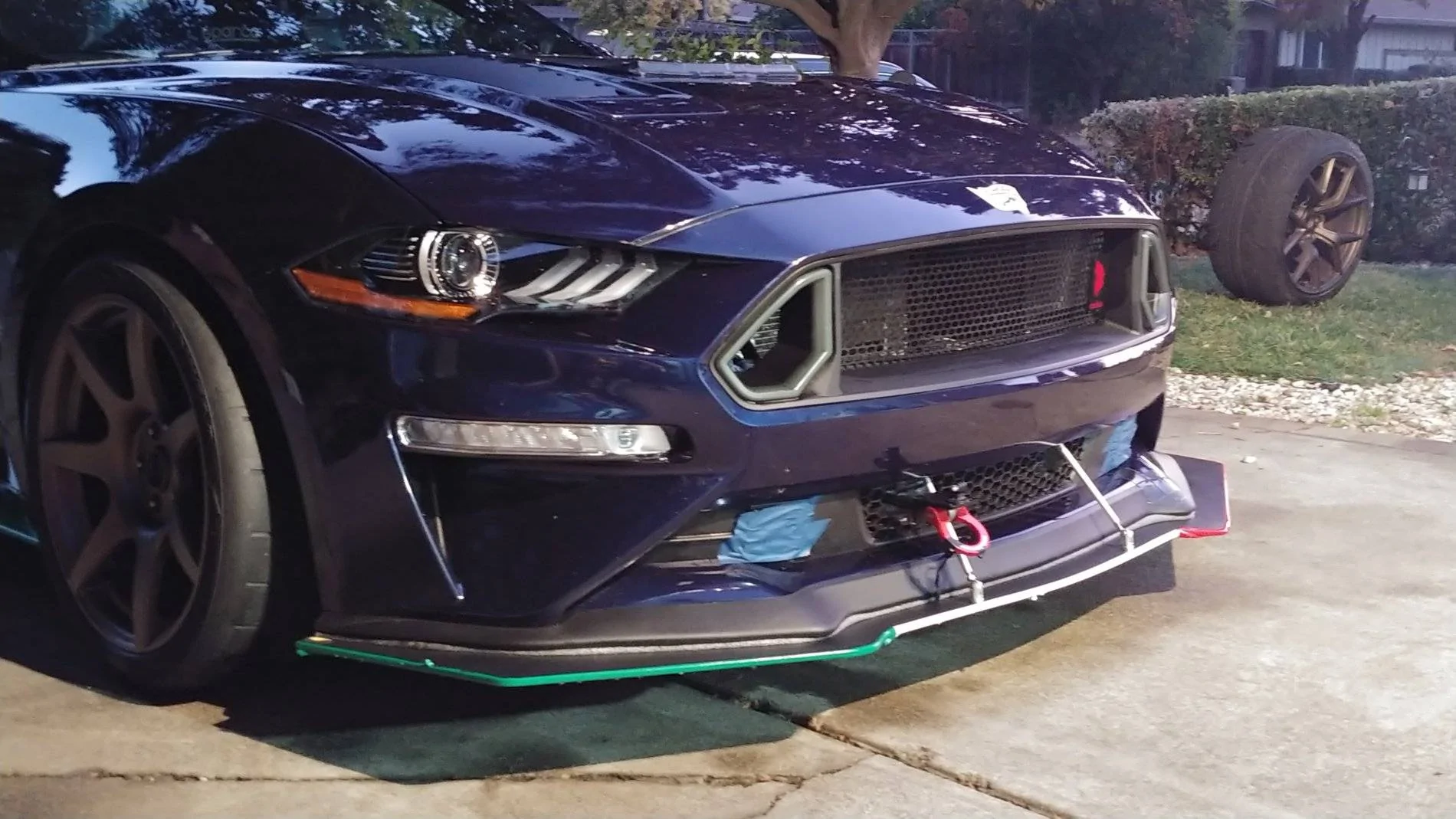

I had a GT-350 track pack spoiler on my PP1. I had to drill for it. The template with the official Ford spoiler is great, but major pucker factor drilling 9 holes in a pristine deck lid.
The track pack spoiler is WAY more aggressive than the PP2 spoiler. I like my PP2 spoiler appearance, but would probably go track pack if I was starting from scratch. It's probably safe to assume there's 1 hole pattern for all spoilers, but I don't know anyone whose removed a PP2.
I had the dealer change the Cup 2 tires to P4S before delivery and I'm very happy with them.I added front Rok Blokz for a little more protection. There's a lot of poke on the PP2 setup.
There are PP2 owners running mag ride lowering springs without any problems.
Every stock ford spoiler uses the exact same hole pattern.

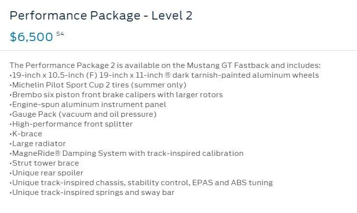

From Ford:
From this https://www.roadandtrack.com/new-ca...708/ford-mustang-performance-pack-two-review/ R&T article:
The resulting Performance Package Two, or PP2, is available only on Mustang GT coupes with the six- speed manual. The tires are Michelin Pilot Sport Cup 2s, 305/30/ZR-19 all around, which become bubblegum on the bottom of a shoe in the right conditions. MagneRide adaptive dampers—previously offered only on the GT350 and now optional on other 2018 Mustang variants—are standard on the PP2 and have been retuned. The front and rear anti-roll bars are stiffer by 12 and 67 percent, respectively, compared with the PP1, and the front and rear springs are 20 and 13 percent stiffer. These changes were all intended to make the Mustang corner flatter, deliver wicked turn-in, and make it a ton of fun on back roads.
I've never seen anything indicating the springs are the same as PP1.

From Ford:
There’s absolutely nothing in what you posted that says the PP2 comes with different springs than the PP1. The list clearly does not list that as an upgraded option which would translate to the PP2 having the same springs as the PP1. The only things it says is that the magniride is calibrated differently which has nothing to do with springs, Ford never stated the springs were stiffer or upgraded. And regardless my original statement still goes on the fact that they aren’t the lowering springs made by Ford performance which are still the best springs to put on the car which are the same that the R comes with.
"UNIQUE track inspired springs and sway bar"
Please post your PP1 spring code and we'll have the answer.

I
I said it in multiple posts. The car doesn’t come with the Ford Performance Lowering springs that the R comes with. When it comes to “stiffer” springs I have never seen any actual literature from ford that says that. It’s possible they are stiffer. I might be incorrect. But what I said in the previous post is the car is not lower. The springs are not the ford performance ones on the R.
