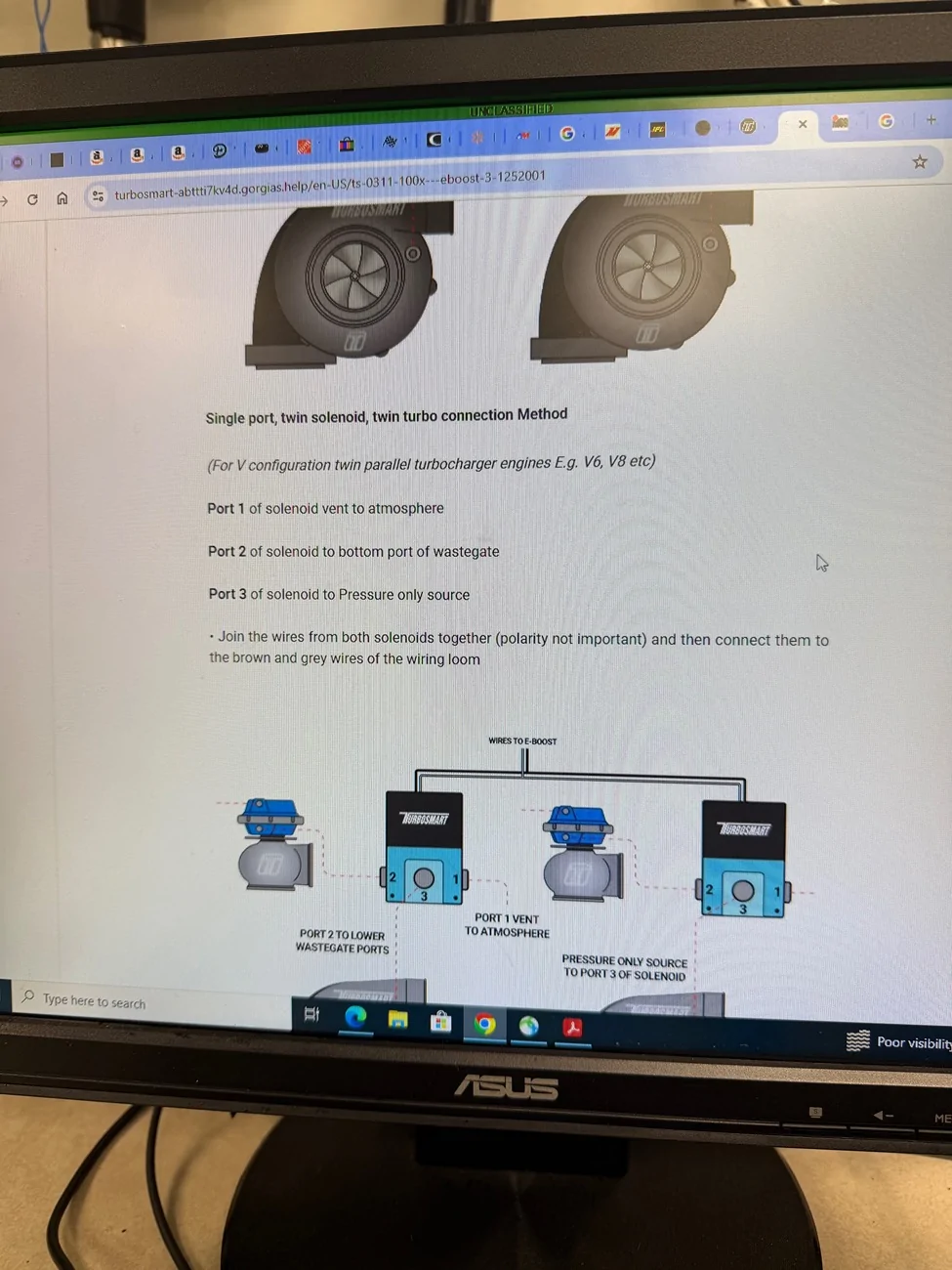

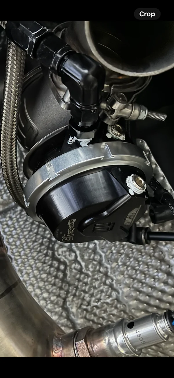

Give me a couple seconds but I’m running my plumbing like this I have the top ports of my wastegate venting to the atmosphere I have them bare though no silicone tubing hanging from them and have the bottom ones connecting to the solenoid.
Jeez you have two Mac valves. Did you plug the other one? That doesn’t have a port going to a gate?
I’ll check the instructions I think I can pull them up.

I did actually I have 4 ports on each wastegate I plugged the two on each wastegate and just used the other two I’ll show you what I mean in a second

It’s eboost3
When did the eboost3 come out? I knew they were working on it a while back. I saw a short video of it back then. Had I known they were coming out with to the EB3, I wouldn’t have bought the EB2.
The good news is they say the wiring is the same, so it’ll be as simple as unplugging and swapping them out.

I hooked it up the polarity doesn’t matter for the wires

So both port 1’s to atomosphere
both port 2 to fitting on turbo
and both port 3 to bottom of gate
looks simple.
did you check the gates for any open unplugged fittings? And did you wrap each fitting with teflon tape?
I had a fitting loose on my blow off valve and it caused the car not to start also. I think you gotta smoke test the car.
just to be safe . See attached photo
