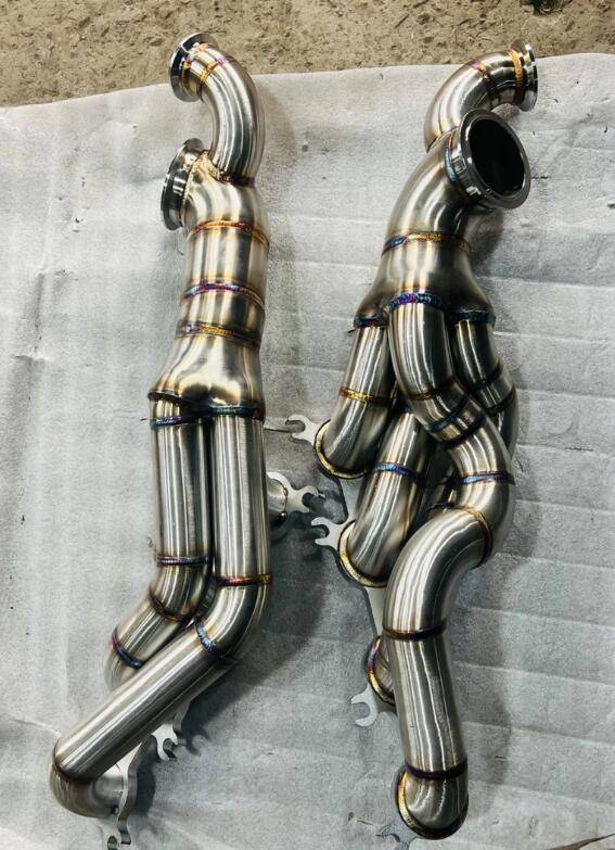

Honestly if I could I'd just piece together my own kit. I'd run On3 vband exhaust manifold that looks amazing.
Like i don't care if these fit bad or not that's just pure freaking awesome and it's nice you get rid of that 2" choke point on the Hellions
I'd probably keep waste gates dumping open like Hellion does and get a custom downpipe made so I'm not dealing with any fitment issues like the ON3 is notorious for. I'd run an electric scavenge pump from turbowerx basic one to keep it simple. Run my own scavenge tank from SBP vented. Run a pair of GT3582R's with v band housing. I like that On3 uses larger waste gates. I would use a mitter saw with carbide blade cut the piping to make mock ups of the charge pipes and take them to the machine shop down the street to get them welded. I would hook up HKS SQV4's onto the pipes because I just love how they sound. The intercooler brackets you can make easy it's nothing special. It's literally a 90 degree straight piece of metal with two 90 degree brackets. The intercooler I'd just run Hellions with hellion intake charge pipe. All fittings and oil lines you can make with kits from Evil Energy. Check valves are easy to get. UPR makes the oil cap return fitting and just run that to an AN 8 return line from the check valve after the turbowerx pump. Just follow instructions from hellion kits to run vacuum for the BOV's. Then run a open atmosphere catch can for the crank case breathers.
Boom you got a badass custom kit.
