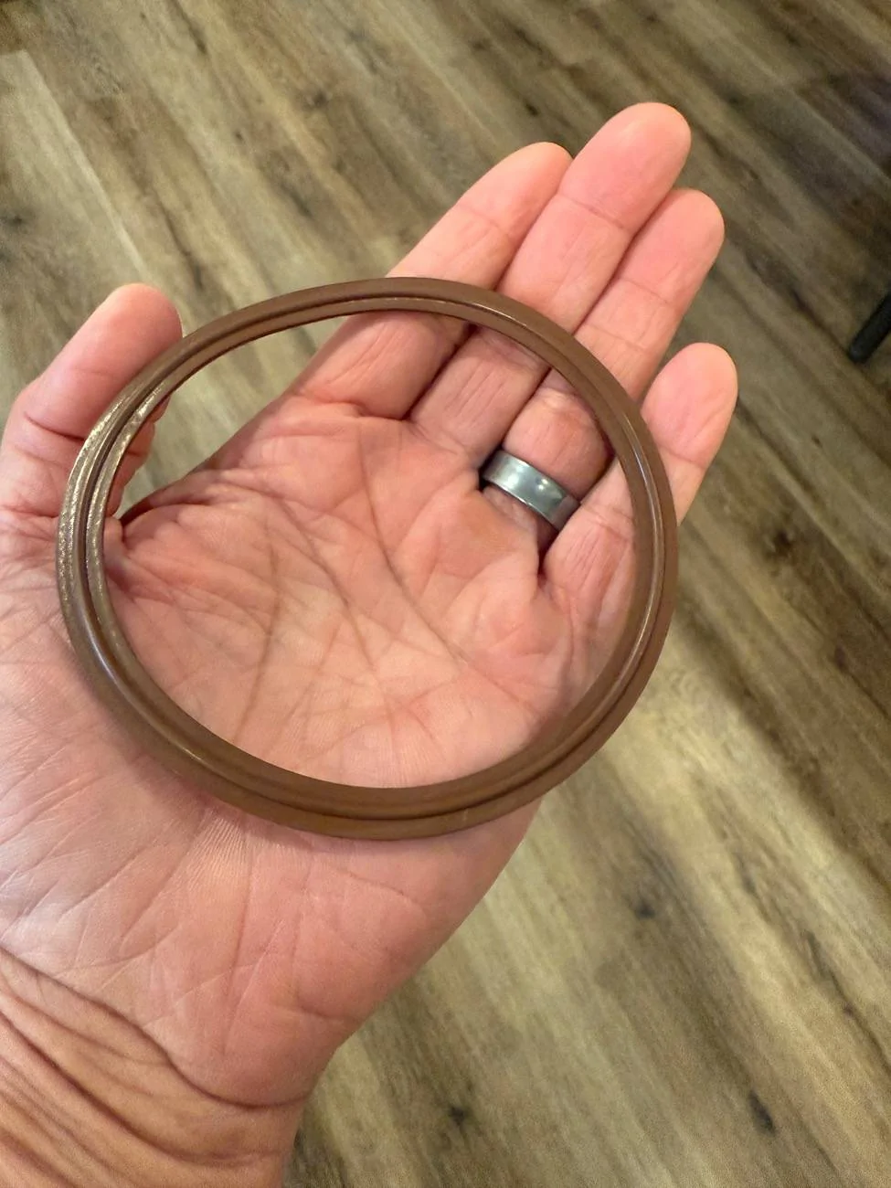

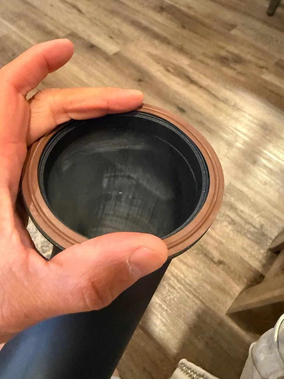

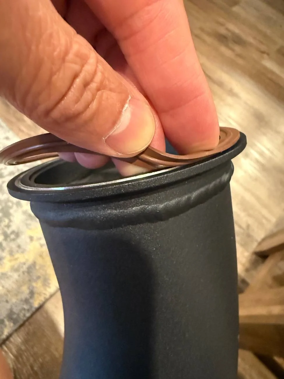

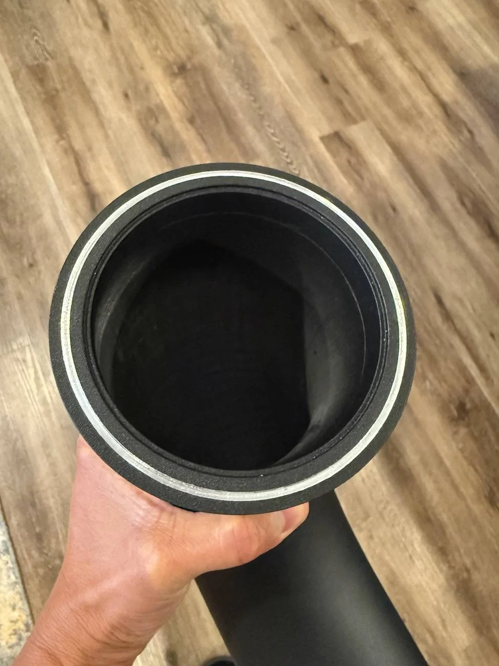

@Vandor are your charge pipe and compressor flanges v-band or are they connected via a silicone coupler?
Mine are v-band flanges, but I was struggling with trying to figure out how I would seal them using 3.5” Viton o-ring gaskets that are supposed to seat into a channel cut into the charge pipe flange. It appeared to me that the flange had been inadvertently coated, thus filling up the o-ring groove and creating a fitment issue.
Yesterday. I ended up cleaning the powder coating out of that channel in the charge pipe and now the gasket will fit. The next challenge will be keeping it in place once I go to mate it to the compressor flange. I’m thinking some Permatex High Tack silicone o-ring safe spray.
I’ve read a little bit about copper gaskets being recommended for the header to hot side flanges, so I’m trying to sort out as much of this as possible and come up with a solid plan before installation time.
How will you guys will approach those portions of the install to ensure no leaks?

They're all Silicone Adapters. O

They're all silicone adapters with t bolt clamps. I was able to get them all for pretty cheap online. I also cancelled my order with Arashi and just picked up dual boostlabs 6262RS turbos to replace the hellion ones. Boostlabs has a moving sale right now and I got both for pretty cheap. I also like that the boostlabs turbos come ceramic coated and (if you go journal bearing) they're only oil cooled no water needed. they come with a warranty and it's an American company on top of that.
