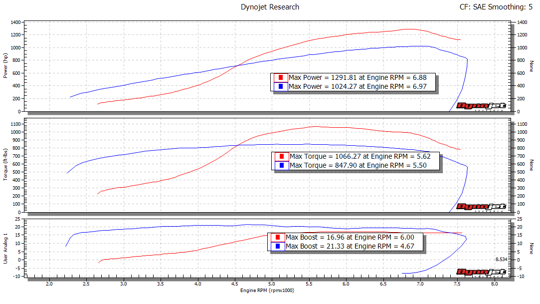

Hello. We would never try to insult anyone here. We love the community and have been building and testing systems for over 15 years. We understand that this seems excessive to some on this forum, but this is the reality of twin turbo vs. supercharger. Superchargers take A LOT of power to turn. That equals lost RWHP. See below a comparison of the same car with 21 psi with the supercharger vs. the same 16 psi pull with the Hellion street sleeper...same dyno...same tuner...same elevation etc. Just simply a swap from a twin screw to a Twin turbo. In fact, the supercharger had 23 degrees of timing to the 21 for the turbo.
A majority of our sales are from "underwhelmed" customers who are taking the supercharger off to replace it with our kit. We are just being transparent to insure our customers are informed and make the correct choice :)
10 years ago the older modular engines could not live and take the power that the new engines can, so a small blower was ok....That is not the case anymore, its time to feed these new coyotes the air they can handle!!!
The sleeper kit has been very popular and we are sure you will see more graphs from others very soon.

What problem did you see? This customer bought the kit right from us with a cost of $6395. He already had a built motor, injectors, and fuel system. After an install at The Dyno Edge it went straight to on the dyno and he is daily driving it now.

What supercharger? over pulley'd excesive intake inlet temps?
Without isolating any certain company, we can just say it is a very common unit spoken about in this forum.

I think I saw a video of vmp cracking over 1k h/p with their mustang with the gen3.... may have been more? maybe the gen3 wasn't properly tuned on yalls dyno?

This vehicle was tuned by Chris Groves at The Dyno Edge with both combinations. The customer had purchased the original supercharger and spent hours upon hours on the dyno trying to refine it. In the end the swap to a Street Seeper kit is what was needed to made this big gain.

Ok. Ignoring the snarky snide comments, School me on this.
Boost value Ian a function of restriction, correct? When my old R Trim made 26 lbs of boost and then I had my heads reported and custom intake, my boost with the same set up went to 18, but now the car went much quicker and gained 7 mph in the quarter. I reduced the restriction- my boost pressure went down.
But, on the same engine with the exact same boost, how does the flow increase if the restrictions are the exact same? I’m a medical guy... let’s say your blood pressure is 120/80. Perfect. Now you’re a little overweight etc and it goes to 140/90. Is the volume pumping the same? It may be a volume issue itself - too much volume causing the BP to rise and your MD gives you a diuretic to relive some volume of fluid to reduce the pressure. In these examples, the flow has been the same - the resistance or back pressure or restriction has been the same. So, with the same restrictions, the increased volume caused the increase in pressure (boost #).
Sorry. Long winded for sure! I’m just trying to grasp the concept that the exact same pressure could have a different flow characteristic with the exact same restrictions. In he original example, I’d boost pressure (ie retriction) is the exact same, how could one make 370 more horsepower? Yes, Superchargers take horsepower to spin. Yes IAT will play a roll. But how do you flow that much more air -370 hp worth!- at the same restriction level?
I may not be the smartest here when it comes to this. I dabbled for a LONG time years ago so if you could offer your expertise it would be appreciated. The difference in your personal example could likely have been the increased efficiency in the new turbo not heating the air up as much and providing a cooler charge temperature versus increasing the actual flow of air.
Or am I completely wrong... I could be. If I am. Teach me!!!

The restriction isn't the same though. You've removed the supercharger from the intake path. The supercharger effectively is a restriction. Now you're making 16 psi with turbos through a traditional intake manifold with much less restriction. So therefore you're flowing a lot more air to make the same psi which is where the increase in hp comes from at the same boost levels. That's my thought process anyway.

The supercharger isn't a restriction. The boost # is the pressure after the supercharger. I would venture to say the biggest gain would come from the reduction in parasitic losses.

I would agree. But 370 horsepower worth? To me, that seems like a crazy number! I’d like hear from the experts as far as truly what sort of pumping losses one can really expect from a supercharger.

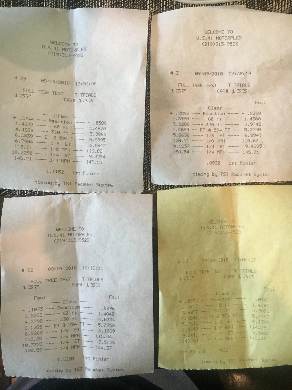

Real world example - Turbo car left lane making 2 psi less then my supercharged car in the right lane. Turbo car trap’d 151mph & some change that day to my best of 147 mph. Same fuel and all other variables very similar. Turbo car makes mo PWR with less boost - end of thread.

SAE correction factor inflates turbo numbers at high altitudes. The topic has been discussed previously...
