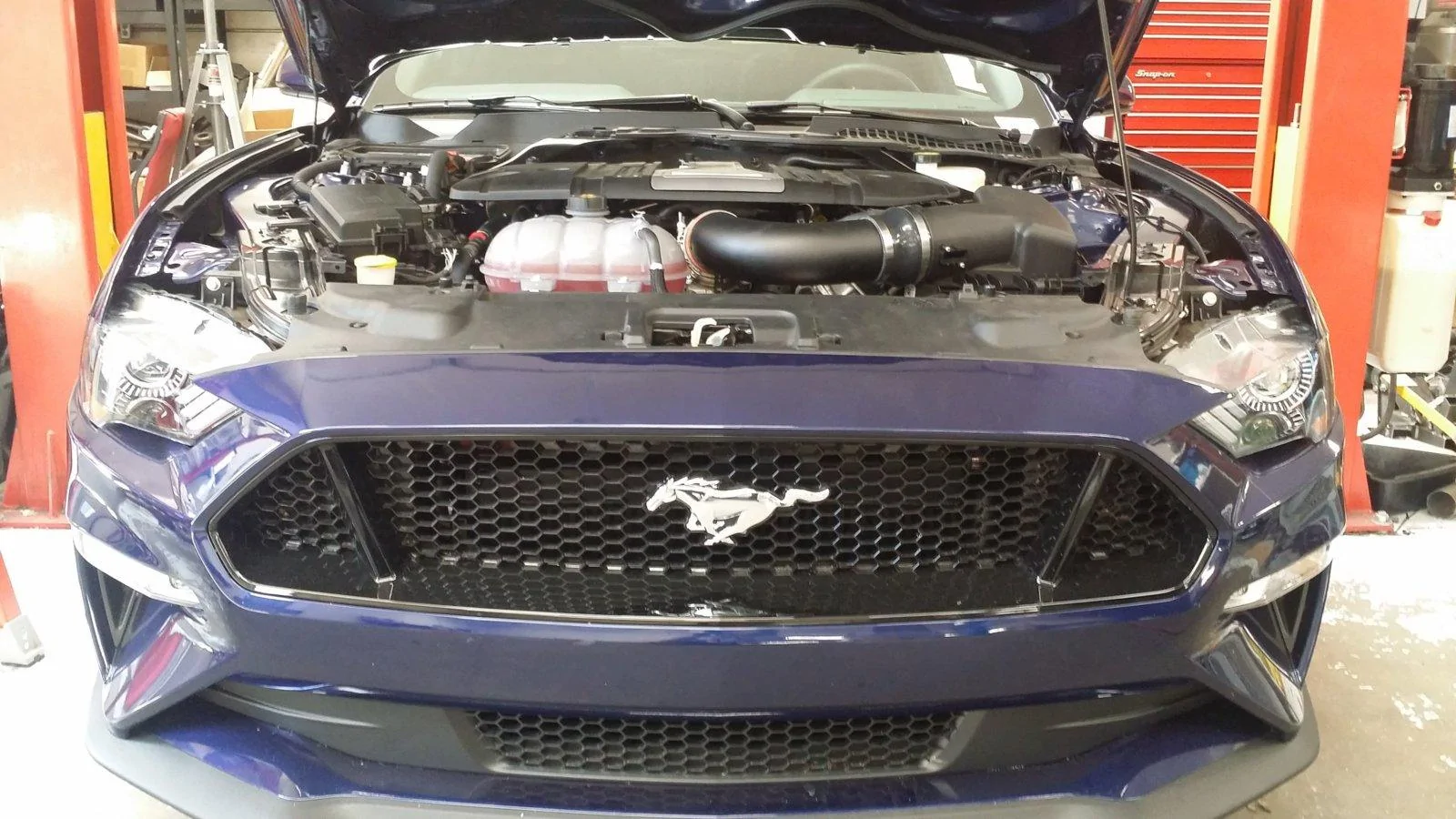

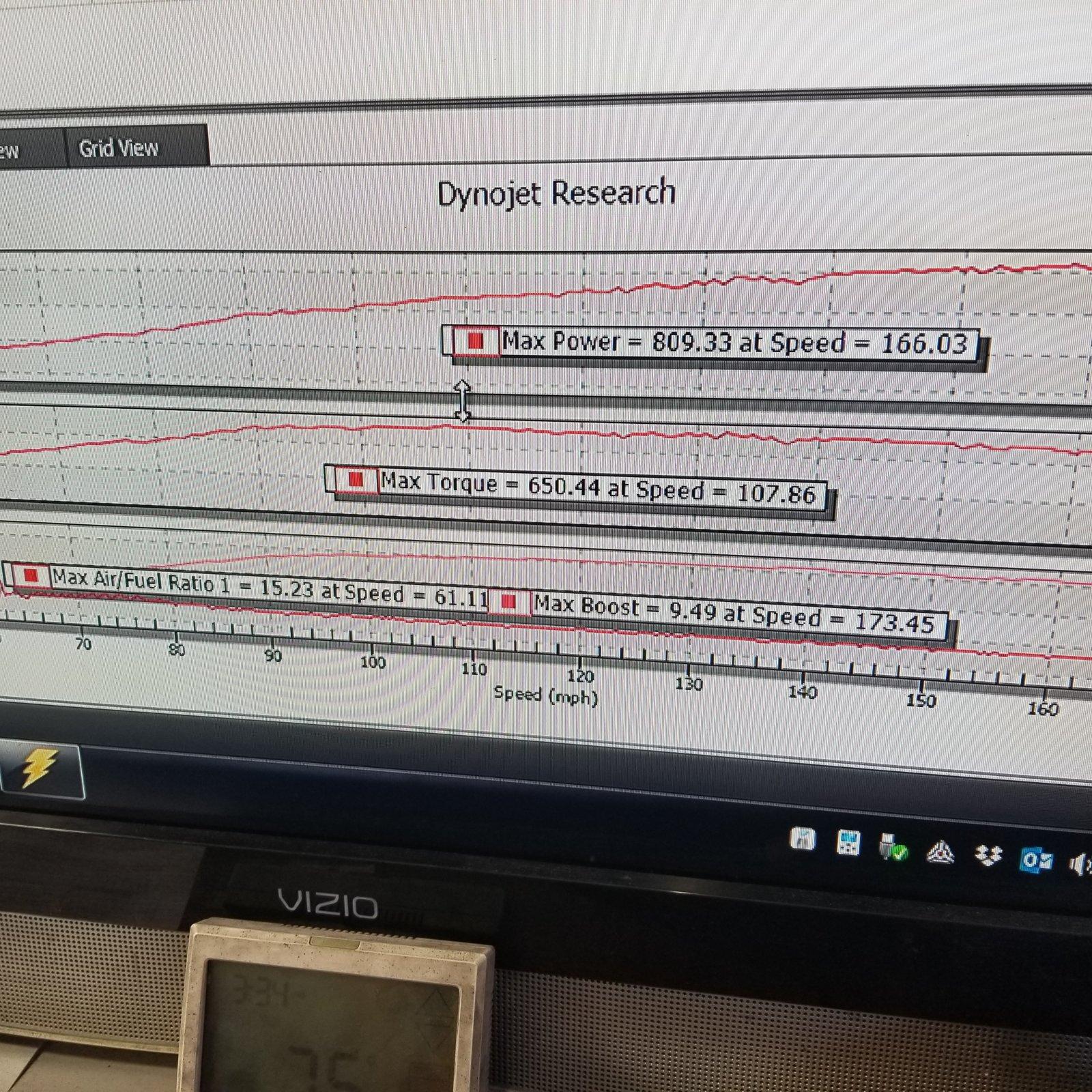

Hey guys, just thought i would share with you my experience with the new Hellion Street Sleeper kit on my 2018 mustang. My car has the base 6266 turbos that come with the kit, i had some DW 95lb injectors and boost activated cutouts installed. Car has the stock fuel system. Had walmart pump 91 octane in it. Ken with palm beach dyno did a base tune on it remotely. This kit drives great!! Now i need to get a fuel system and get it on e85 and up the boost!!

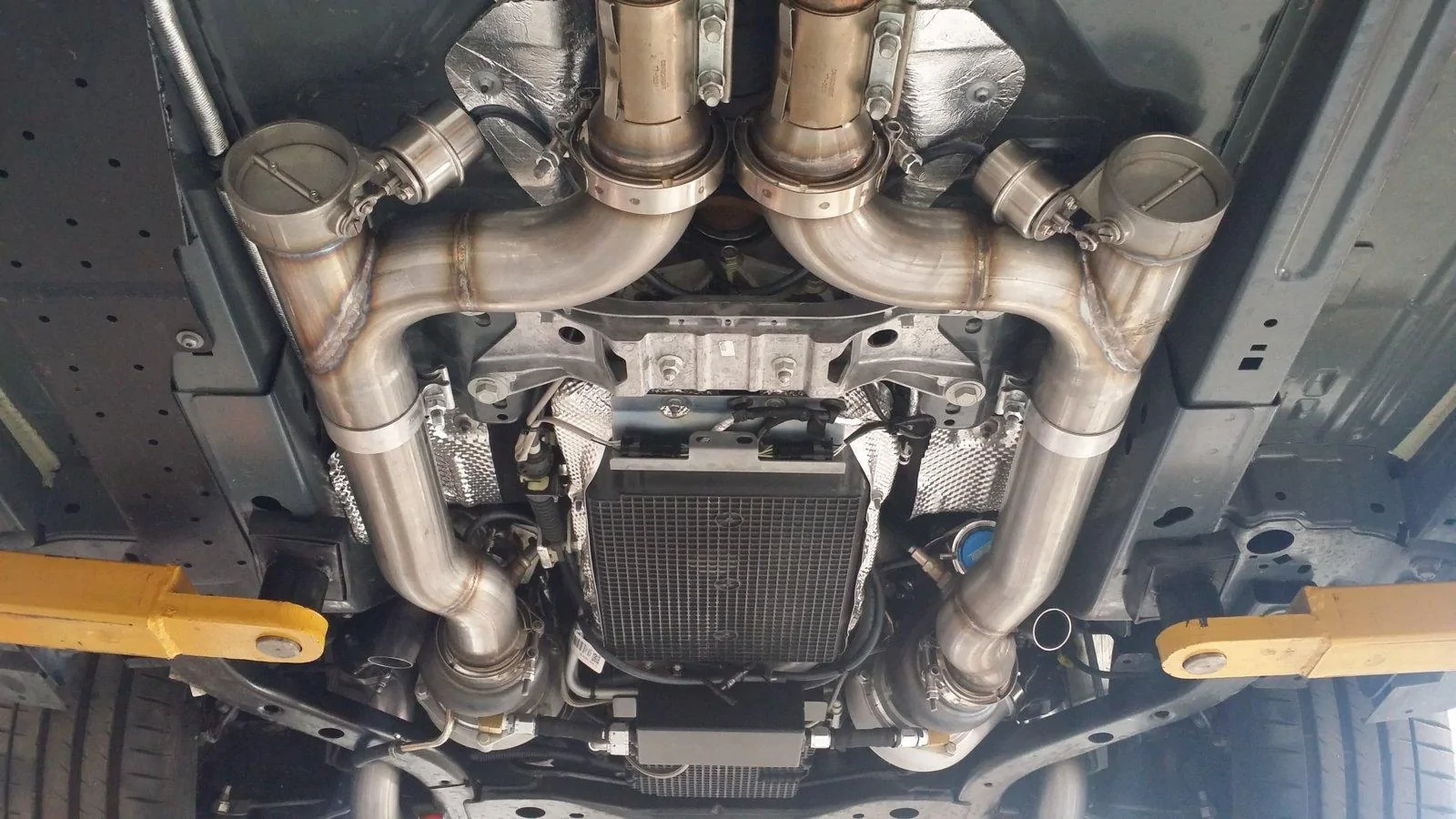

What is that exhaust setup? That's a super clean dump valve location

Stock exhaust, so its very quiet until you get on it and those cutouts open up.

809whp on pump 91 octane? What’s the correction factor out there again?

So much for all the top tier gas station suggestions. Getting 809HP at the wheels on Walmart pump 91, that’s just hard to believe. Wonder what timing was at and how loud the knock sensors were screaming.
I can answer that question for you. Timing was at 13 degrees, and still had zero knock.

809whp on 91 octane on 9.5 psi is pretty nutty. Correction factor and track times will tell the story.

your gonna wanna add extra clamping on the dumps as well... although it looks like a great location, we did something similar on our 2015 vortech car. but....you have to remember, the exhaust is going to take the path of lease resistance.
so, that straight shot is def the path of lease resistance. it will def blow off at some point going wot. without some extra braces clamps welded on the side of the system.
save ya some headache when the car gets stranded down the way... luckily we were at the track with tools when ours blew off

Those dumps should be a hellion option. That's badass.
They are an option!!
We will weld dumps just like seen here for $650.
