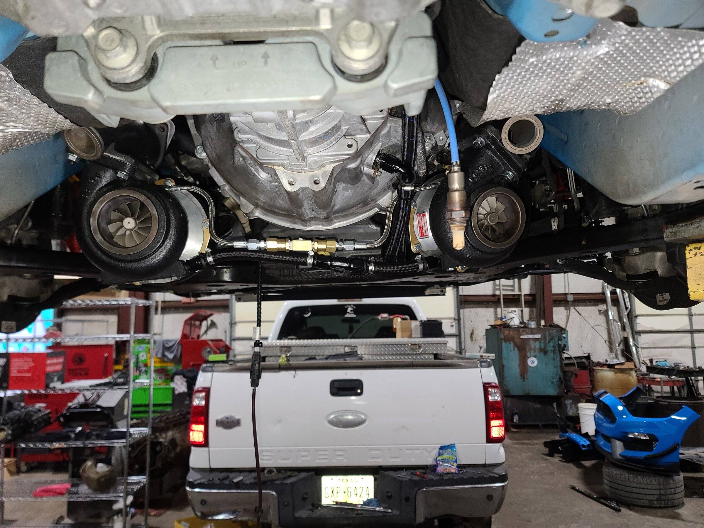

went 68/70 precision you do need to use the oil lines coolant lines are optional on the base turbos
mech94
Mar 30, 2017
224
135
texas
2017 GT350
here's a pic I want to say the 68 is the biggest precision that will fit bottom mount
