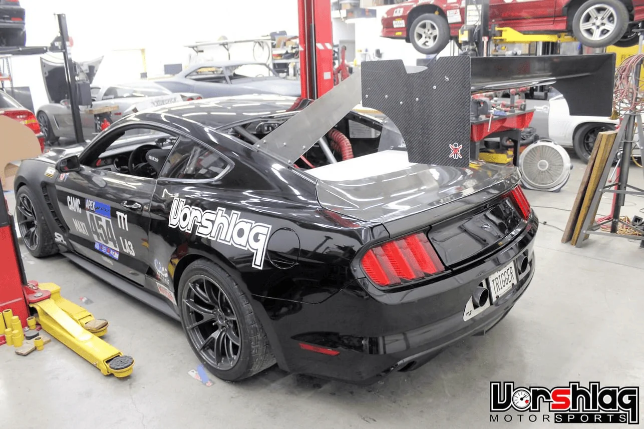

I mean AJ and Nine Lives already know the data on the aerofoil and both offer swan mount wings currently. The only difference is whatever you get from the mounting solution vs a standard mounting solution.
That's what makes this so interesting too, we will likely see the exact gains the mounts provide. Given the length of the mounts, in theory, you're creating more leverage. My thoughts are that you could achieve the same level of downforce as a traditional design, but use a lower drag wing since you have leverage on your side. Very exciting stuff.

Just to temper your hopes and dreams, the team behind the GTD confirmed that the mounting location of the wing came from the GTD design briefs and not the development of the GT3 car. Once the wing mounting was determined, Multimatic worked to make the profile meet their targets. This means that they likely could have achieved the same targets from a more conventionally mounted wing. If anything the arms may provide additional Lateral stability the way many of the modern LMP cars all utilize their central spine.

Doesn't moving the wing farther back also lighten the front? With any wing, the rear wheels are sort of a fulcrum of a see-saw.
yeah the rear wheels are a fulcrum.
placing the wing far back magnifies the effect over the rear wheels but lifts the front some.
without my front splitter and just the rear wing I roll down the highway at 80 doing wheelies. Not really but you can feel the difference in the steering alone.

The amount of potential downforce that wing produces makes me wonder if the mounting arms can handle that kind of moment.
Personally, the typical swan neck approach seems much more sound.
Any aero has to be balanced. I wouldn't go so far as say wheelies, but I would suggest a possible understeer condition if presented with unbalanced aero and the right circumstances.
The location of the airfoil does change how the forces from it interact with the car. The combination of drag and down force of a wing above or behind the rear wheels will lift the front.
However, the MOUNTING and whether the mounts are straight down from the wing or angled forward doesn't matter (other than thick mounts might have more drag, etc.).
To me, the GTD wing appears to be in a fairly traditional location over the rear of the car. It's just the mounting that is unique.

Yep. And I think the applied force might actually place more pressure directly over the rear wheels when compared to traditional mounting.
