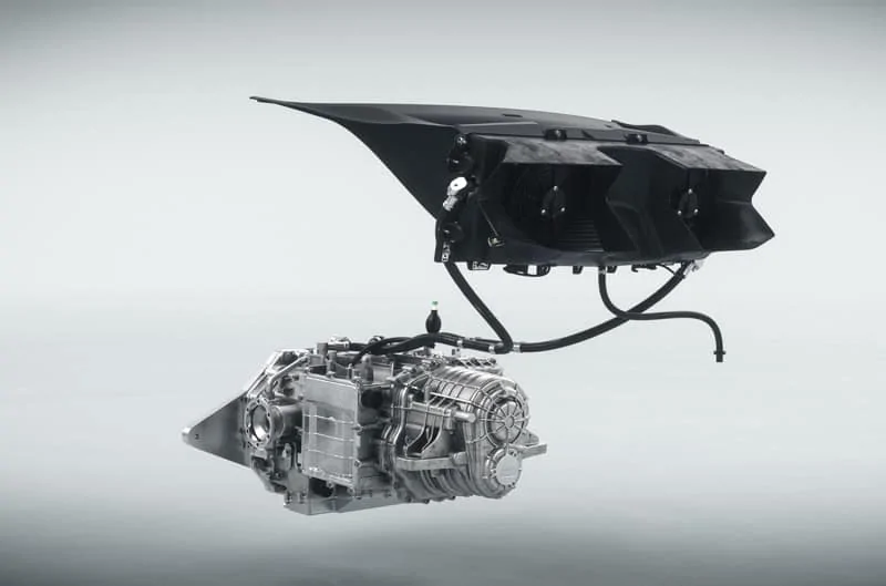

Is it a "trunk", or a fuel cell cover?
No fuel cell in the trunk of the GTD. The trunk housed the transaxle coolers which are fed by the ducts on the trunk lid and exit out the back between thr taillights. Also houses the inboard cantilever suspension that they had to relocate due to the size of the DCT transaxle.
The GT3 car's sequential transaxle is smaller and still utilizes the standard S650 suspension design.

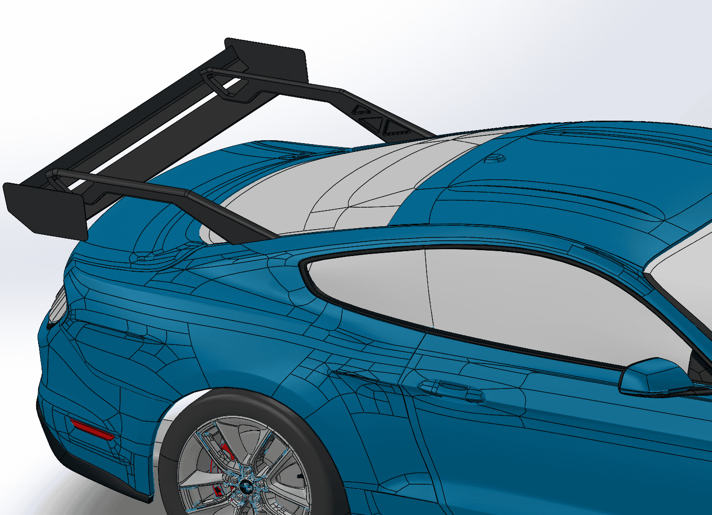

Apparently “who will be the first” is Terry from Vorahlag whos doing a similar wing mount on his LS swap lightweight S550 build with a big freakin 9lives wing element. He’ll probably have it done by the weekend.
Second might be AJ Hartman Aero who just posted some CAD style mockups.

I like that AJ is going to be working on one. He'll back his stuff up with data, unlike some of the other options on the market. Terry absolutely knows what he's doing too. Looking forward to seeing both these projects move forward.

I mean AJ and Nine Lives already know the data on the aerofoil and both offer swan mount wings currently. The only difference is whatever you get from the mounting solution vs a standard mounting solution.
