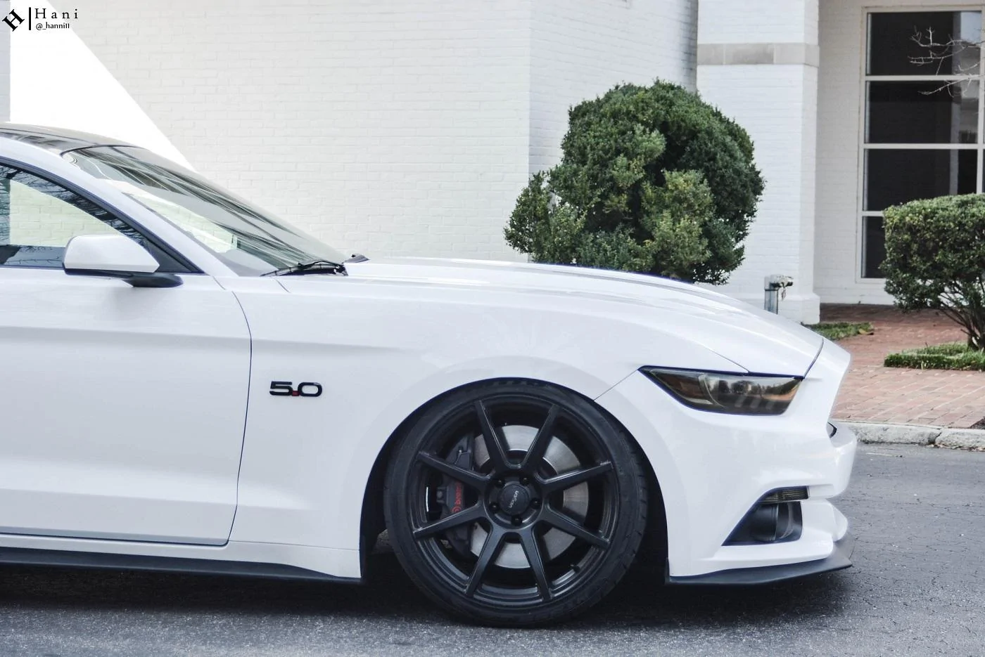

Plus look how sexy them brembos look on my car.:love:
