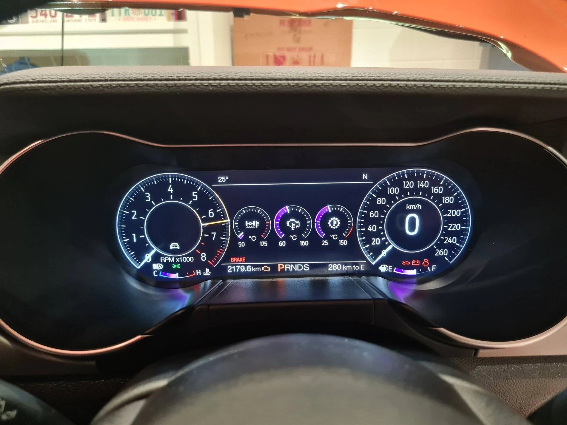

Axle oil temp is definitely doable in Forscan.
It's in the IPC module (not as-built). I changed "axle oil temp display" from disabled to enabled.
Also interesting to note that I could enable the "performance shift indicator" even though I have the A10.

Lukas
Dec 8, 2020
Brisbane, Australia
2020 GT A10 Twister Orange
You're welcome :).
In the list of Forscan modules, you'll see both IPC (as built) and IPC. The "as built" contains a lot of numbers, but I didn't touch any of those.
I just went into the IPC module which displays a whole list of options (some of them don't work for RHD cars, like oil pressure as mentioned before). Find the right option, change from disabled to enabled, and click write. It's a lot easier with pics or a video, there are a few floating around.
I found that the axle temp gauge didn't move for a long time from a cold start. I thought it was broken but it was showing as above after a 20min drive.
Yeah, that's normal. It takes a while to move (if at all), since the minimum temp is 100F or so. If you don't drive on the freeway/highway in winter, I bet it doesn't move at all. It even takes a while to move in summer.

OK, I did the change. The strange thing is that I had two similar options in the IPC configuration menu. One was "Axle Oil Temp Display", and the other was "Axle Oil Temperature Display".
I changed only the first one, since that was specifically mentioned by Lukas above. And indeed, now I have the axle oil temperature in the list of gauges.
As promised, I compared the before and after IPC config.
The only change appears to be in block 720-06-01. The before values were FFEE-067B-B854. The after values are FFEE-167B-B864. So, the recipe for configuring it in the as-built menu seems to be this:
720-06-01
xxxx 0xxx xxxx - axle oil temperature disabled
xxxx 1xxx xxxx - axle oil temperature enabled

The gauge shows a red zone starting at 150 °C. I wonder if that's also the temperature at which the car goes into limp mode.
