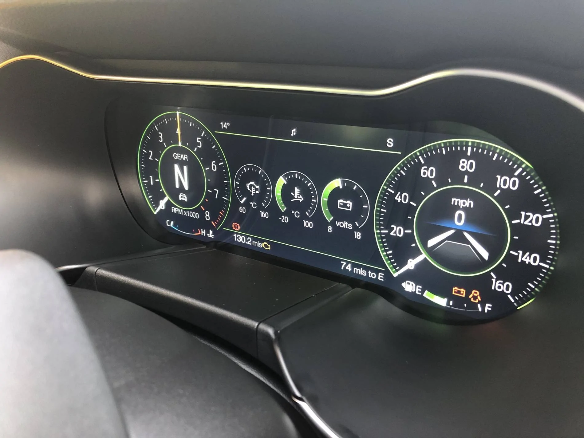

Hi,
2020 U.K. GT with diff temp sensor.
The small gauges on the digi dash don’t give me the option to put the axle temp on
Is this correct ? Can it be added through Forscan ?
Any help appreciated :like:
Cheers,

Think you have to go to the custom gages to select the one you want and it’ll only let you have 3 at a time to display on the dash. It’ll be greyed out if 3 are already selected

I can turn gauges on and off and pick the ones I want, but the option for the axle / diff oil temp isn’t there even though the sensor is on the car - kind of like ford forgot to activate it in the software (like I can’t see the boost gauge, but then I don’t actually have a turbo - so that ones logical lol).

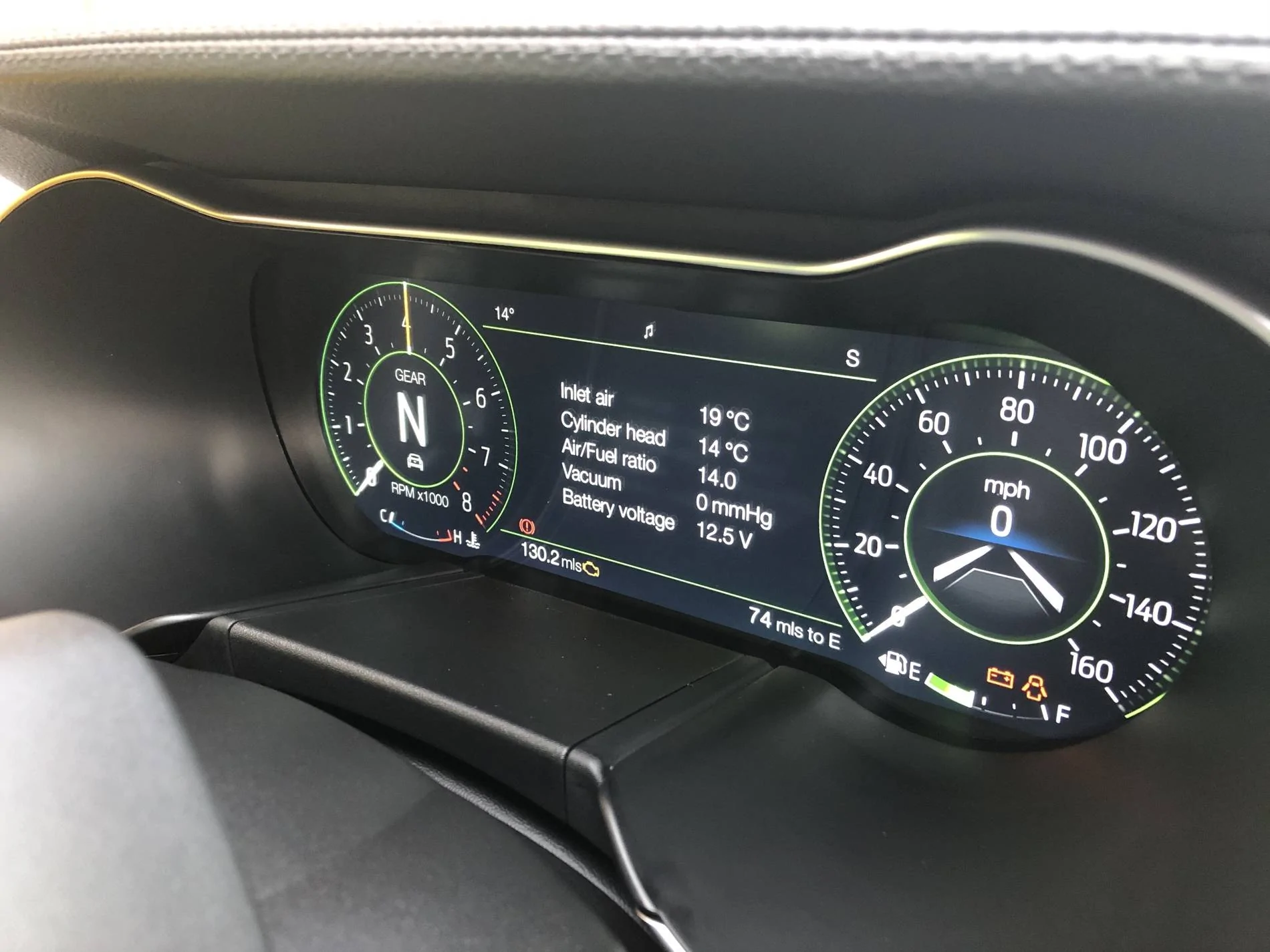

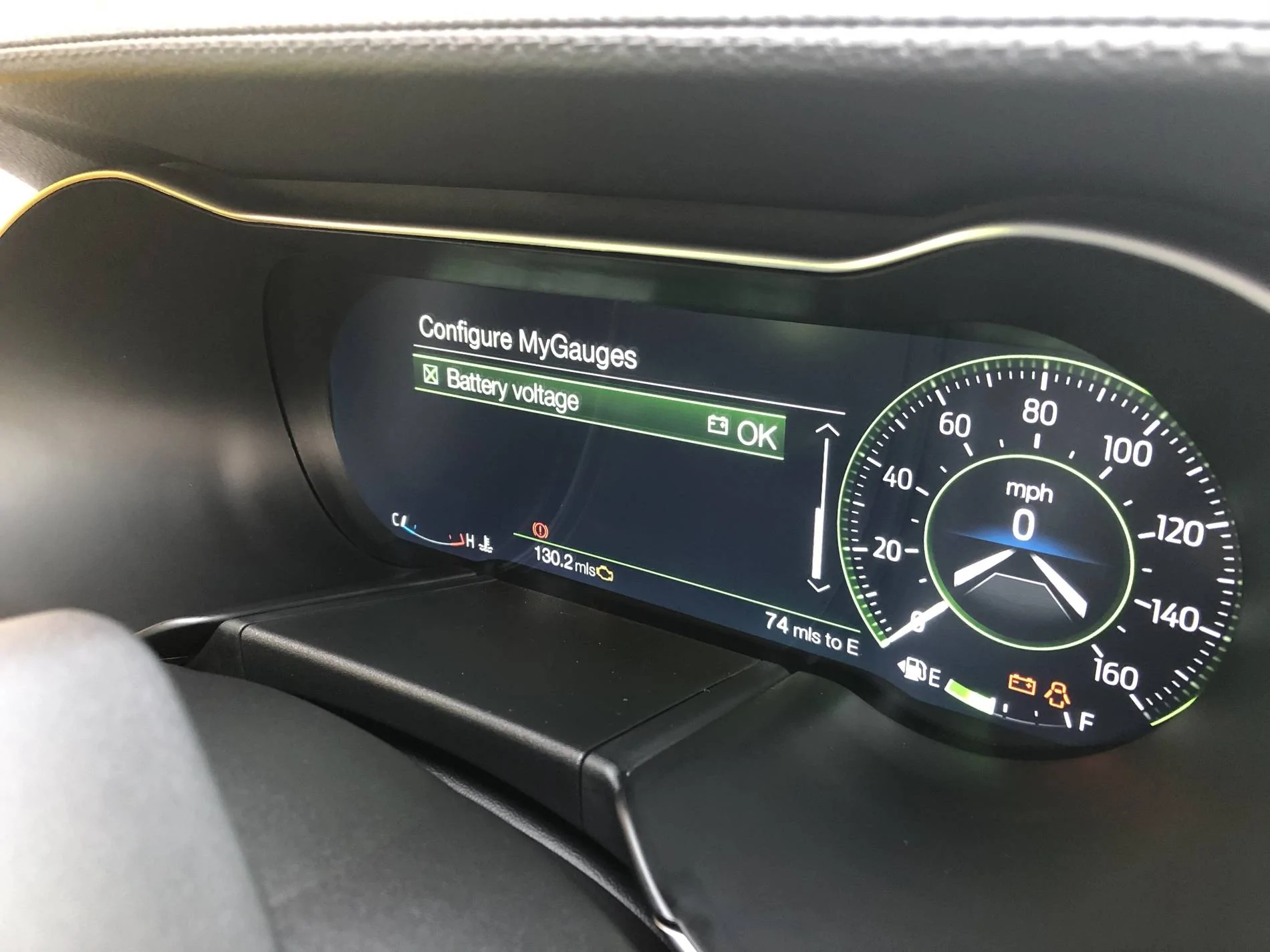

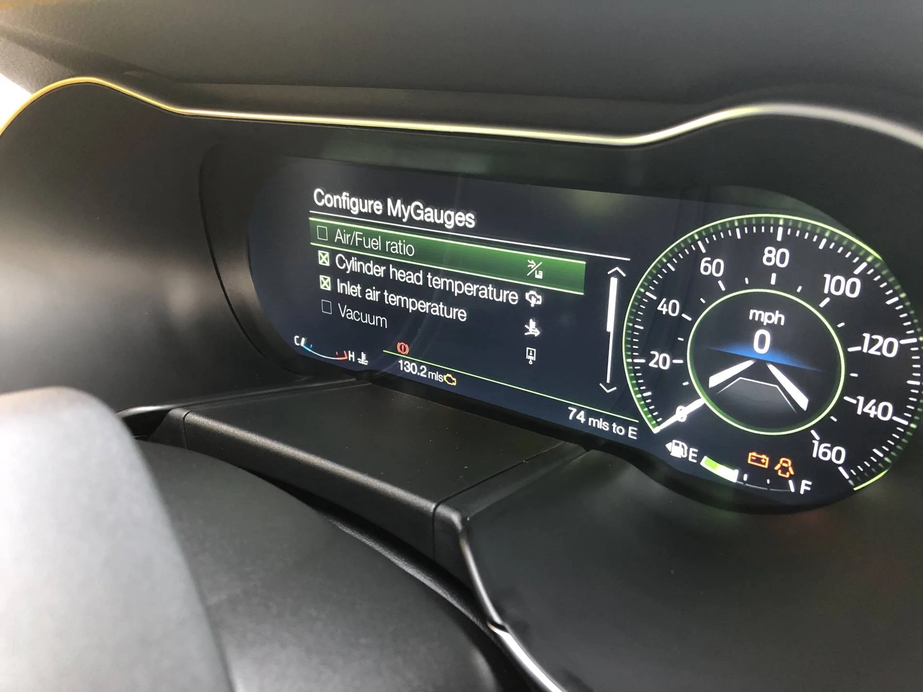

Nope, doesn’t appear to be there.
On the off chance I’ve missed something, here’s what my dash is like :
Can I scroll this menu ? If I press down again I get tyres and g meter etc :
The manual does suggest I should have an axle temp, but here are my options :
Paging @breeves002 ... :like:

Huh, I honestly don’t know then. US spec PP cars have it in the menu in the second pic, so not sure why the UK car doesn’t have it
