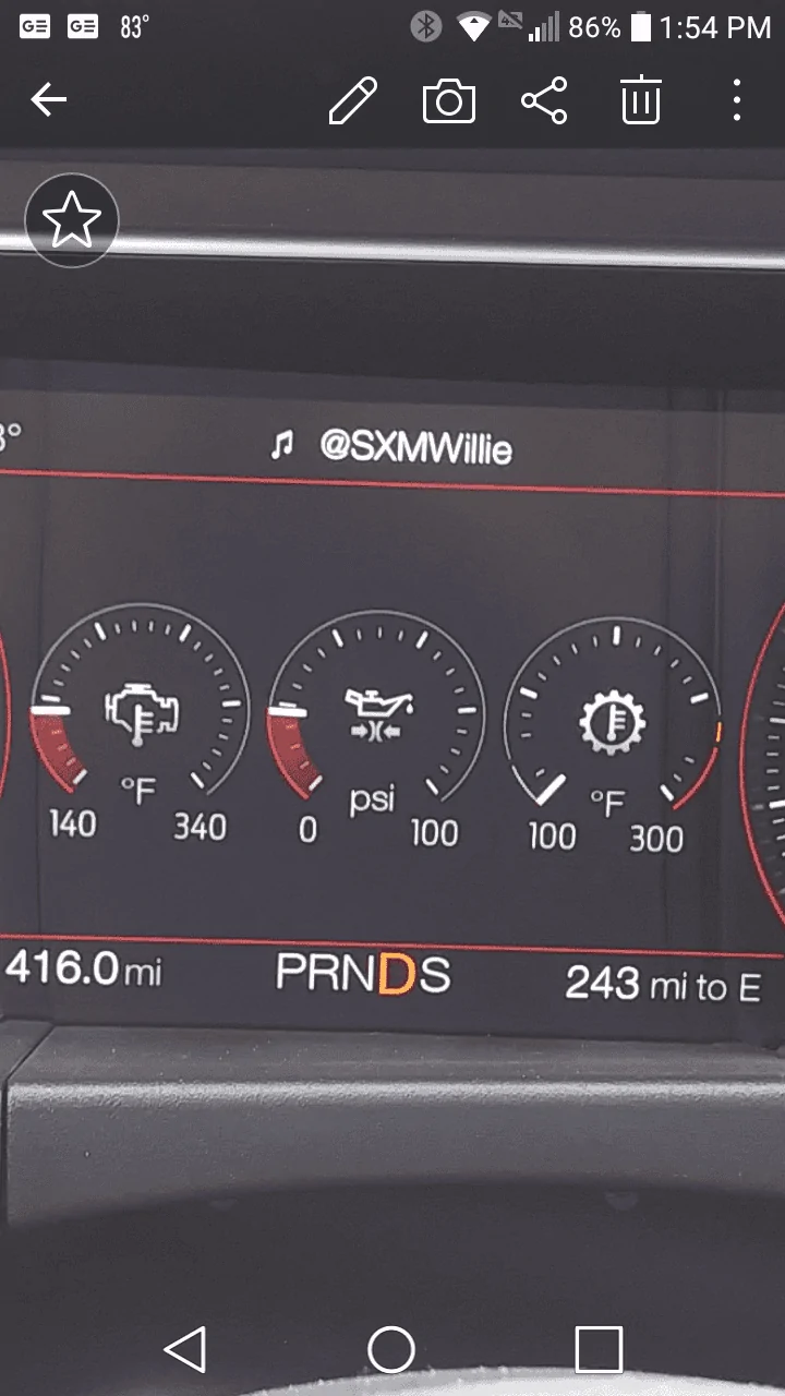

The 3 gauges that I display are cylinder head temp, oil pressure and transmission temp. I presume the info is from the ECU.
The more I see this digital cluster, the more weird things I notice about it.
Each dash of the coolant temperature gauge is eight degrees. Each major increment is forty degrees. Odd, but okay...if you like things divided into eight!
Oil pressure gauge, as expected. Transmission temperature gauge...well outlined with a cold band, normal band, a warm band and a Danger Will Robinson band :).
