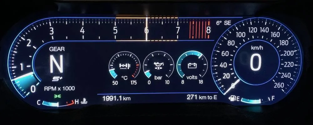

I took the same route today. This time the temperature was 6°C. And the road was dry, so those 18 miles were done at about 105-110 mph. This seems to have done the trick.
OK, so the gauge is working. :party:

6k seems like a good point to up-shift when I need to accelerate very hard, but not necessarily so extremely hard as to justify going all the way to the red line. It feels like a good middle ground.
I like this feature. I find it nice how the contour of the tach turns yellow as I approach the limit, then the entire tach turns yellow. Besides, I find that the screen as a whole looks a bit more balanced with that yellow line in the middle. I can't explain why, it's just how I see it. :)

First experiments with Forscan today and I now have the axle temp gauge thanks to this thread :like: Now I just need to see if I can get it hot enough to register to prove it works ... (snow on the roads at the moment).
I have a question on the oil pressure gauge though ...
I can turn on the gauge, but it wont actually work (seems to be common issue on exports ?). The electronics must monitor the oil pressure as they adjust it to save fuel, but what other codes need to be adjusted to get the data to talk to the gauge ?
Any further help would be really appreciated :like:

Hi WD. I have the 18 AUS spec GT and after a coder had a play I got axle temp and engine oil pressure to appear. They both appear in the gauges option selector and show as gauges in the cluster. The axle temp works fine but the oil pressure does not budge so I suspect there is no sender for this info.

Did you get anywhere with the oil pressure ? Exports must have the sensor as you can see on @Vlad Soare post / photo above ? Maybe it’s on export LHD’s but not RHD’s ? I wonder is something is different with external oil lines / filters / sensors on the RHD’s ?

No, it still remains a dead gauge for me.
