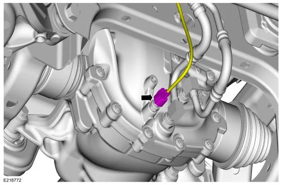

Does your differential look like this? The temperature sensor provides the data. If you have this, then it's likely something Ford didn't enable.
Yeah I have that (but not the cooler pipes lol).
I know @Vlad Soare took a picture of his that showed he had it to but he’s also without the dash gauge (he’s also euro spec / trac loc).
I suspect the sensor must be there to trigger the limp mode only ?
WD :like:

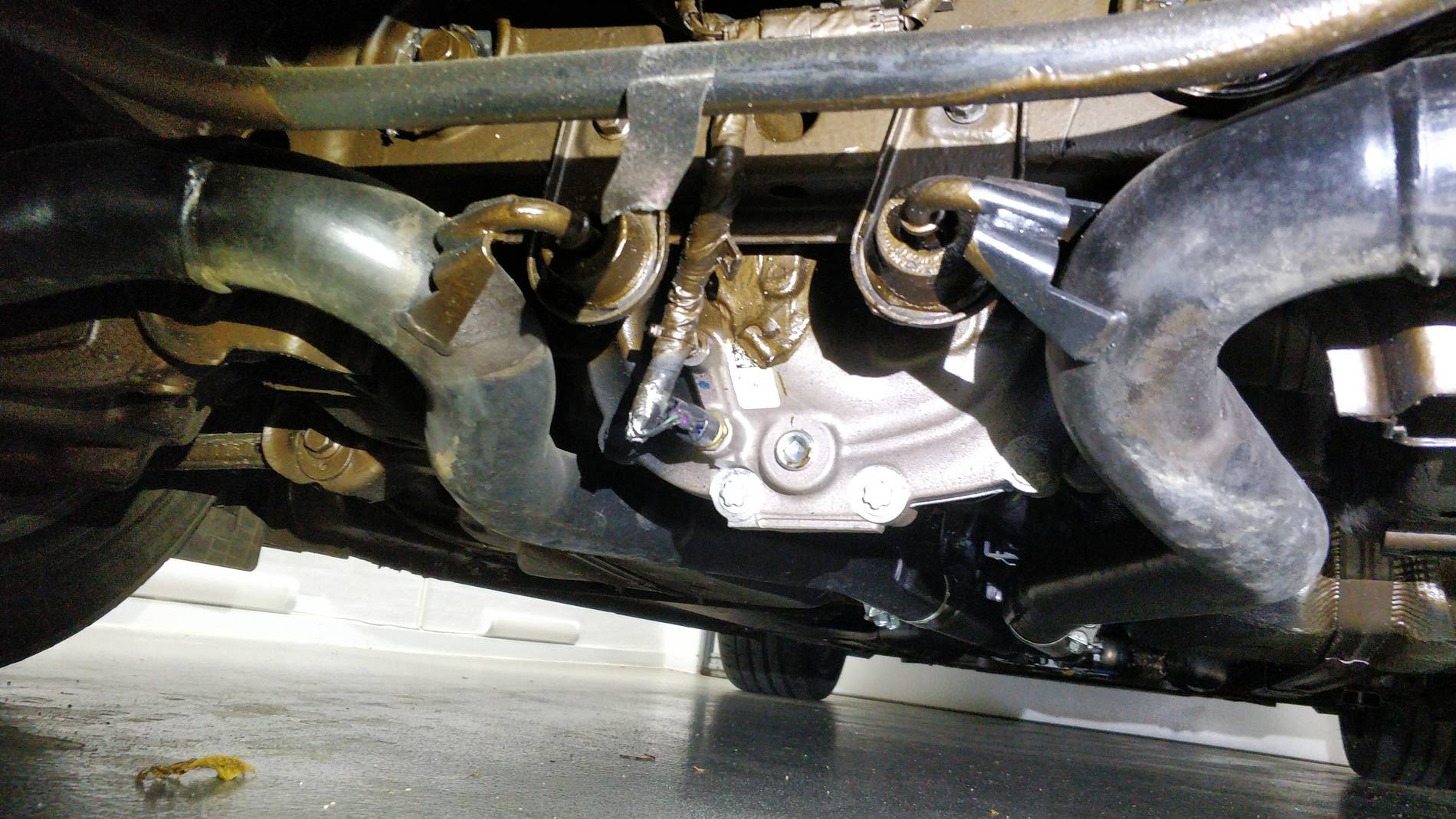

The European GTs look like this and I'm pretty sure that @WD Pro is right - the sensor on the EUs are for system safety and not for "entertainment" in the dashboard.
Don't pay attention to the brownish stuff... it is wax to rust proof and sound proof the car and not standard

Yes, that's how mine looks, too.
