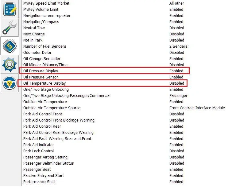

On another note and based on you looking through the IPC config, did you see the option to activate the engine oil pressure gauge and / or the engine oil temp gauge (yes, I know that one is a calculated value) ?

I think this has been mentioned before, but yes there are IPC options for an oil pressure display.
It allows an oil pressure gauge to be selected on the digital dash, but the gauge never works.
I didn't look for those. :blush:
I'll try again today.
I already have the oil pressure gauge. An oil temperature gauge, even calculated, would be very nice, but the general consensus seems to be that it can't be activated if you don't already have it from the factory. I will take a look though.

OK, I did the change. The strange thing is that I had two similar options in the IPC configuration menu. One was "Axle Oil Temp Display", and the other was "Axle Oil Temperature Display".
I changed only the first one, since that was specifically mentioned by Lukas above. And indeed, now I have the axle oil temperature in the list of gauges.
When I looked today, the second option showed as enabled as well. So I guess they're actually one and the same, just duplicated.
