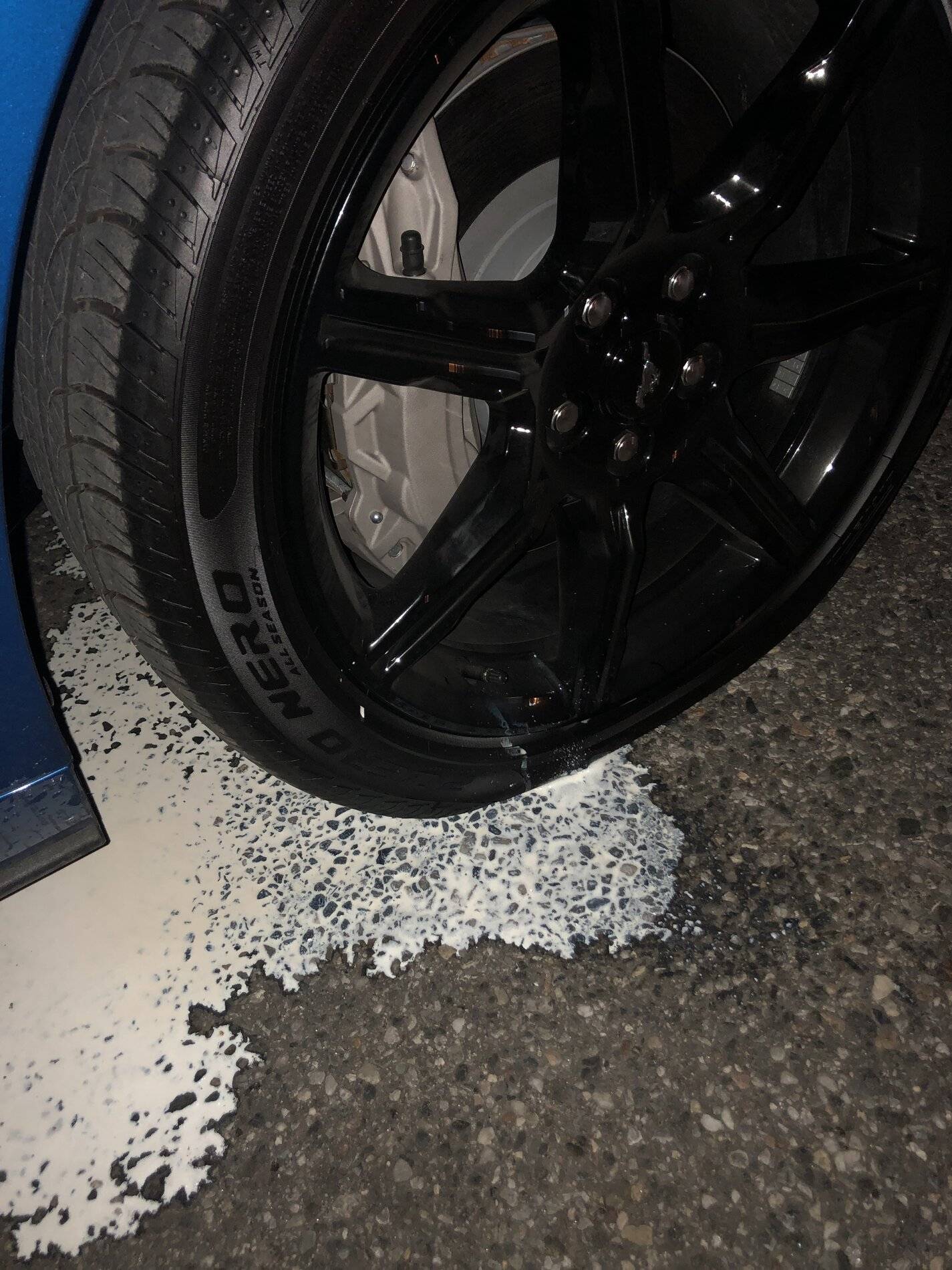

I had a 19 gt before my mach. It also didn’t have a spare tire. The goo is pretty much useless if you get a flat call road side
Even worse. Does the goo destroy an otherwise repairable tire?
destroy, no but it makes a ROYAL mess and a bitch to clean. Most shops will just throw the tire back in your face "clean that sh*t your damn self".
That's why people, get the Stop-n-Go kit and it's mushroom plugs!

Assumes you can find and get to the leak though, no?
