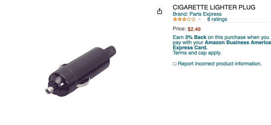

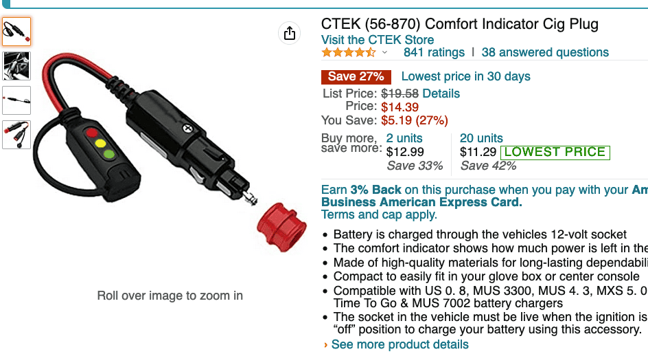

Another twist, have a CTEK muti US 7002. It has a unique feature, beyond the standard battery tending.
It is called SUPPLY, this mode when selected. The charger operates at a constant voltage of 13.6.
1 Using it to change a battery without losing settings or having to reset the BCM.
2 Find the Auxiliary Power port, for us, old school guys it's the cigarette lighter.
3 With the plug in the socket, connect the charger, set mode to SUPPLY
4 change the battery
Changing, the car settings.
As far as I know (may be wrong) there is not the old accessory setting for the ignition.
It is full-on or off, and with all the electronics, the car is power-hungry. At one time one could turn on the radio. Work or wax car windows down, not on these.
Using the SUPPLY mode allows the owner, plenty of time. To mess and play around with the settings and options.
FYI for the interested....
Plugs
