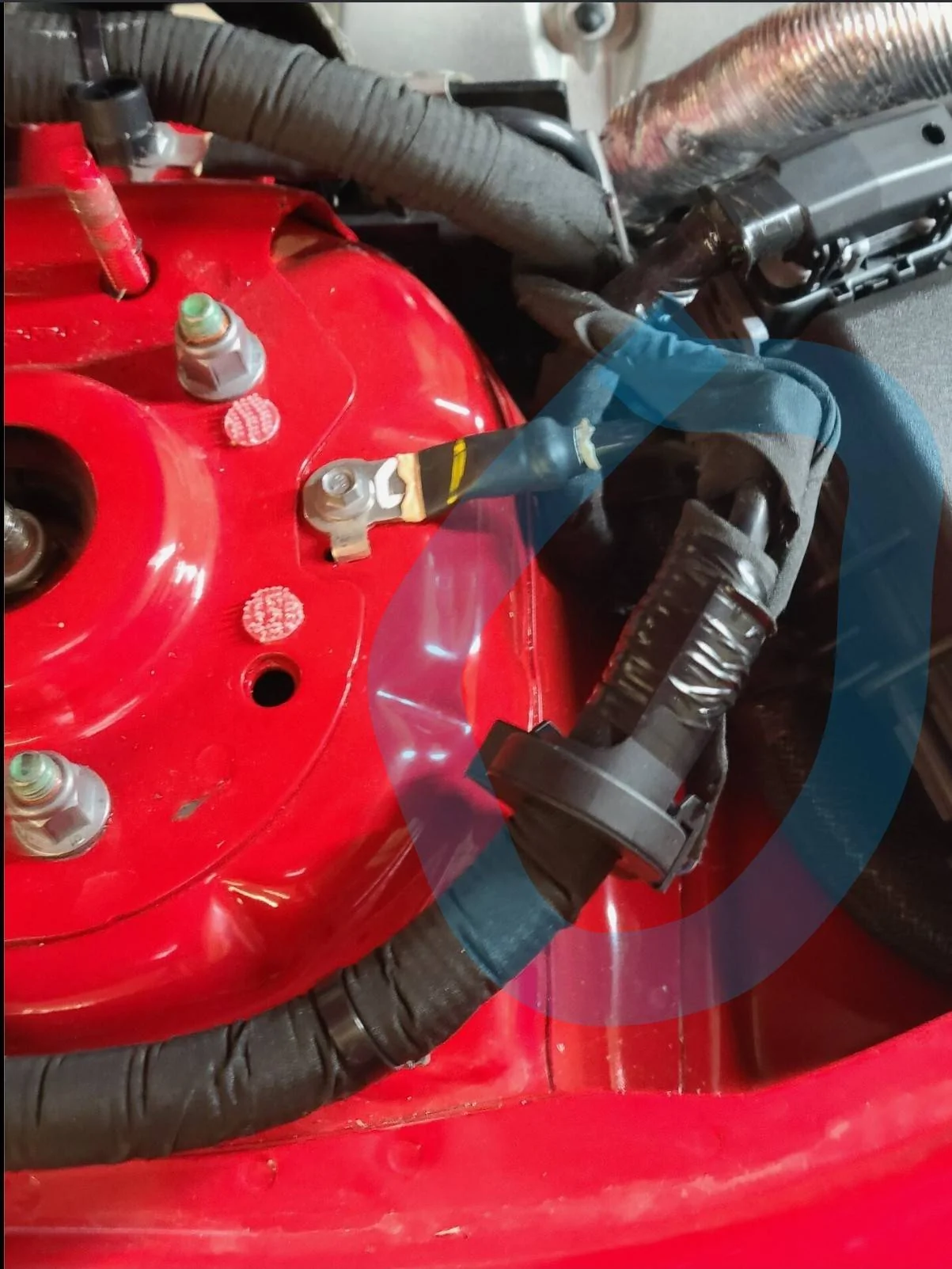

I learned there is a regulator you can disconnect. This has been pretty solid at leaving my volts at around 14.3-14.6 for the most part. It does drop to 13.6 but I have a ton of shit in my car drawing heavy voltage. One massive 5K watt amp and 2 smaller amps, 15" touchscreen, LED inside/out, methanol pump, airbags, stereo, LED steering wheel. See attached, disconnect that and see how your battery feels. I haven't had any issues since.
