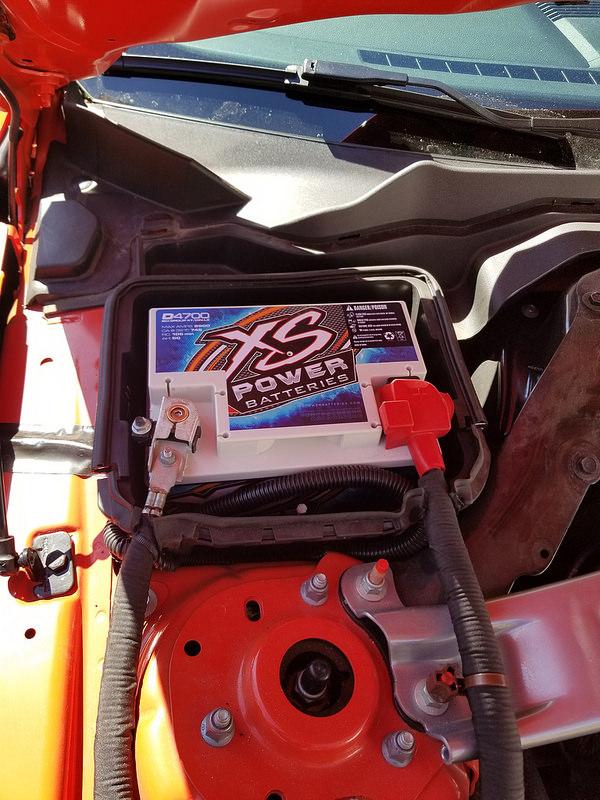

If you want some battery firepower,
XS Power D4700 fits like a glove.
815 CCA
20180311_132034 by chefjpd, on Flickr
