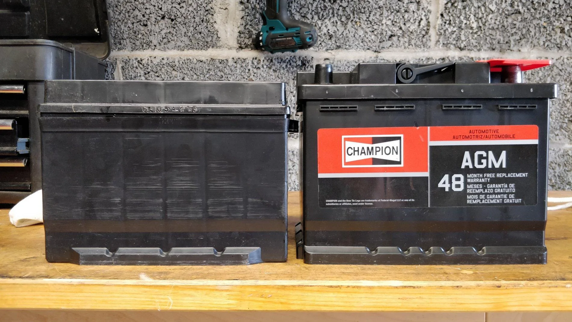

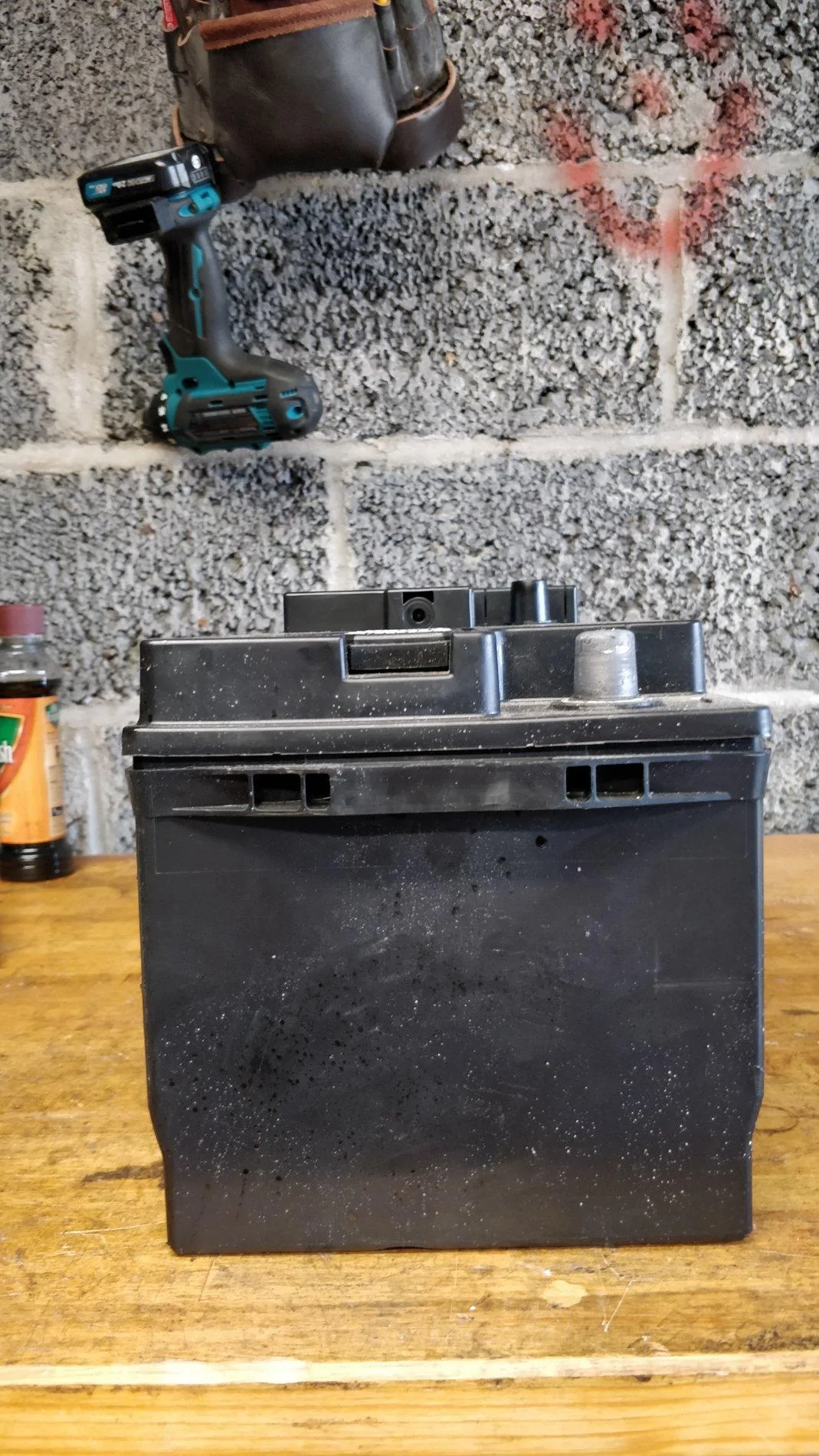

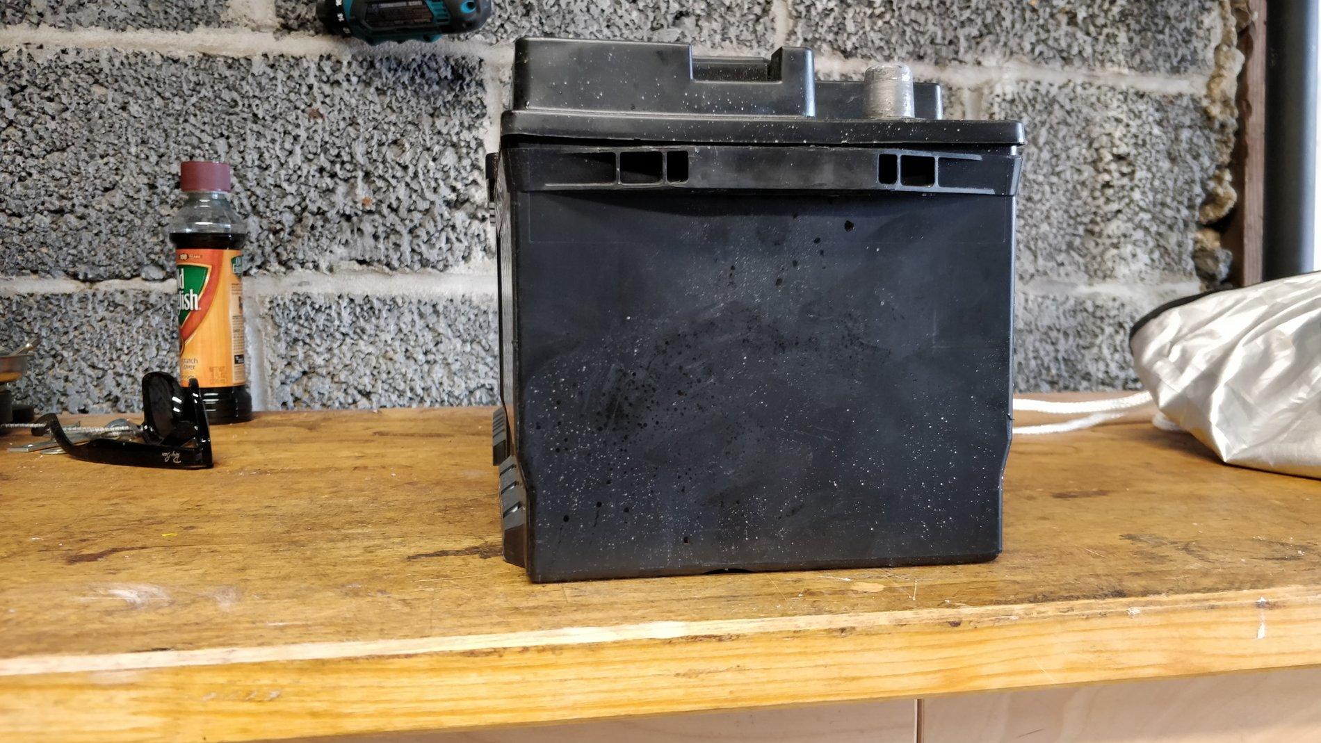

Got the battery and tried the fit. Long story short, I was not comfortable with it. The battery is taller than the seal of the box. With the cover in place it's too tall to close without putting stress on the hood at the point where the hood seal contacts it.
Without the cover in place, looking from the drivers perspective, the hood rests on top of the battery at the right rear section. You can feel this by sticking your fingers past the cowl with the hood just resting on the release. The hood can be closed, but its rubbing and/or putting stress on the hood.
The clearance with the stock battery and cover is already incredibly tight and can be observed by sticking a strip of cardboard between the battery cover and the hood with it closed. It barely fits as it is.
I returned the battery. I think the correct solution is to relocate the battery to the trunk if a larger battery is the goal. Better weight distribution anyway.

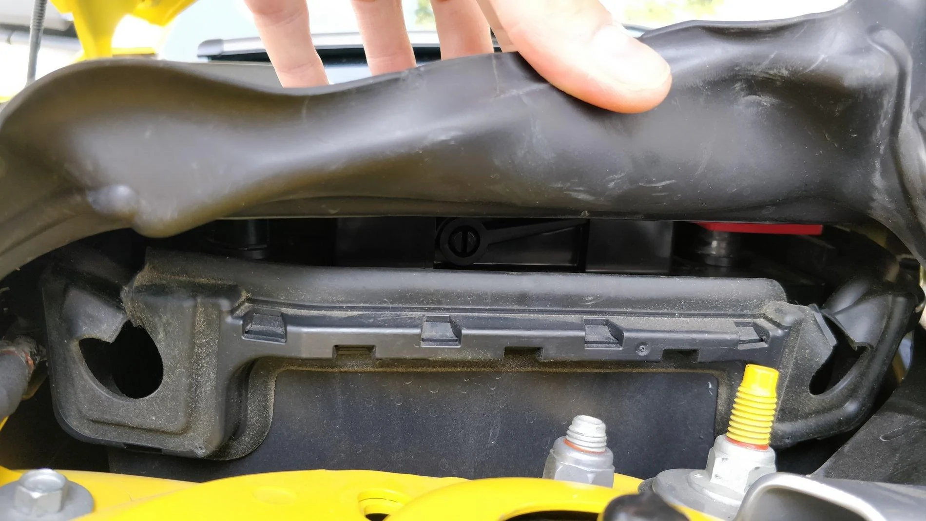

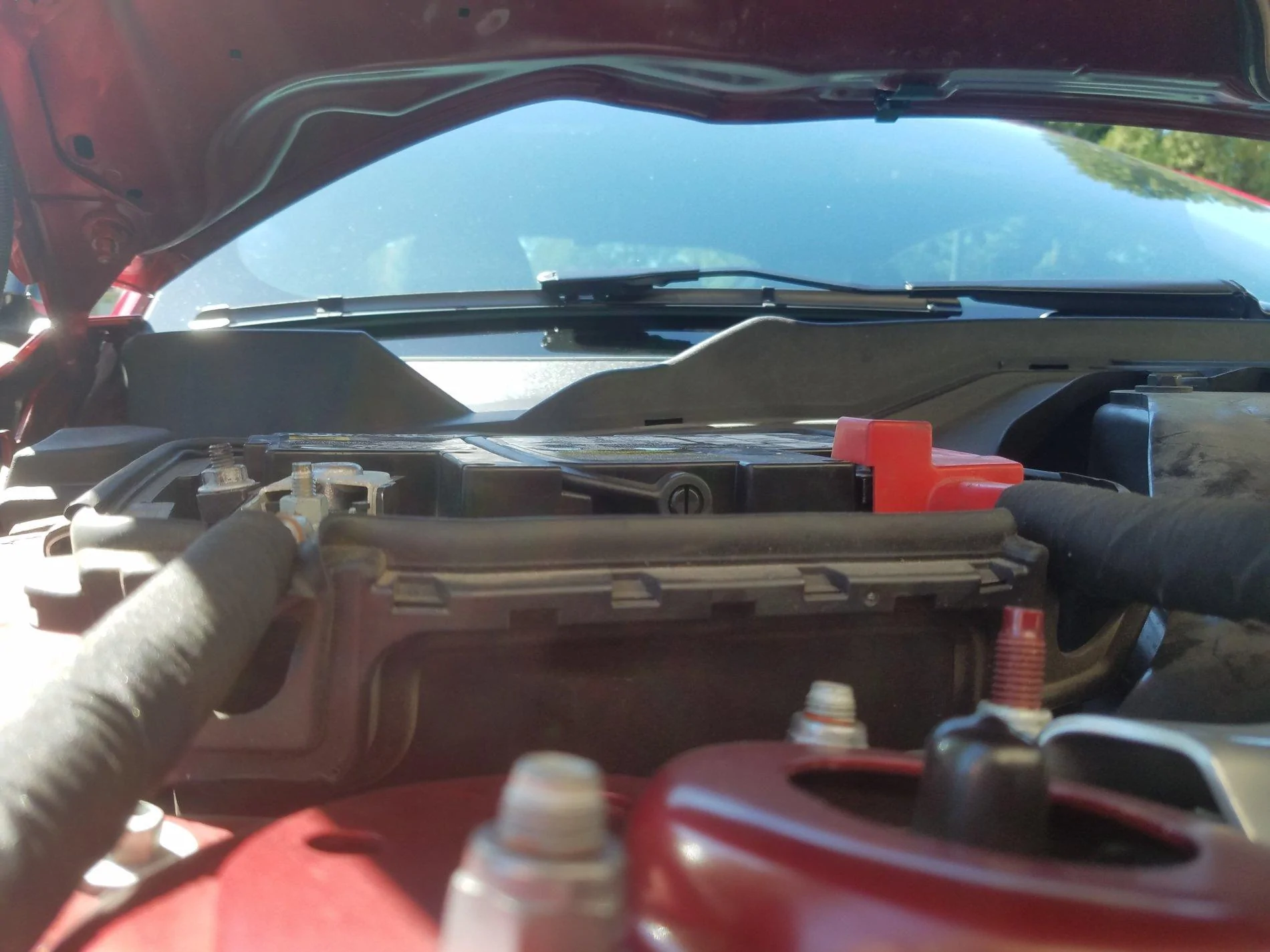

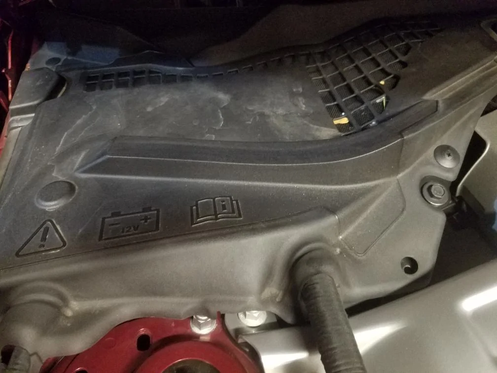

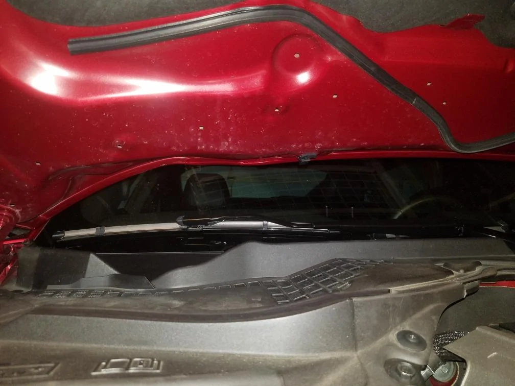

Thanks for pointing out this potential fit hazard. Your post got me interested in double checking the fit for mine too...
The only place where my hood actually touches the battery cover at all is the black weather strip against the raised ridge on the battery box. Shown in the picture below.
The bottom of the battery cover does touch the top of the battery, but only in the center region of the battery, which is only about the left third (or at most half) of that raised ridge. In fact, the right hand side of the raised ridge on the battery cover is not above it's normal (96R battery) position and transitions perfectly to the rest of the hood seal surface.
I do not detect any rips or tears in the weather strip around the areas that correspond to the highest point of the raised ridge over the battery.
With the hood fully latched closed, I can still put all 4 fingers into the gap between the battery cover and the rear of the hood (using that dip in the air dam near the left side). The only place where that thick part of the hood even comes close is on the right side where the battery cover ends and is aligned with its original position anyway, so that area is no different than stock.
In the second picture, you can see that I have installed wider area (larger diameter) plastic fender fasteners to help distribute the "pull" and diminish stress on the cover's "skirt". I put one on each end and left that middle one empty. You can see the resulting gap from the taller battery. In that area it is only about 3/8", at worst where the bottom of that ridge is actually touching the top of battery it is maybe up to 1/2" taller than stock. That weather strip appears to be thick enough to absorb the 3/8"-1/2" of extra compression. Perhaps over time that weather strip will wear out sooner than it would have with the OEM battery.
I had started to wonder if there were a few subtle design differences between the 2016 and 2017 hoods. Although it doesn't look like it by comparing to your photos...
I'm pretty sure that my AGM battery was made by Duracell and that I bought it from Sam's Club, although all Group 47 batteries should conform to the same outer dimensions.
Yes, it must be tighter than the stock setup because the new battery IS taller than the OEM, but it should be about 5/8" taller and if there was at least 1/8" clearance (probably more) between the original battery and the battery cover, then at most the top of the battery cover is 1/2" higher than stock. Based on the thickness of that weather strip, I don't think that is enough to go beyond the available space and actually damage the hood. Probably squeezing that weather strip about as much as possible.
Anyone considering the group 47 route will have to decide what they are comfortable with.

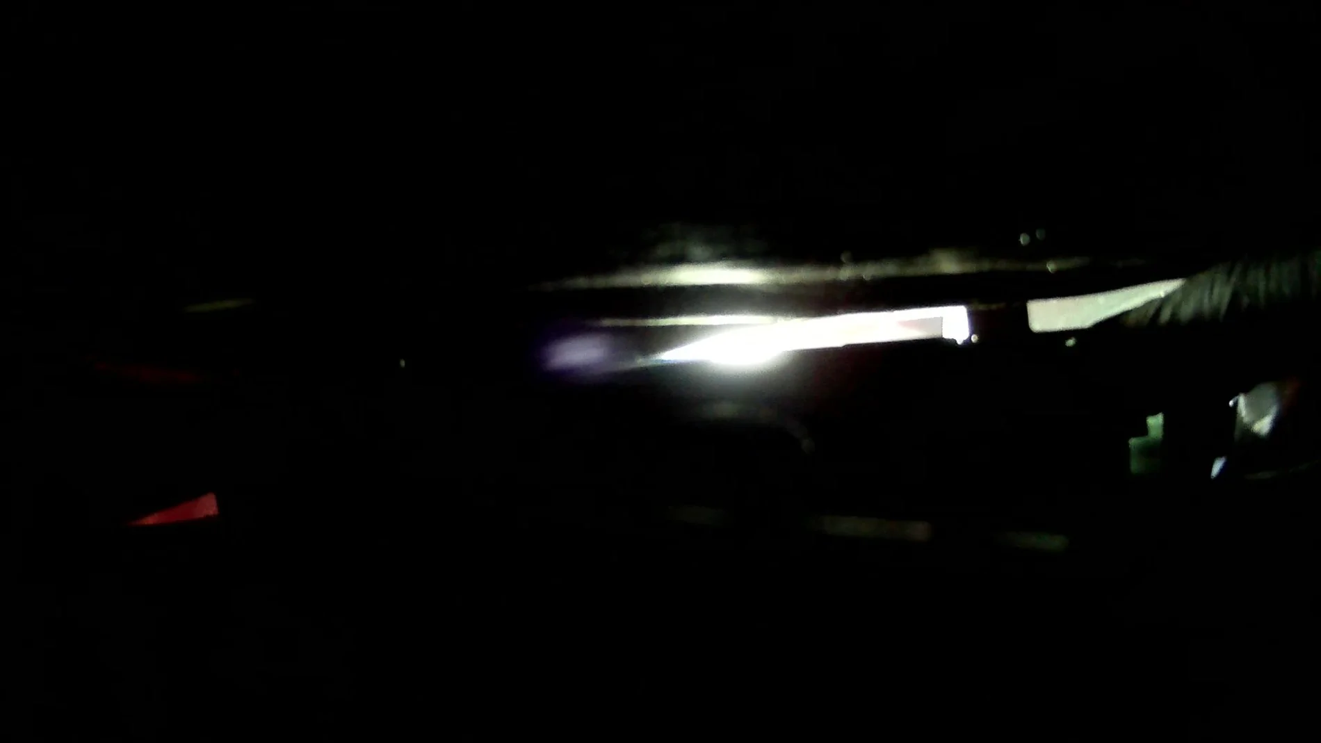

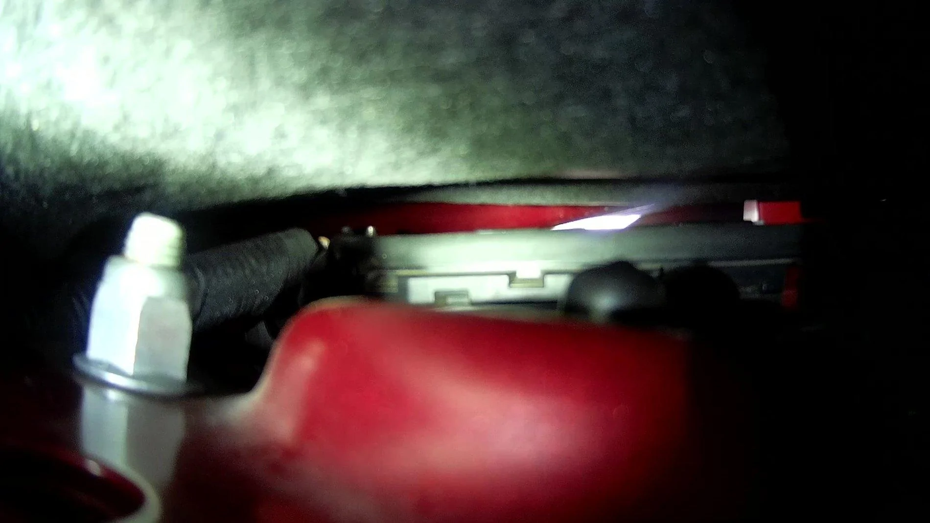

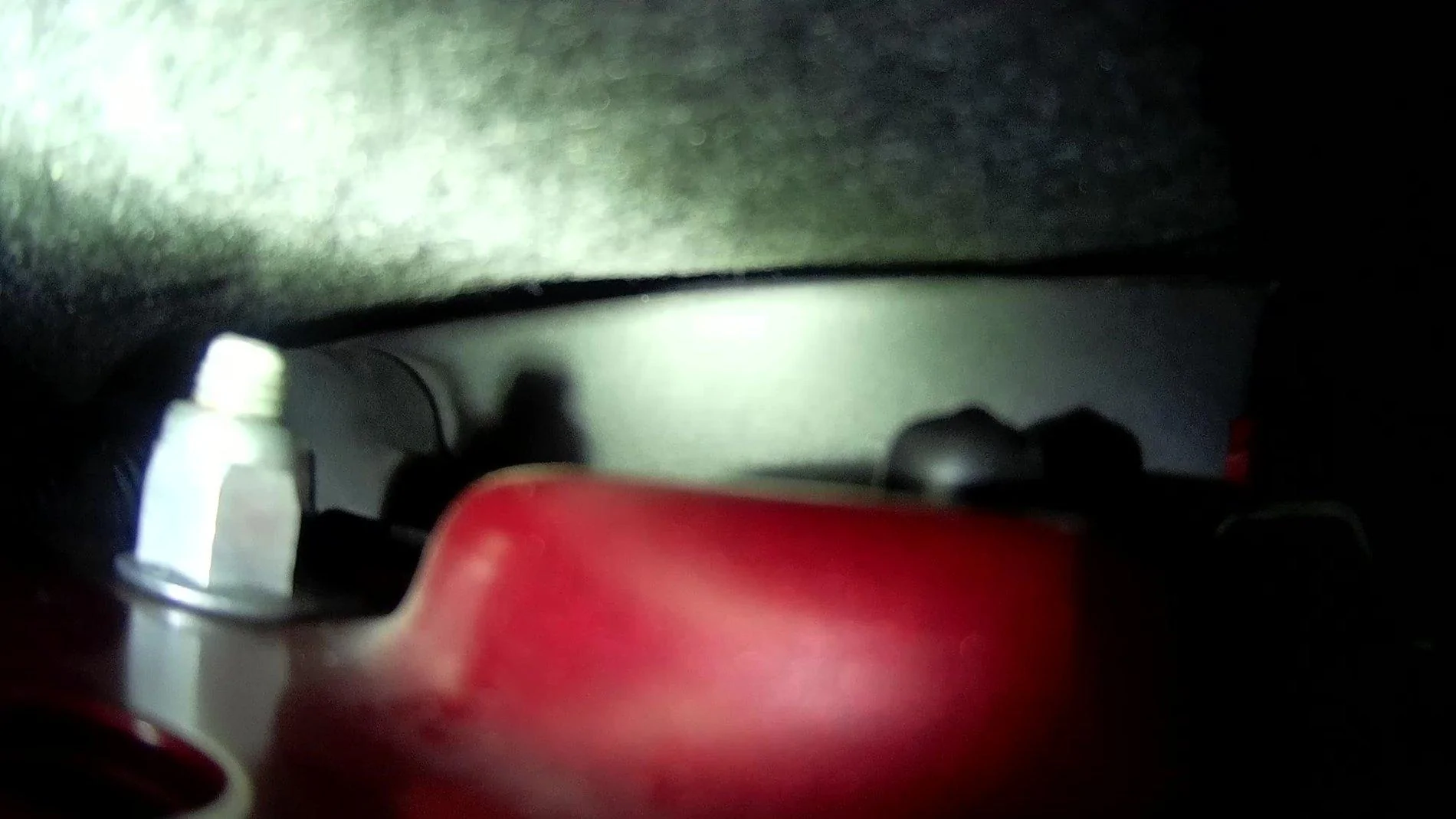

OK... Not the most stellar results. Things are pretty tight in there. This was as far back as I could get the helmet cam... It's tail was touching the fuse block. There may be other less obvious angles to try though...
Here is the photo with the battery cover off (using my phone) for comparison...
Here is a photo from the helmet cam's perspective with the hood open:
And here is a photo from the helmet cam with the hood closed and fully latched (battery cover still off):
I suppose with better lighting and maybe a different location for the helmet cam, we could get a better look. Let me know if there is still interest in more pictures...

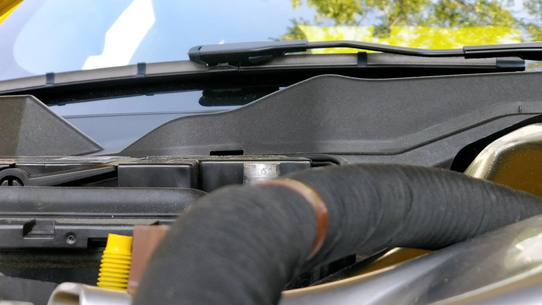

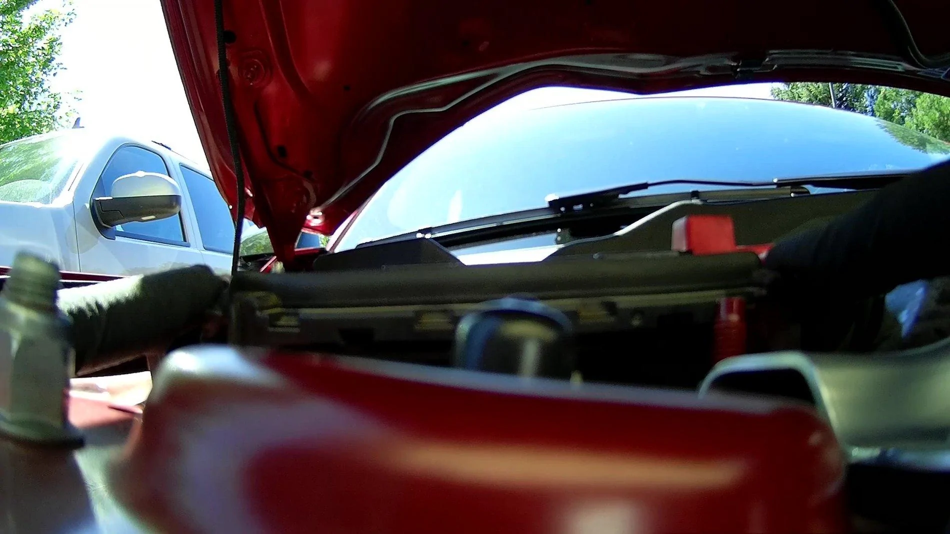

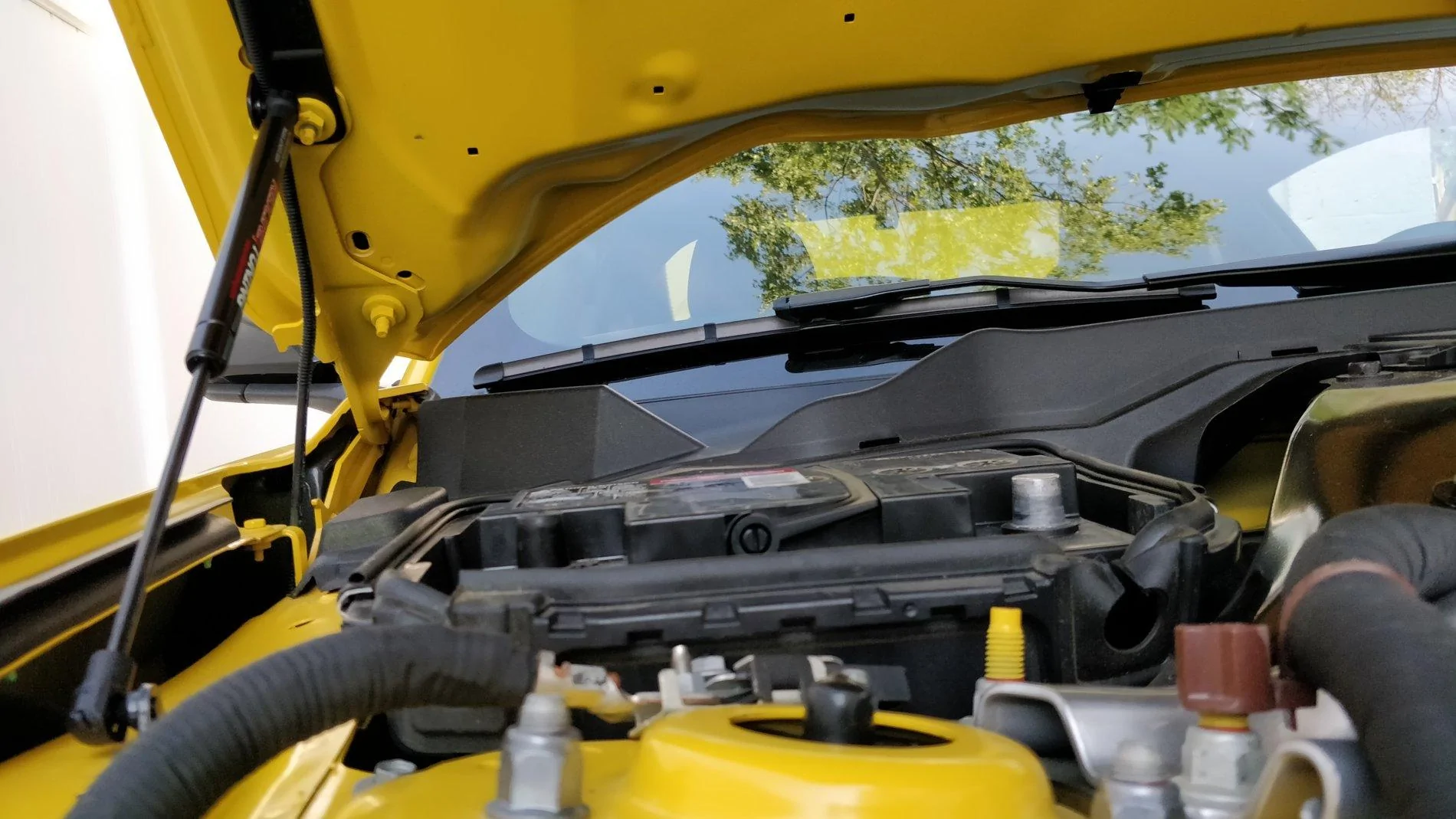

A couple of better ones:
With the battery cover in place:
Without Cover:

That's pretty tight. But not bad, I guess. I just didn't like how the hood felt closing down on it and I noticed some deflection at the left hood pivot so it swayed me. I went with the regular battery for piece of mind.
