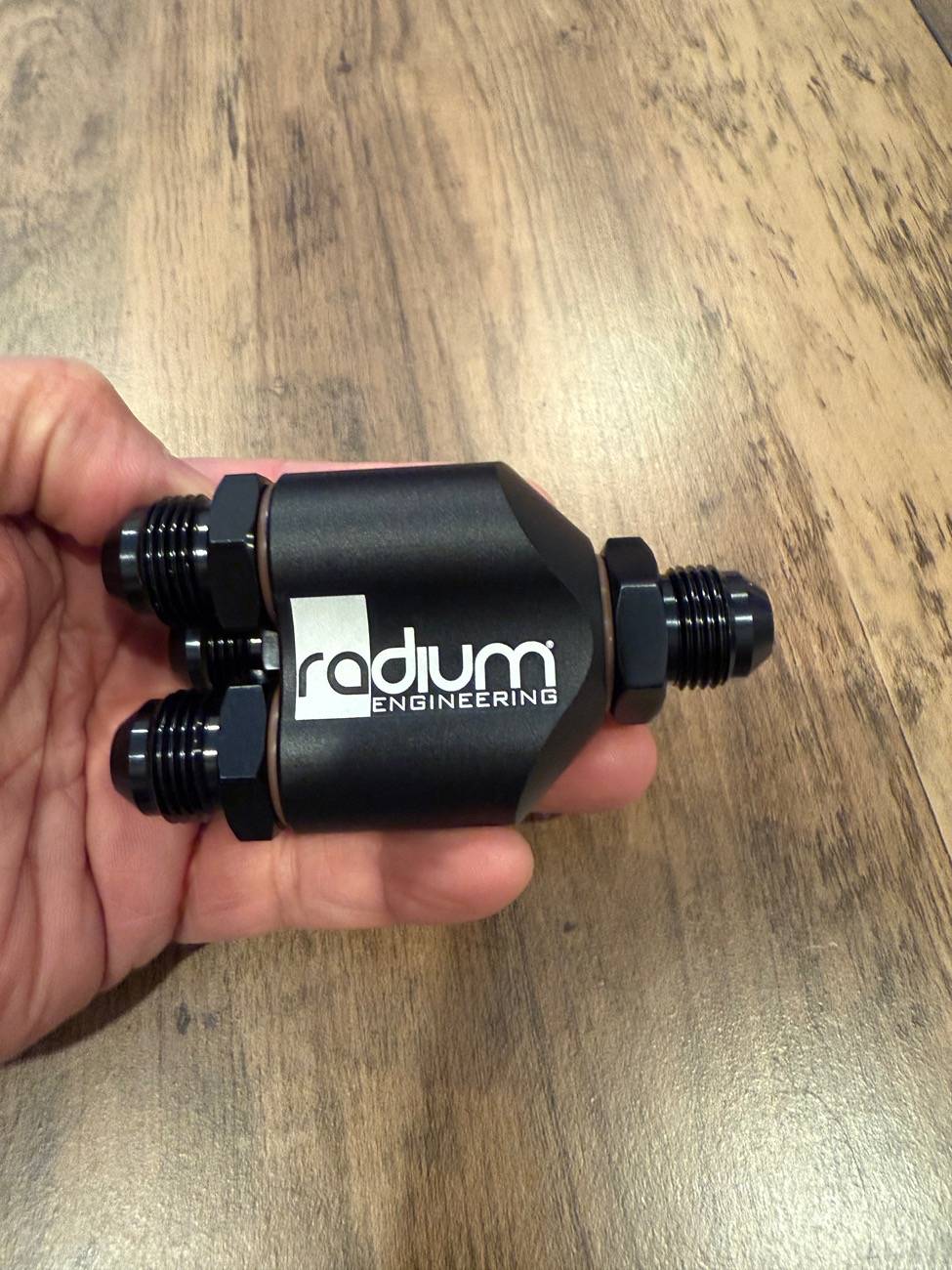

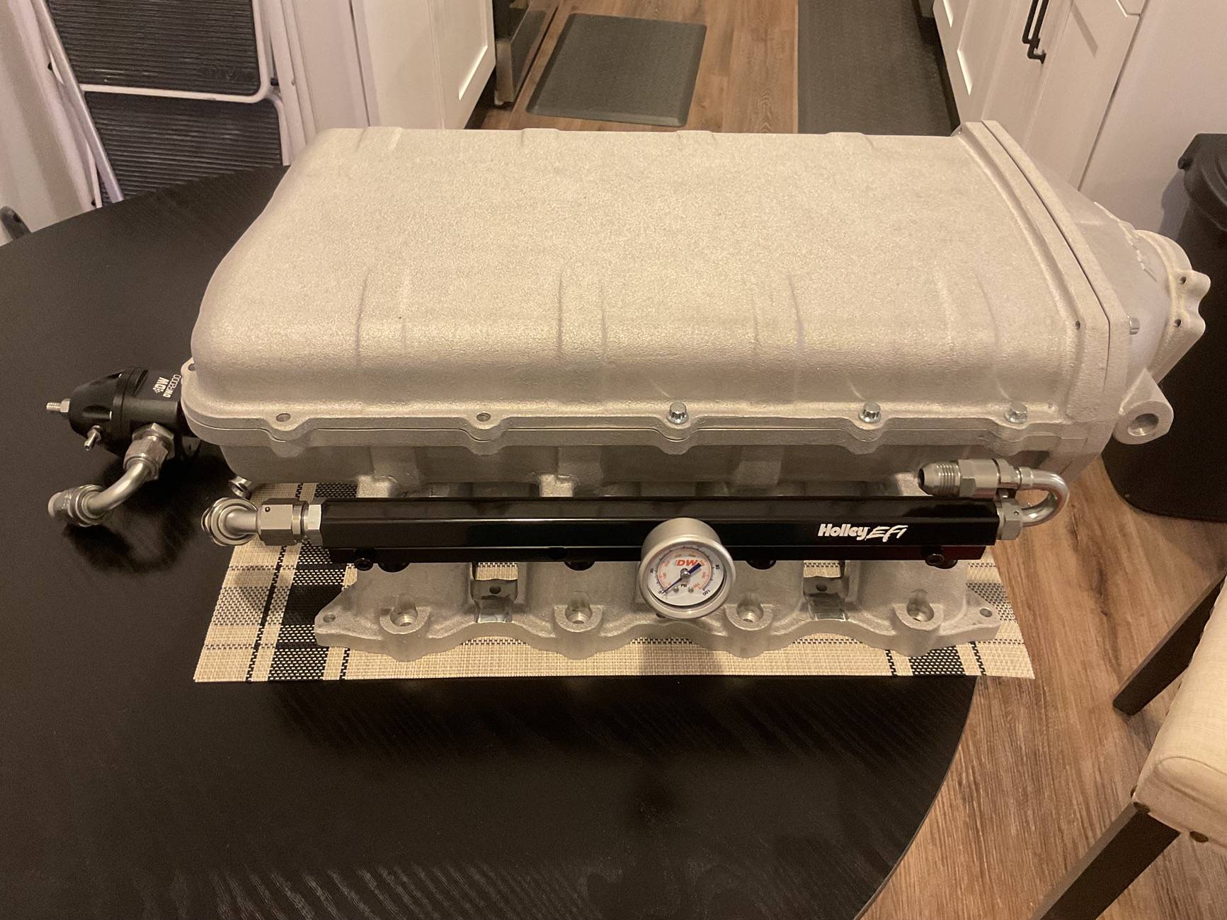

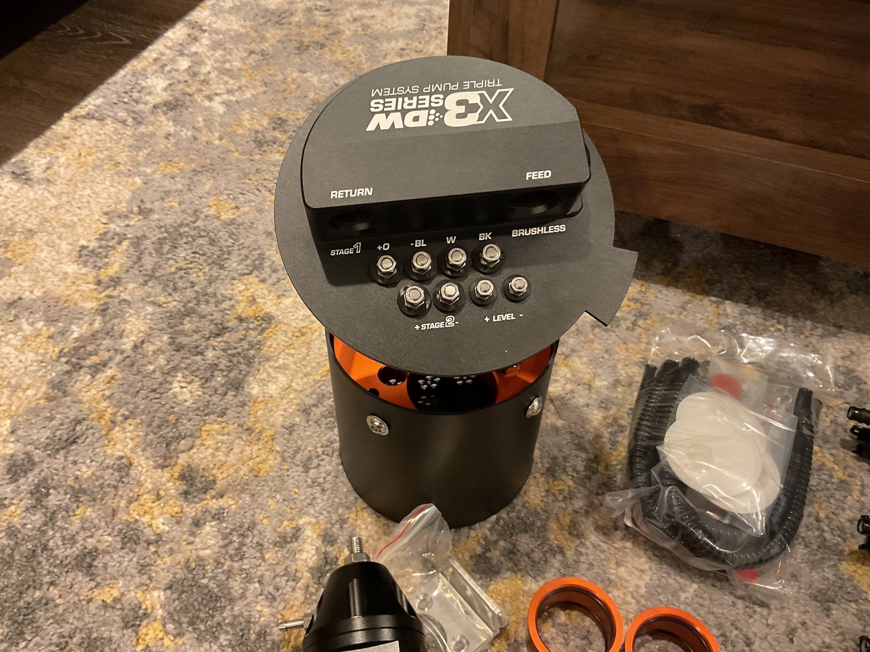

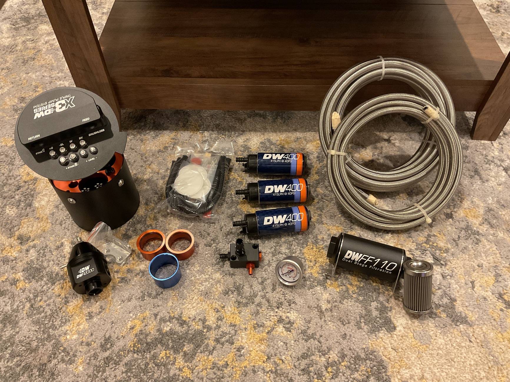

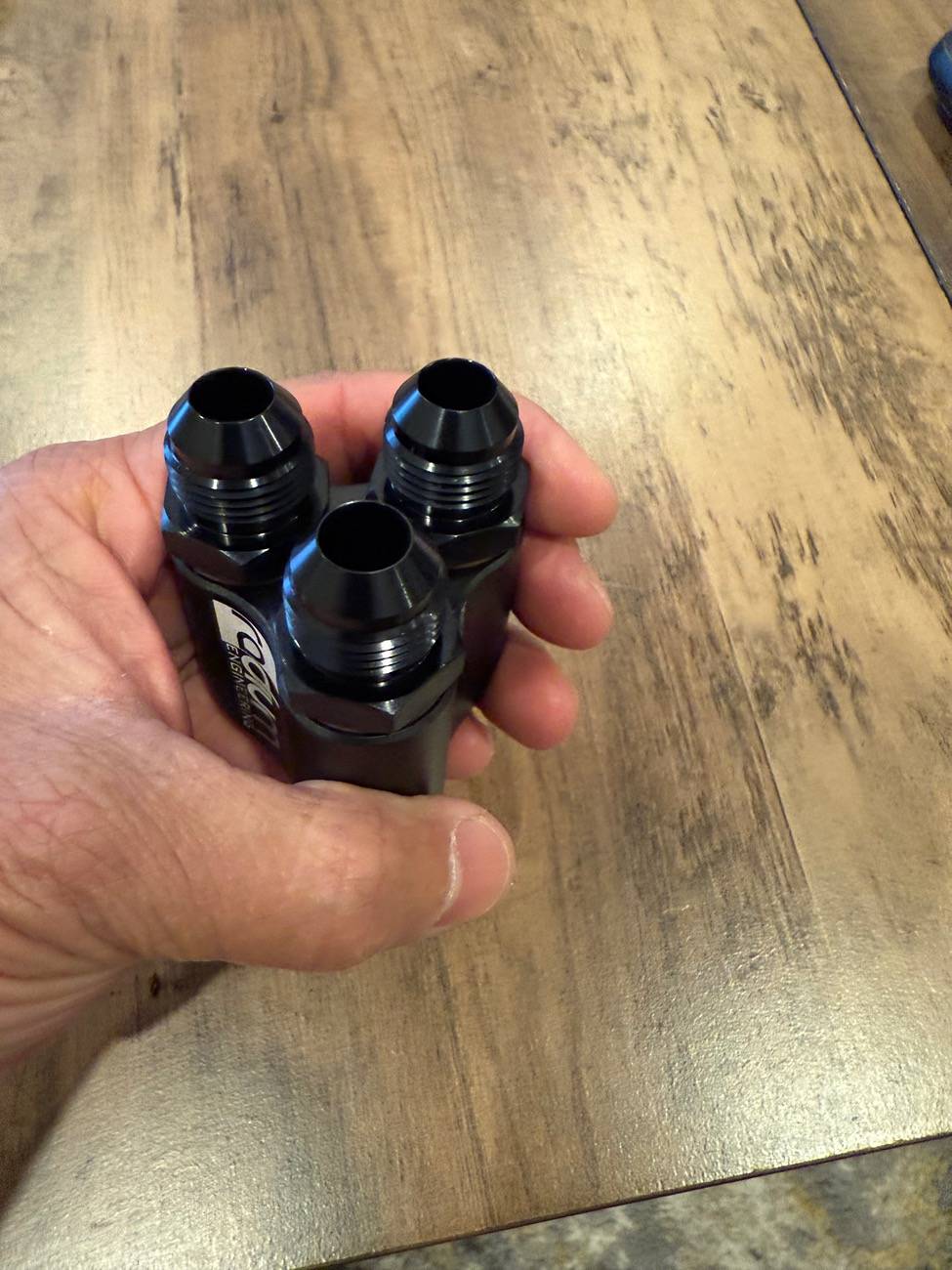

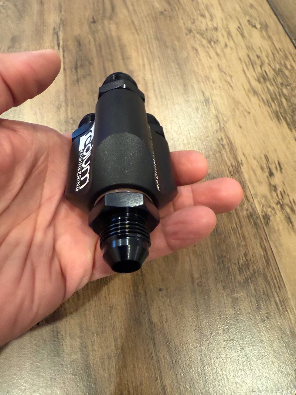

I don’t doubt it at all. I’ll be doing a complete fuel system upgrade using a Deatschwerks X3 fuel system, Radium 3 port distribution block, Holley rails, Fore Di tee and lots of fittings.

If I had to do it all over again, the only thing I would be considering is either a DW810 inside the OEM bucket, (obviously requires tuning that most don't have access to, and some electrical and custom plumbing work that some may not feel comfortable doing) or one of the KPM systems.
The DW X3 or radium bucket is better than an open hanger, but not by much. The only people who have truly figured out a proper venturi and bucket fill strategy are OEM and KPM.
Whats wrong with the radium bucket that its not much better than an open hanger?
engineermike
Jul 15, 2018
6,306
6,635
La
2018 GTPP A10
The radium bucket doesn’t “pump” fuel into the bucket from outside the bucket. It relies on gravity to push fuel past the mushroom valves and it can’t keep up at low fuel levels and high flow rates. The dw bucket has the same design flaw.
Stock and KPM don’t have this issue.
