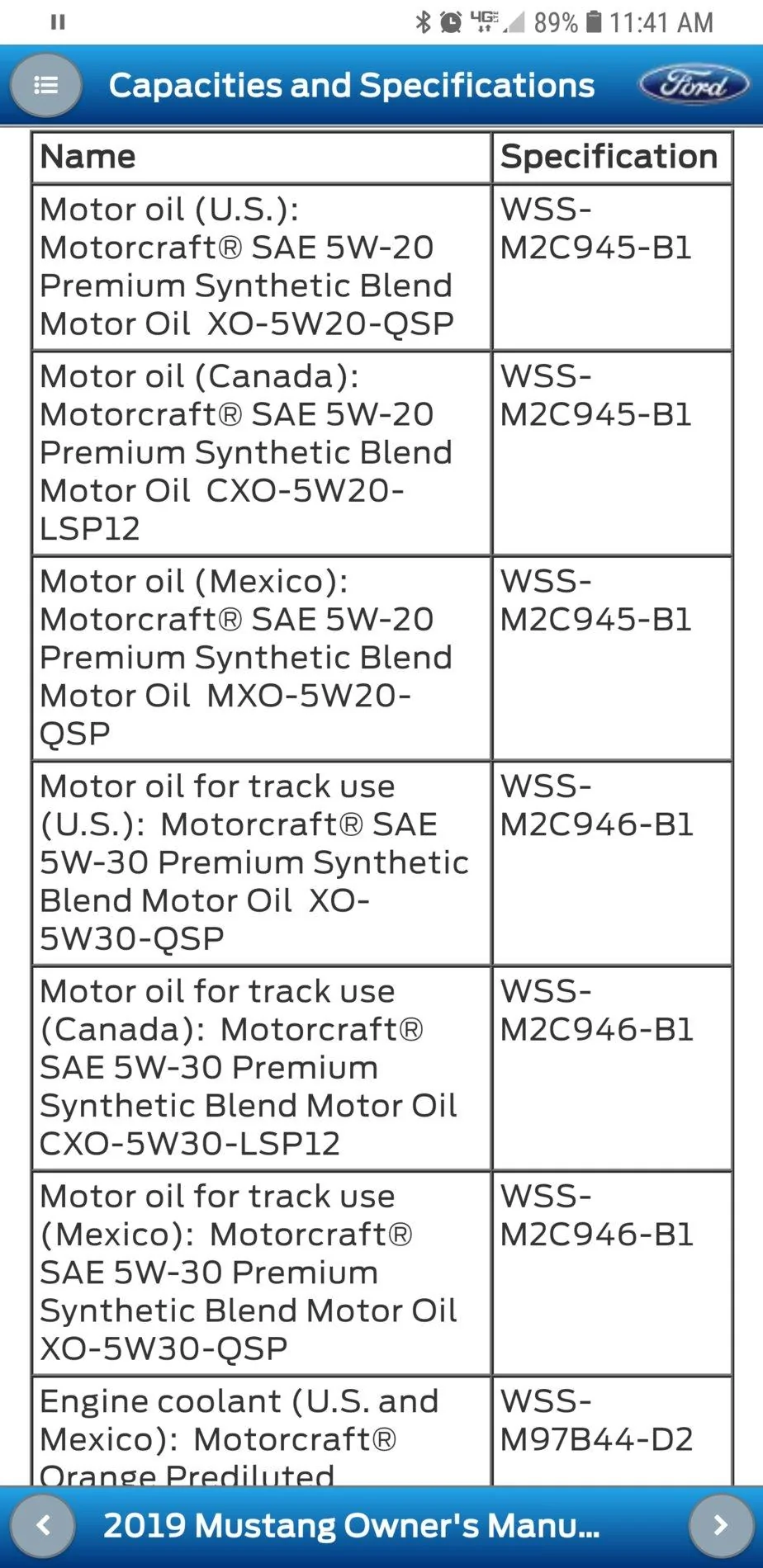

Sure it’s in the owner’s manual, but it’s not listed as being the oil to use for DAILY use. Whether there’s any detrimental effects from running that viscosity daily, I have no clue. So I’d say use it at your own discretion and don’t take YT vids as gospel....
Cobra Jet, I think those are the specs for the Ecoboost. Scroll down a few pages for the GT caps and specs. My manual is showing Motorcraft® SAE 5W-20 Premium Synthetic Blend for daily use in the GT and Motorcraft® SAE 5W-30 Premium Synthetic Blend for track use.
Agreed. I just looked.
2019 gt oil specs
I stand corrected fellas - you are 100% correct! I had the online pdf opened and was scrolling back and forth when I captured the initial image... and didn’t even realize I went up a few pages too many.
So to clarify:
The 2019 Owners Manual for the 5.0 does NOT list 5w50 for any type of use.
Sorry for any confusion.
Still not sure where the “Ford says” is coming from though...........
So to clarify:

I also just checked the online 2019 Ford Mustang Owners Manual. There are (2) pages of oil viscosities listed. As can be seen by the snipped image below from page 299, 5w50 IS an oil listed, but is noted for “Track Use”.
See image and where I highlighted.
So is this just another “click bait You Tube make-some-money” vid that was posted to get everyone thinking there is some directive from Ford????
Unless an official doc comes directly from Ford....
if i am correct that is the CAPACITIES AND SPECIFICATIONS - 2.3L ECOBOOST the next section shows the 5.0 it says 5/20 or 5/30 for track use
